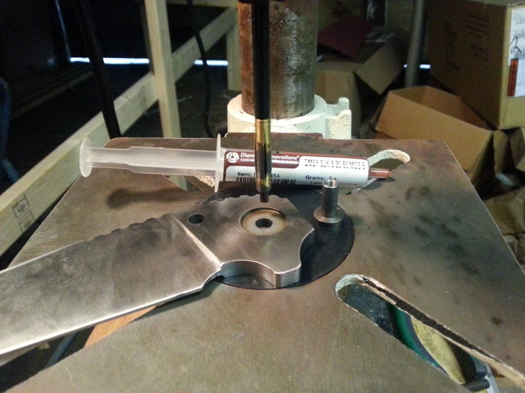

Doing my best gentlemen. These are coming along better than I ever could have hoped for. Right now I'm running the brushed finish handles under my scotch brite wheel and later tonight I will be adding 600 grit diamond lapping paste to the pivots and blades for a perfect fit. Your patience will be rewarded I promise you.

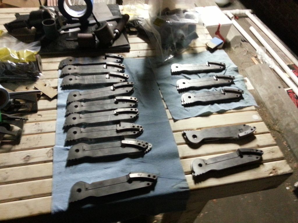

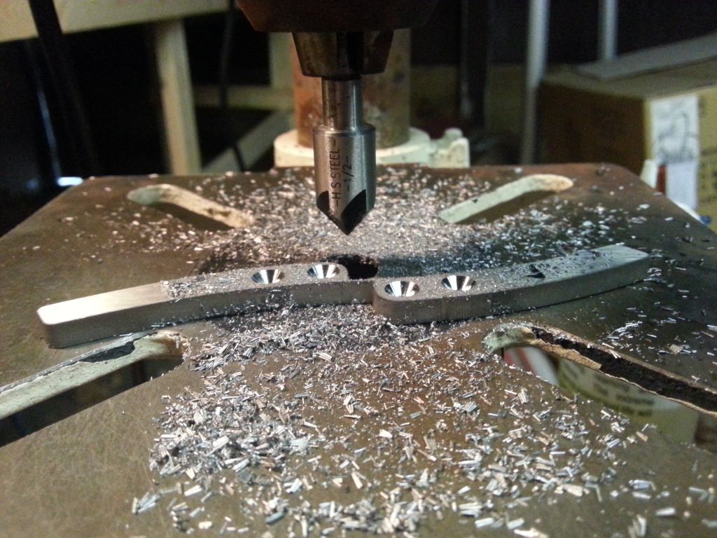

OK so just finished tapping 57 holes. Took me 5hrs and broke 3 more taps but it went reasonably smoothly compared to last time. Once I re-reamed the holes a size larger it went like butter. The pivots have all be barrel lapped with a 600grit diamond paste and they fit the pivots perfectly. All holes are counter sunk to 82 degrees and half of the pocket clips have been ground out on my 2" drum.
Tomorrow I am going to finish up the pocket clips, fix the last three holes that have broken taps in them, and start cutting the lock faces to match handles with blades. So its really just final assembly and fit and finish at this point. It's coming together gentlemen!

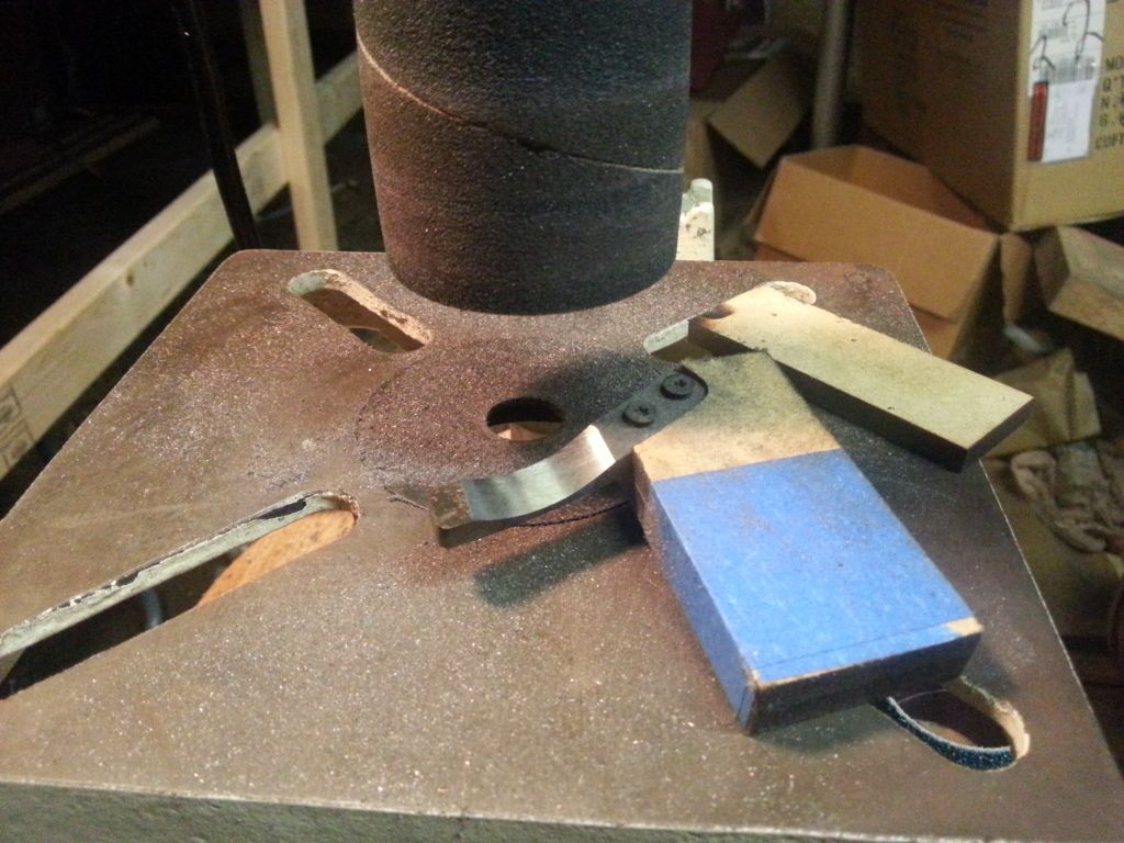

Just a quick bench shot of the fitted pocket clips. Tomorrow I will hit them quickly with the Scotch-Brite wheel and they will be done. Next up is lock face fitting! I'll be sure to shoot video of the flipping action!
