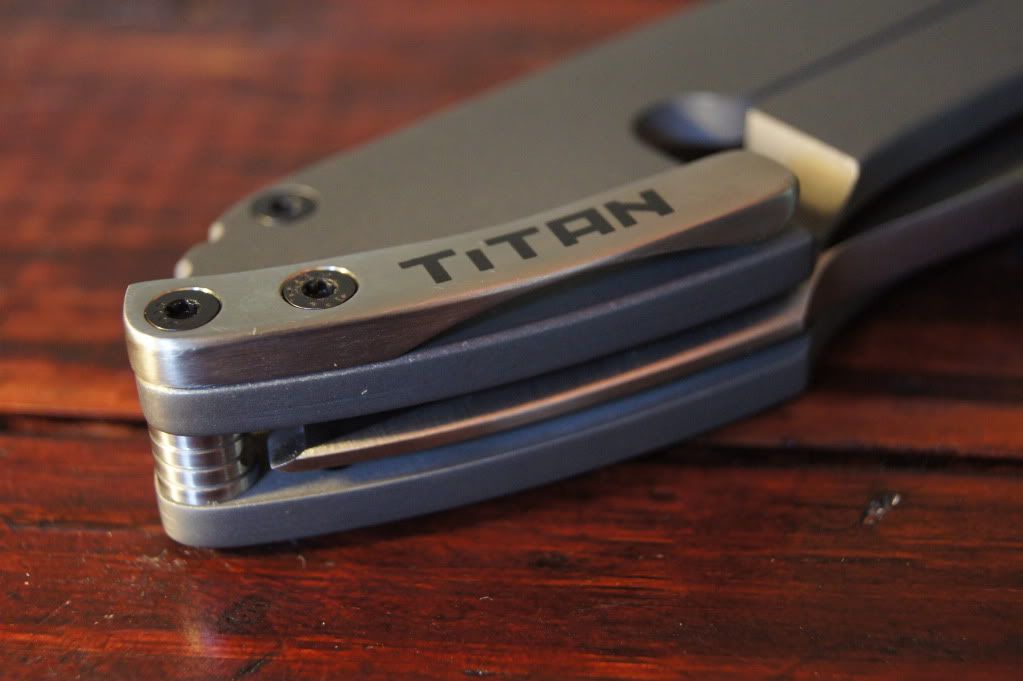

I have one critique/suggestion to fix some potential problems with this knife...add a lock-bar stabilizer. Whether it is licensed from Hinderer or your own design.
The reason for this is 2-fold. First, because the lock-bar is so long it lends itself to being overextended when unlocking. It is like any lever, the longer it becomes the more it will flex. Take a 2x4 that is 6 inches long in your hands and try to bend it, probably not happening. Now take a 2x4 and make it 12ft long and stand at one end and you can probably bend it substantially, thats what I mean.
Second, when the blade is closed and the stop pin resting on the lockbar, if I squeeze on the closed knife, the lockbar flexes downward which causes the blade to contact the second standoff, not the one at the tip of the blade, but the standoff right at the belly of the blade. With a lock-bar stabilizer like on a Hinderer knife, it prevents both of those issues; overextending the lock-bar outward, and squeezing the lock-bar downward.

I have noticed the lock-bar flex as well. I have taken steps to insure that the blade won't touch the standoffs on closing the knife with channels machined into the standoffs but you CAN squeeze it firmly when its closed and force contact between the blade and blade and standoff. A stabilizer is an excellent idea that I plan on integrating into TiTAN 2.0. My goal is to deliver the best knife I can make and over time as I progress as a maker and my skills increase I will integrate design changes and features to make these knives the best they can be. Hinderer is a great example. Rick has been making the xm-18 for a decade and is on his 4th generation of that design. I can only hope to have a fraction of the success and talent that he has developed over his career.

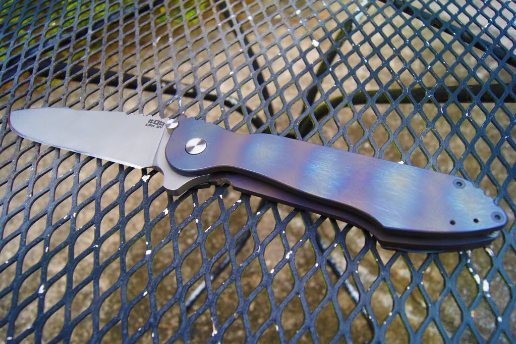

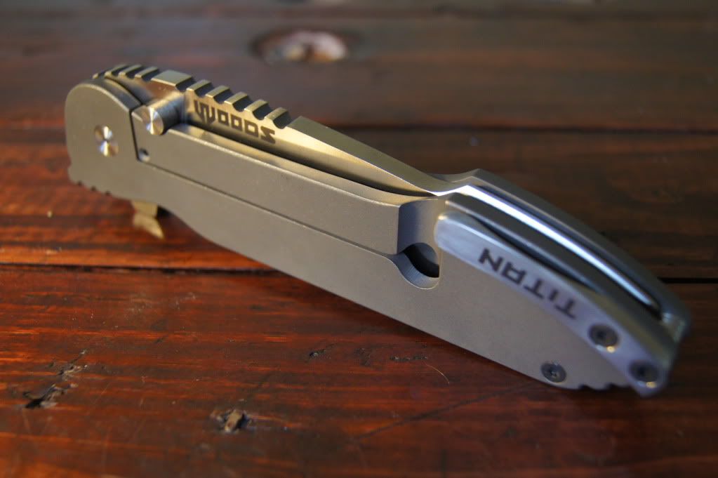

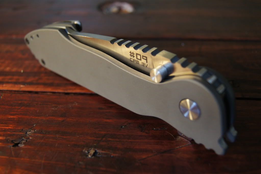

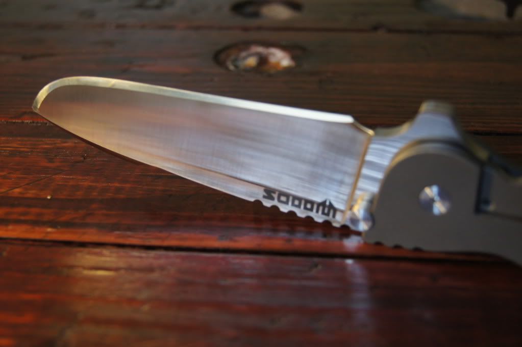

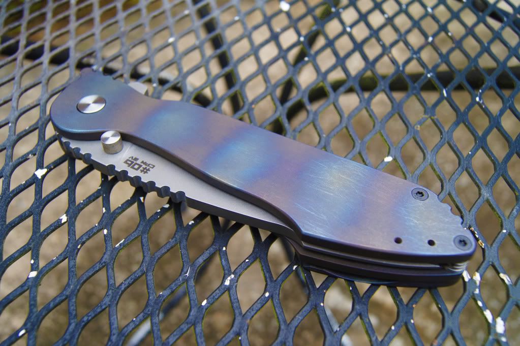

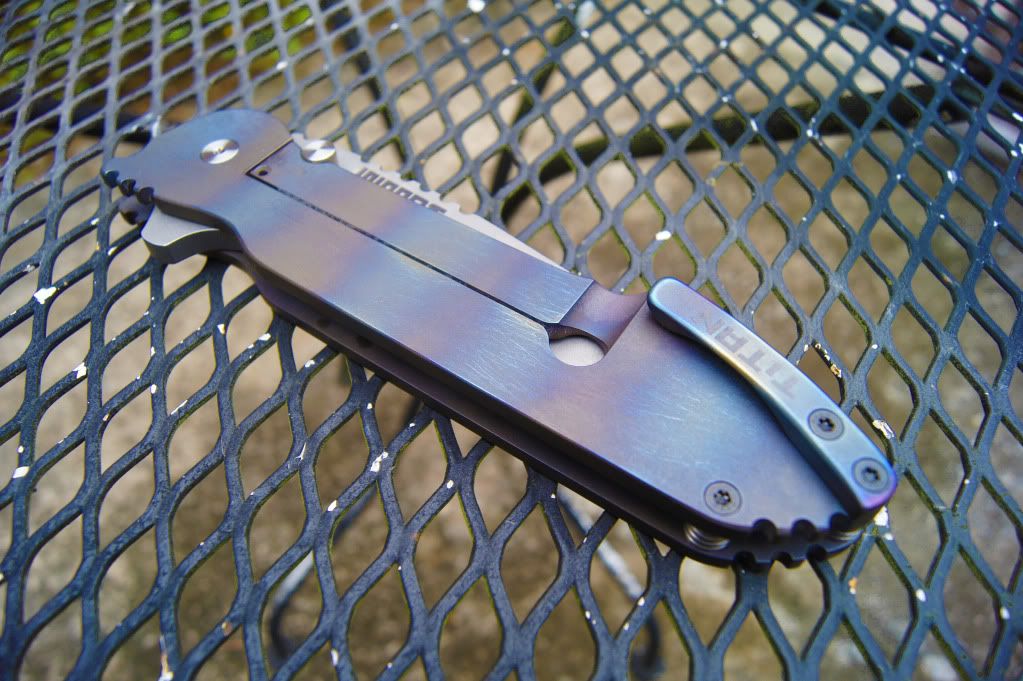

Well #6 and #9 would have gone out this morning if it wasn't a damn government holiday. Post office was closed... funny how everybody else works on Columbus day. Oh well they go out in the morning so you guys will have them this week one way or the other. Here are some pictures to satisfy your blood lust. I'm still working on #11-15, progress is being made and they will ship ASAP.
Took #6 outside so the light would make the flame anodization pop but it was overcast. Still looks fantastic but on a bright day each and every scratch from the stonewashing shows up as a spectrum of color.
#9 is a real classy combo of brushed, stoned, and blasted. Especially love the brushed clip on the stonewashed lock-side slab.
