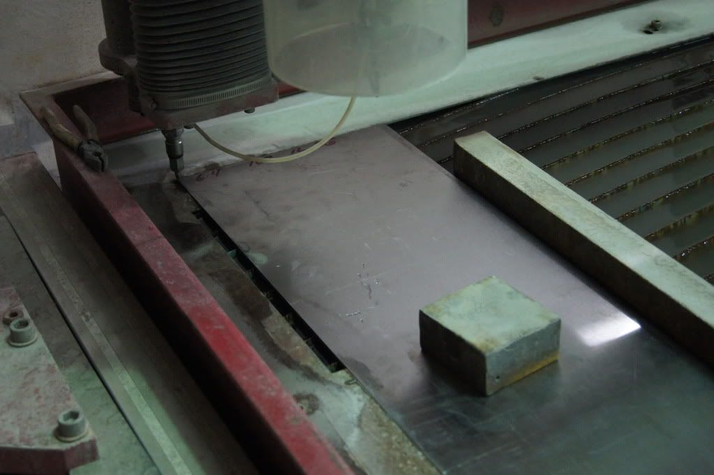

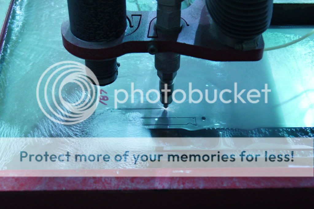

Just got back from the water jet facility with 15 beautiful blades and matching sets of Ti slabs. These are going to be fantastic looking!
[video=youtube;Tng8sH8o9lc]http://www.youtube.com/watch?v=Tng8sH8o9lc[/video]
[video=youtube;XD8d-fkf7sM]http://www.youtube.com/watch?v=XD8d-fkf7sM&feature=plcp[/video]
