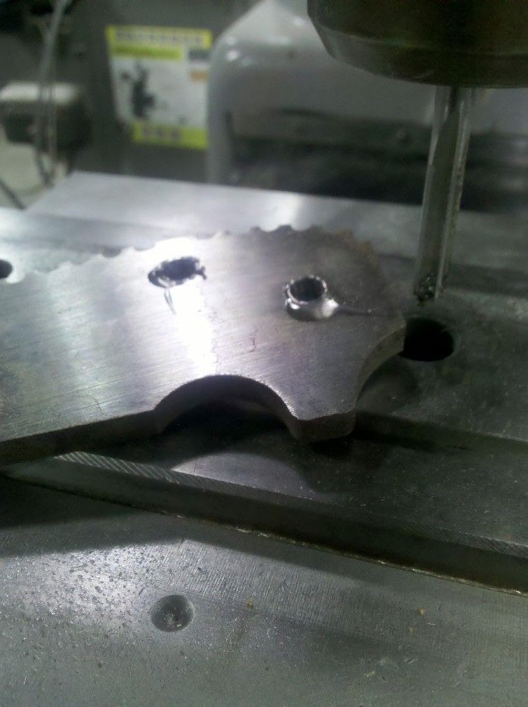

All the blanks have been surface ground with 36 grit Norton Blaze belts. Next I have reamed the thumbstud and pivot holes with a .2490 undersize reamer (I will step that up to .2495 on the pivot based on fit). I have also finished milling a 60 thousandths deep 11/16th wide pocket for the roller bearing to slip into on all 15 blades. I'll take a group shot of the blade blanks and the bearing cutouts later.

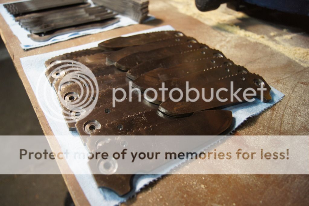

OK gentlemen so before I head out to BLADE here is my progress. All 15 blades have been surface ground to .26" (I will take it to true .25" with successively higher grits) and the bearing pockets have been milled to 60 thousandths on each side. The Ti slabs have had all thier milling done as well. Lockbars have been cut with a .50" ball mill to leave 55 thousandths of material. They feel SO MUCH better than the prototype. Easy to manipulate yet strong as an ox. The pivot pockets have been cut and all holes reamed undersize to allow for hand lapped finish.
When I get back from BLADE on Sunday I will begin grinding out the profiles and then I can send them off to Paul at Buck for heat treating. After talking with Paul this week we have decided on a target hardness of RC61-60.
