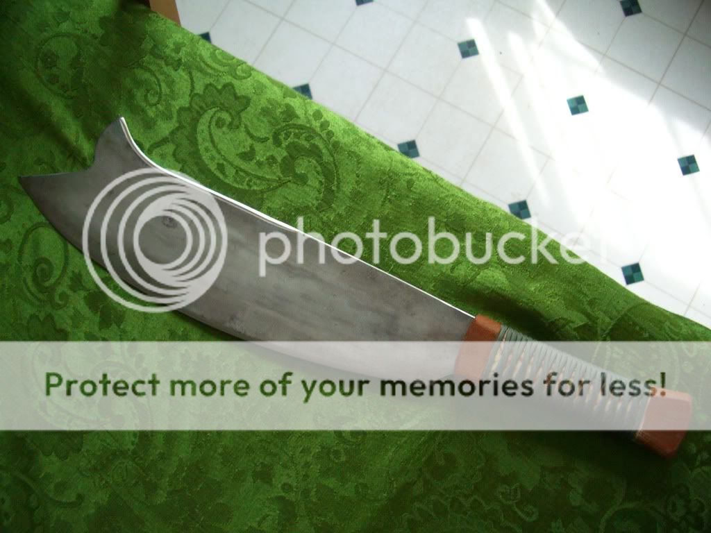

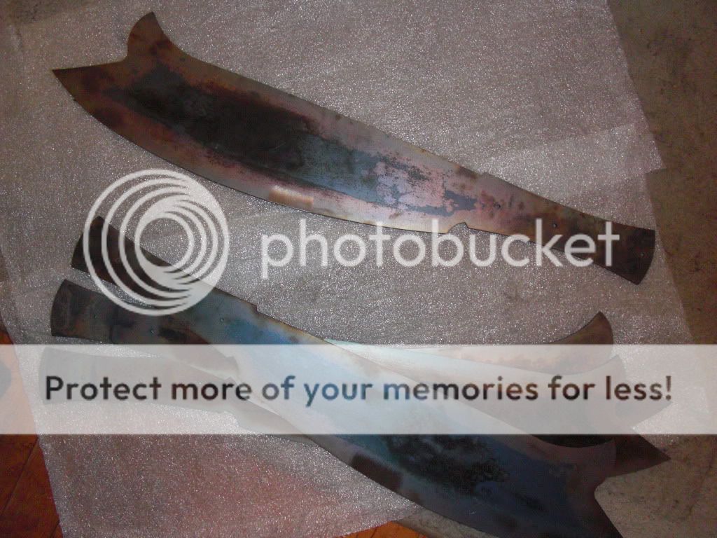

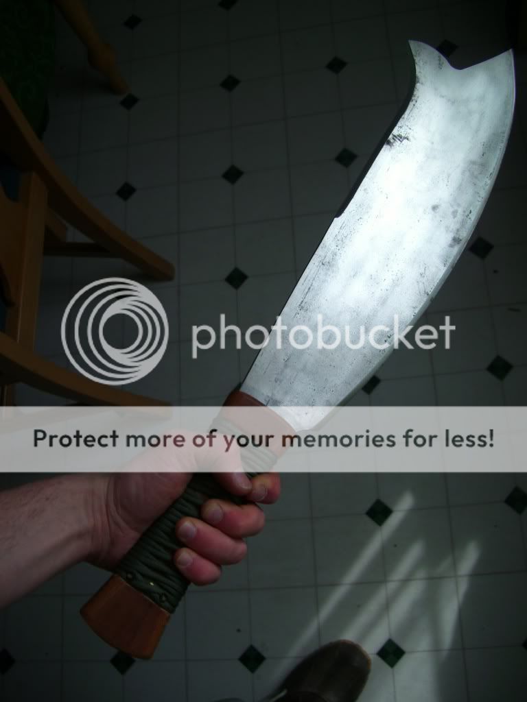

It was primarily influenced by my experiences with the Bush Knife (which I LOVE) and wanting something longer with the hook as a secondary. Also as an improvement to the tasks the Woodman's Pal tries to handle. These pieces are a little thick (1/8", rather than the 2mm I'd prefer) so they'll be great for folks who love massive heavy blades. Even without a handle or an edge it'll blast deep gouges into wood.
Two of the blanks have already found homes, but the other two are on their way to Darrin Sanders for scales and edges. One will be mine personally, but the other will be up for grabs. It's called the Baryonyx (which means "heavy claw") and actually served as the inspiration for the name of my store.
The spine forward of the hook can be grasped for draw-knifing or batoning, the point of the hook can be used as a pick, and the open shape of the hook makes cutting grasses and brambles and snedding easy without sacrificing the advantage of a forward curve. When held with the hook forward the balance shifts so it's faster in the hand, which is good for when you need tip velocity for light targets, and the sweet spot of the primary edge is HUGE. The cusp between the two points can be used to push branches and the like out of the way. There are a few other tricks up its sleeve as well, but I'll do a thread on it when I get them back. :)
You may now return to your regularly scheduled programming. :D:D:D

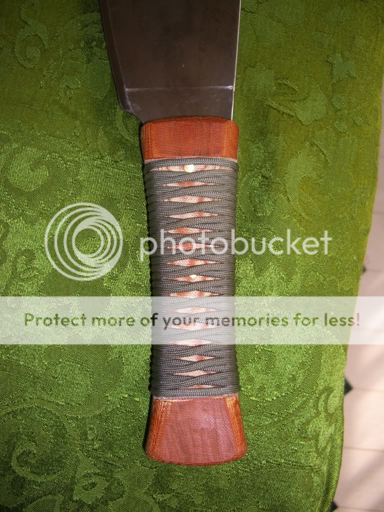

I completed ONE for a friend of mine to help recoup the cost of getting the blanks done up--it took me forever and was a pain in the butt with my limited experience/tools which is why I'm farming out the handle-fitting and rough grinding on them.
Very robust looking blade, I like! Is it an original design? It almost looks like some kind of medieval European harvesting tool/weapon.
It's a piece of my own design, yes. About a year and a half in development, plus more to bring it to life. It's partially inspired by a "block" pattern billhook, so European in influence, yes. :D
