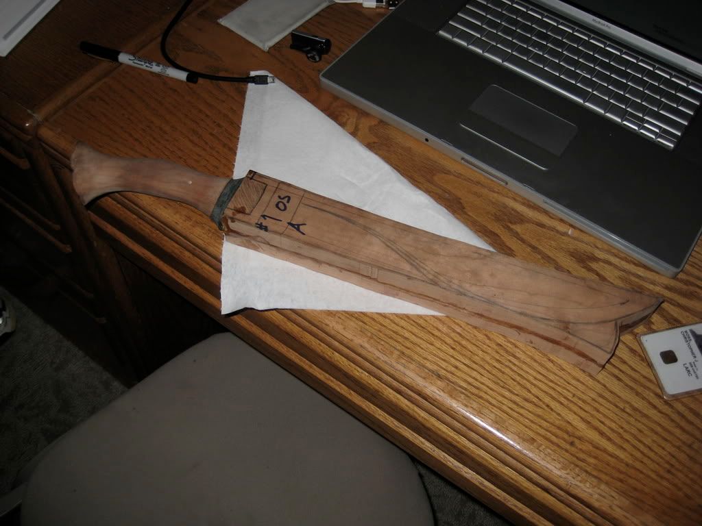

hey yall,
not had much time over finals week (physics and drafting finals today *freaking out*) however, i do have the handle sanded smooth, the pin in, and the carving drawn on.
let me know what you think!
thanks so much!
~Chris
