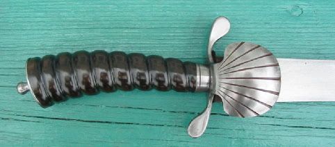

Hello Everyone,
Sorry I haven't been on the forums much for a while. I've been busy lately purchasing my first home and getting my shop all moved in and set up. I had to run all new wiring in the shop, hang drywall and get everything moved in and set up. Tell and me again, why does my surface grinder weigh 2,500 pounds? :P With the help of my family I was able to get the shop fixed up, set up and operational.
In this thread I will be sharing the progress of the first knife I'm making in my new shop. It's going to be a hanger bowie with lots of clam shell themed pieces. The blade will be West Texas Wind pattern and the fittings will be stainless steel with some of my own engraving. The handle will be amber Sambar Stag with some 14k gold pins. The knife is for a fellow forum member who many of you know. Before I go any further I would like to thank this collector for giving my the opportunity to make this knife and for helping me do what I love for a living. Without you guys out there supporting me I couldn't do something I love doing, every day, all day long.
The idea for the hanger guard came from the collector. We've corresponded quite a bit through e-mail working out all the fine details that this knife will have. The finished drawing we came up with and the plan for this knife I believe will look really, really nice when it's all done. This will be my first hanger guard I've made.
I'll be posting pictures in large batches every few days or until I've taken about 50 new pics to post. I hope you all enjoy and fell free to ask if you have any questions about anything or if there is anything extra special you would like a shot of in my shop or on the knife.

Here is the finished sketch of the knife I'll be making.
095 by Kyle Royer, on Flickr
096 by Kyle Royer, on Flickr
097 by Kyle Royer, on Flickr

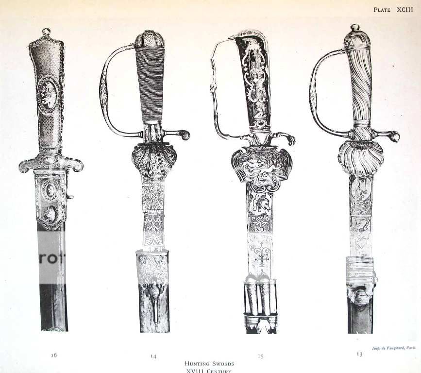

Okay..so there's a few things I can be ignorant about and the " Hanger Bowie" term is one of them...so can someone fill in the blanks as to origin and purpose or as much as one knows........I Google the term and only see images of David Bowie and bowie knives....
And congrats on the first house................
Hello Boggs.
"Hangers" were most commonly used on European Short Hunting Swords as methods for 'hanging' their swords on objects and for addition hand protection.
They also tended to be very decorative additions to the gentleman's sword as these weapons were status symbols in the day. Hangers appeared on some larger Bowies more as decorative/design elements. You can find examples in some of the antique bowie books.
