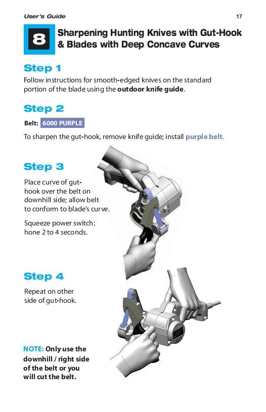

Dont mean to revive the thread either but I was wondering how well it would sharpen a recurve blade. And if it's possible to convex a recurve edge with this sharpener. Again, sorry for reviving it.

It really depends on how recurve the blade is -
for a very gentle recurve then the sharpening is actually like any straight edged knife -
if it is strongly recurved - then there are instructions specifically for guthooks and strongly recurved blades -
from page 17 of the manual -
The whole pdf manual can be downloaded from the WSKTS web site -
Work Sharp Sportsmans Knife and Tool Sharpener User Guide
Actually the narrower belt of this original WSKTS can be more flexible for different curved blades as the narrow belts would conform better to curves -
