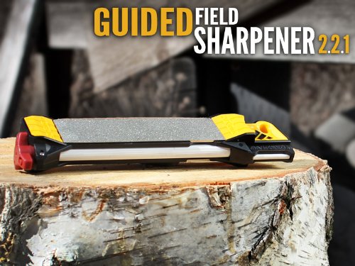

(As Work Sharp is a sponsoring Dealer, I believe these Official images are okay?)
This looks promising to me, particularly the simple addition of the angle wedge at each end of the sharpening surface(s).
This newbie is all for constantly checking the developing knife edge for feedback on where the steel is hitting the sharpener, burr formation, etc., but re-gaining the exact same angle upon recommencing remains a challenge.
The other features look promising, too, if obviously sized down for portability.
Thoughts?
~ P.
If it works half as good as it looks, they won't be able to keep them in stock.
That looks like a real winner!
Very interesting.
Looks like an extremely helpful tool for folks who may need help keeping a consistent angle.
In my opinion, an edge angle does not have to be perfectly uniform to be sharp.
I would be a little concerned about contamination on the strop, however. Setting it on the ground, a fallen tree, etc. could be damaging to the strop and in turn, the edge you wish to refine.
The concept looks pretty good, as an all-in-one tool. The one downside (possibly) I see is, the angle guides are fixed at 20°/side only. For some users (maybe most non-knifenuts ;)), that may not be an issue at all. Others might want for something less than 20°/side, such as down to 15°/side. It would've been a nice touch to see 2-position (15/20) adjustability in the angle guides, but perhaps that might be integrated into a future version. ;)
Cleaning the ceramic I don't think would be a big problem, as I see it. Some Barkeepers Friend & water, plus a Scotch-Brite pad could be used to clean it in place. Or, if it's not quite filthy, even Comet/Ajax & water, or dish soap & water would also work, as with any ceramics (dish soap & water is actually what Work Sharp recommends, after looking at the online maintenance instructions).
I sort of wish the strop were removable from the unit, or even absent entirely. I'd actually prefer a separate strop; more likely I'd just use my belt. That would facilitate cleaning the whole thing more easily, without possibly contaminating the leather, as mentioned previously. It almost appears the leather is 'rough side up', from what I can see in the video. Some users might wish for a smoother strop. I think in this case, it looks as if they included it just for the most basic of use, for scrubbing away light burrs and such. If it were being used to mirror-polish a highly-refined bevel, I'd be more concerned about contamination, but don't think it would matter much for the edge finish created on this tool (assuming the leather's not completely filthy). Compare to basic stropping on the inside on one's leather belt, which I'm sure isn't all that clean either, in terms of particulates (dirt/dust, etc).
Could be? Or perhaps interchangeable angle guides. Currently, there are 20° and 25° angles provided, one set on each side (the diamond plates are removable, so you can switch out the coarse and fine grits to use with either angle). 15° and 20° would be nice!
Yes, the strop looks the most gimmicky aspect to me as well. Maybe they figure it's better than nothing...?

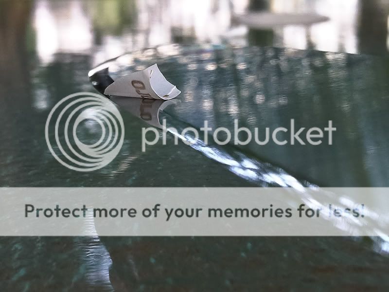

BTW, P, here are a couple shots of one of those pesky wide bevels :)
A little closer
I hope to hear how you make out either way you move forward.
