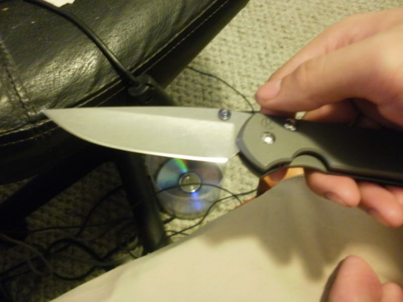

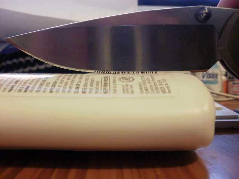

As strange as it may sound, I feel the Work Sharp is quite gifted in making a beautiful edge, with such a short learning curve that after using it for all of 2 weeks, I already feel confident enough to do THIS:
How did you do that?
I bought a whole set of Micro-Mesh MX belts and used the ones from 150MX-1200MX(9 belts total). So long as the jump between belts is as small as possible, it'll turn out to be a perfect mirror finish even when ending at only about 2 microns.
