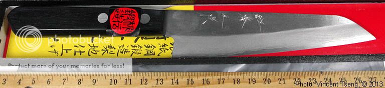

here's one of my favorite knives:
and the edge that the WSKTS KO edition put on it -

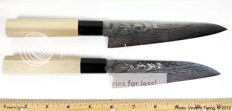

First knife I sharpened on the Blade Grinder Attachment was a RyuSen 180mm vg10 Damascus Gyuto (I believe the Hattori HD-6 is a re-badge of this knife)
this was the knife I hazard to call "too sharp" -
so we know it is seriously sharp.

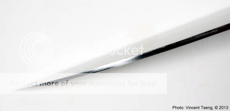

Setting the attachment for 15degs - this was the result - using a usb microscope at ~110x magnification:
man! look at that edge!
It's really only a micro-bevel - as the RyuSen/Hattori kitchen knives have a very good reputation of being very "sharp" in that the entire blade face is continuously convex and doing the pinch test (pinch blade face and pull to ward the edge) the blade feels like it falls from blade to nothing - I cannot feel a separate bevel and the thickness behind the edge is almost nothing.......
Oh, yes the blade is really really sharp now and it seems to have lost that "too sharp" feel -
I will be using it more now.....
But still is not as nice as the Shigeki Tanaka wa handled vg10 Damacus Santoku I have:
BUT that is due more to the knife and shape rather than the sharpening or edge. (it's just my personal preference) in terms of cutting they perform about that same.
Pinch test on this Tanaka Santoku which also has a continuously convex blade face - is again like that of the Ryusen - but even more so - possibly due to the wider blade face so when it falls to nothing - it really feels that way - in comparison going back to the Ryusen now does not feel quite the fall to nothing - but it is really a minor and nit-picky difference.

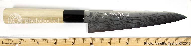

I am somewhat enthusiastic (OK obsessed) about Santokus - especially Japanese ones:
SETO I-5 vg10 Tsuchime (hammered) Damascus Santoku
On a couple of upmarket/premium Japanese vg10 Damascus Santokus had asymmetrical edges in the region of 80/20 or even 90/10 -
I suspect this was possibly more like a one sided edge with a back bevel
These 2 edge shots are not mine - but promo photos on the web:
These are the typical factory edges with distinct bevel shoulders.
I was in trepidation not being experienced working with asymmetrical edges and at acute 15degs....
Had to figure this out myself - if I ground first at 10degs without too much concern about reaching the actual edge - that ought to grind away the hard bevel shoulder and hopefully make it convex to blend in closer to the blade face.
Then for the actual edge set 15degs and hopefully again it would blend in with the initial 10deg grind.....
So much for theory - what are the results?
on the wider bevel:
and the narrow or back bevel:
Pinch test does feel like the bevels blended well without any shoulder now.
Cutting - it is very very sharp will do shallow cuts like paper etc on par the Ryusen Gyuto and Tanaka Santoku -
cutting food, and through things - it does very well - but can't quite match the Ryusen and Tanaka - but then we're are talking about some of the very best knives I have
and it probably has a lot more to do with the actual overall blade geometry rather than the actual edge even if it is convex.
But it is definitely a lot better than out of the box - in fact quite a large improvement - as the microscope photos attest.

Being so pleased with his Santokus I also purchased a vg10 Damascus Petty 150mm.
It is very sharp and cuts through like the dickens -
BUT 150mm is too long for my regular usage -
I figured that 135mm would be much better for me -
from years of using an original (now classic) Chicago Cutlery Walnut 62S - 5" (127mm) utility/boning knife -
and more recently of a 135mm SETO I-8 vg10 Tsuchime/hammered Damascus "mini Santoku" (same series of the SETO Santoku sharpened and described in Post #2 above) -
So I ordered a 135mm length -
life should be so simple......
The order turned out to be a fiasco of the first order (pun intended)
First I was sent the wrong knife (yes, this is still relevant....)
It was in the Silver #3 (stainless) steel 3-layer series, instead of the ordered vg10 Damascus -
Not only was it the wrong knife, it looked like it was very crudely cut to shorten to 135mm.....
I obviously complained and returned it for the correct item - the main point of this was to show how badly shortened the blade was from the original 150mm length -
I thought at first it was the vendor taking a short cut (sorry about the pun!)
but when I finally received the correct item - it was also shortened the same crude way - on inquiry this appears to be the way the maker supplies any shorter length.
Not very satisfactory -
but because I like Tanaka Petty so much, except for the length, and it seems the only way to get the right length for me is to accept this.
>Modification
Finally getting to the point of all this - because the spine/back of the blade was crudely shortened - cut then ground but pretty poorly - I wanted to at least address this.
Started by using a diamond stone to round out the curves on the spine -
although it was working, it was just too slow, and hard work -
Ah-ha! use the blade grinder attachment -
started with trepidation - although I am experienced at sharpening - I am still a virgin at doing any mods on blades......
Started using the X16 grit belt and sure enough I was immediately seeing pleasing results - but it still wasn't reducing the crude cut angles -
so I braved using the coarser X65 belt -
I am pleased to say using my timid and light touch - it was very controllable -
I started grinding with the spine parallel to the belt - this obviously would grind/remove material the fastest for the results I was looking for - rounding the back curve of the spine.
Oh, I did this over quite a period of time - but I'll keep this saga short (yes, another pun)
eventually I realize I would have to be braver if I was going to truly merge the reduction to get a smooth contour on the spine's curve down to the tip.
So being the coward still, I taped the spine further along - then laid the spine so that it was touching along the full length of the back then gradually lifted the blade to follow the contour.
When I finally got the shape I was looking for (days of contemplating later) I then ground with the spine perpendicular to the belt direction, and pressing down a bit harder than my normal timid/light touch -
this allowed the belt's natural character to round the spine's edges/corner more - then processed through X16 and X4 grits.
Result -
the shortened blade at least now looks as if the knife was supposed to be that way...

Result -
there is now a definite curve/belly to the shortened knife.
The edge seems to merge quite well with the existing edge (the bit I did not modify -it's at about the first Kanji character) -
~110x microscope pic of edge at about where the unmod and modification starts -
Of course it's not perfect - not just for an OCD -
the problem with shortening then re-curving this way is that the blade does not thin the same amount toward the edge any more -
to truly get the same profile I would have to ground the whole face to thin the blade the same way toward the edge - which is beyond my skills at this point.
But the first grind at 10deg kind of helps mitigate the need to do this - although I can feel and see this, it is not enough to bother me - for now......
