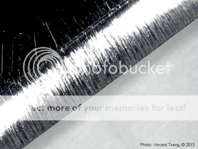

I posted this about sharpening and testing the edge, in my review thread on the
Colt CT813 all Damacus folder
but thought it was relevant here -
these are the usb microscope photos after 7 long cuts through corrugated cardboard against the grain.
Looking at that photo above - I can see that the finish didn't seem to quite reach the very edge.
This is despite me feeling an easily defined burr along the full length of the blade.
So I think there is a difference between when the burr first forms - which is literally just when the grinding/sharpening just reaches the actual edge)
vs. what I am looking for under a microscope - a finish right to the edge.
So since I had used the blade to cut through corrugated cardboard - I sharpened it again -
this time taking the blade to the microscope to make sure the finish was right to the edge -
but dong this the long-winded overly cautious way of making sure I got the finish just when it reaches the edge -
so as not to take off any more steel than I needed to.
Ah! but here's something I learned -
Knowing that it was one side that the finish didn't reach the edge I worked only on that side using the WSKTS Ken Onion Ed
using the coarsest P120 stock belt - single pass raise the burr, then single pass X65 - felt the easy burr - then couple of passes on X22 - same thing easily felt burr - then finally 3 passes on the X4 - with one pass on other side to knock off the burr - then finish with the 6000MM (2µm) belt - still favoring the side I was grinding - examined under usb microscope - - not quite there yet!!!
Repeat the process - this time it looked good under the microscope......
So it ought to be really sharp - right?
Not so fast!
Remember I had a bias on one side which formed the burr that I carried through the process?
It's not that there was still a burr - but the minimal grinding/sharpening on the other side - although knocked off the burr left a crude edge!!
Hence the unsharp results - unable to cut paper cleanly......
so back to the sharpener - this time doing it from the X65 single pass each side - then progressively on the stock belts - but this time even/equal on both sides -
finally gave a much better result and finish
Results under usb microscope -
this was the side where the photos shows the finish didn't quite reach the edge.
opposite side -
One can see the finish/grinding only just reach the very edge - but that is nice and clean - so the knife will cut paper cleanly -
but still not through things that well, because of the poor geometry, presenting a thick profile -
then those opening studs hinder the blade passing through.

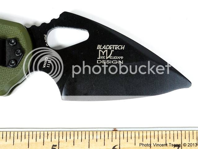

I was sent this knife free and unsolicited from eBay vendor sbc_trading -
he just said :
and I did sent one more knife (5.11 Tactical DRT Folding Knife)to you, but the knife is unsharpen at all, so I think you can just play with it, may be you can sharpen it.
He wasn't kidding -
look at the blade -
There is absolutely no edge bevel
and the point/tip -
there is none!
usb microscope pics -
original tip....
original "edge" or lack of.
Since it was a freebie and there was a "challenge" of sorts -
I took it to this WSKTS Ken Onion Edition -
it was basically a straightforward sharpening proposition except for the rounded tip -
I thought I may have to grind the blade edge on first to shape it.
But thought I'd just try sharpening and grind a little more on the tip.
I used the coarsest supplied belt - P120 grit - set a bevel at the native belt angle when the blade is held vertical -
ought to result in an edge at 20deg/side.
The first few passes the new/forming bevel followed the contour of that rounded tip.
So when the blade only had that part on the belt (ie: toward the end of the stroke)
I held it there longer and could see that shape was pretty quickly being ground away -
and started to look more continuous. In fact being a novice - I had just started to grind too much away -
probably because I held too much of the blade on the belt - so there is a very slight "kink" in the bevel.
Once I got definite burr along the full length of the blade and the tip looked about right -
I progressively walked through the belts all the way to the finest 6000MM (2µm)
So the knife now looks like -
Close up of the blade
and the usb microscope pics (~110x magnification)
new tip
new edge.
Yes, it is sharp - the steel is supposed to be AUS-8 - so ought to be able to support a 20deg/side bevel especially since it is convex (more support) -
as I am a light user of knives - I use more precise cuts.
But what really shocked me was how quick it was to do all this -
by looking at the time-stamp of my photos it was less than 45 minutes for the grinding and sharpening -
from blunt with protruding rounded tip, to sharp knife with convex edge and good tip
