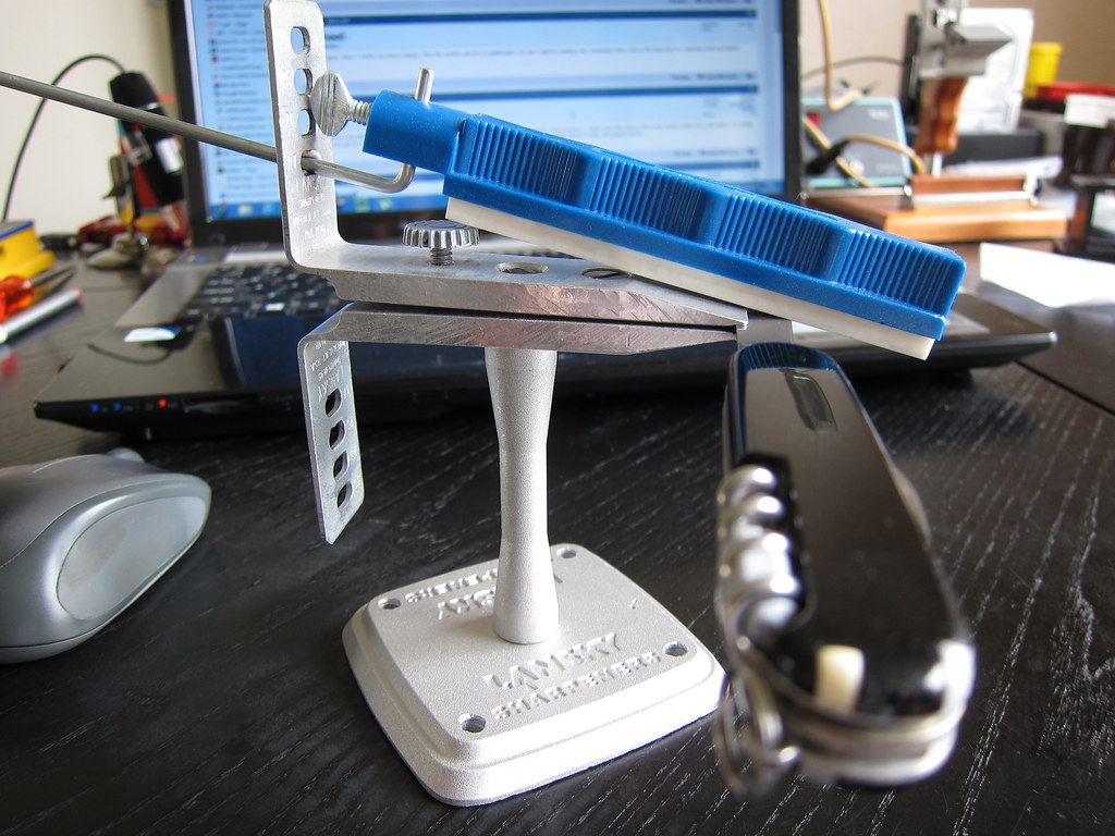

I sharpen my Victorinox knives at the 20 degrees setting which results in an actual angle of +/- 17 degrees
And this is how sharp it than is.
I was using small traditional knives at the time.
