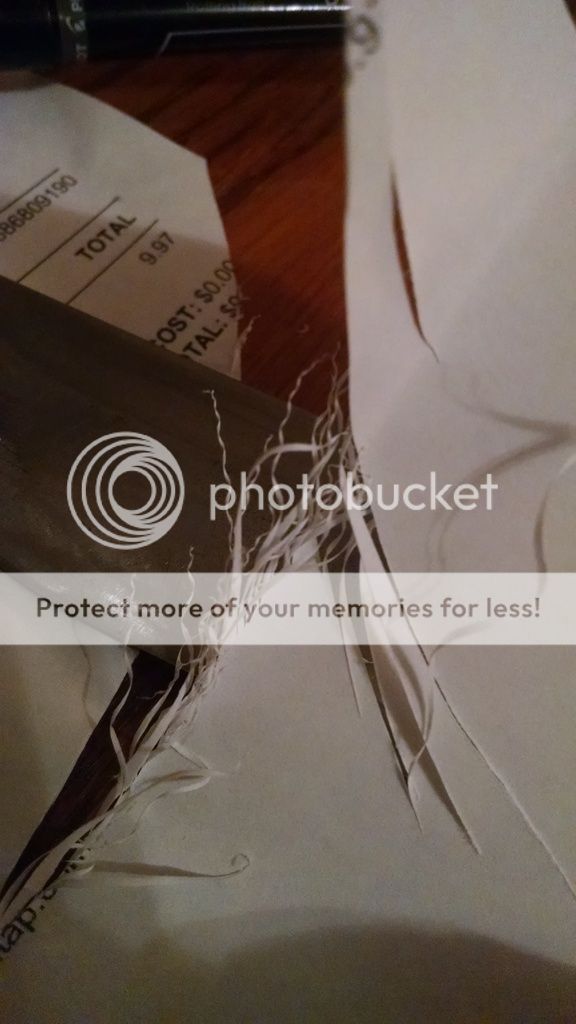

I picked one up today! Sharpened my spyderco lum and para milli, three Henkel kitchen knives, and my ZT pocket knife up paper shaven sharp. I then proceeded to sharpen my Skelly warden up to a razor warden!! The Infi took an edge way easier then any of the other blades. I wasn't able to get my ZT paper shaven sharp, I feel like I wasn't getting the angle right due to the blade profile. I ran it through all the belts twice on 25 and 22 degrees. I will check you tube and see if I can't come up with some more refined technique. Haven't tried any my big blades out yet.
