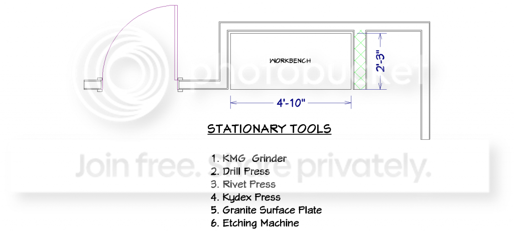

Looking for some input on the best possible layout of stationary tools of where they will be mounted on the workbench i have, the etching machine & the granite surface plate (although it weighing 75lbs, i am not going to want to pull it out repeatedly daily)would probably not have to be stationary. I will most likely build an additional 5' long workbench also. I'm right handed btw if that affects anything.
4'10" for a workbench? I have a 12' long workbench and I still run out of space.
I have 3 six foot workbenches with no power tools mounted just a dremel and several vices and I run out of room.
One for design/leather (no metal shavings or dust), one for finish sanding and one general purpose for messing with crap like epoxy and such.
I currently have 10' of work bench and I have nowhere near enough space and I dont even have a 2x72 yet down there. Just my filing jig, benchtop drill press, 18"x24" granite surface plate, and my glue up and assembly area. I could double it and that would be great until I get a few more things. Your going to have quite a time filingl your 50 knife order in that space. I do 1-2 knives at a time and feel confined.

i'm simply asking what i can put on that ONE workbench, not saying that i am going to put everything on that single one.
Hard to answer that one for you. I have one through six on your list and limited space so only one and two stay out but your granite is much bigger than mine. Best guess though would be the KMG on the left side of the bench and the drill press in the alcove.

Yea my main concern was where to mount the grinder and then i was going to go from there......
Can you pull that bench out a little or make it deeper? Being flush with the wall limits access to tool you put on the left or right corners of the bench.
Where is the vise going?
Leave the bench open. Mount a vise on the left hand corner. Mine extends out from the bench so that I can have it in front of me and the bench is to the right. Peg board and shelves over the bench are nice for storing hand tools and misc consumables. I would keep things like etching machine and granite plate under the bench and bring them up as needed. I work out of my garage, so my grinder is on a rolling stand so that I can go outside to grind when it's nice. Helps keep the dust down and my tired old eyes really like the sunlight versus shop lighting when grinding. The alcove looks like a good space for the drill press.

yes i can pull it out some; how much you think i need 'minimum' to pull it out to mount tools on the corners? 6"? 12"?
I like the thought of putting the grinder on wheels to bring outside as my shop setup is my garage as well and BTW that alcove, is home to my water heater......my thoughts were leaning to what you said about the etching machine and granite plate
You are gonna REALLY, regret (at some point) not getting a grinder that you can tilt to horizontal, which will, of course, require more room to that side on the bench. They're out there why not do it right to start with?
Depends a lot on what you're mounting where and how you work 12" sounds like a big improvement.
I have a small drill press mounted behind my vise. It's a compact arrangement and works ok.
I clamp things down till I'm sure where I want them. Also T-nuts are nice for making it easy to install and remove something.
Wherever you mount your grinder you'll want storage racks for the extra tool arms and legs or some kind of hanger for your belts. Don't forget about ductwork, etc for your dust containment system, especially if that water heater is gas.
Beyond that a good rule of thumb is 3 feet minimum of bench space for each stationary tool.
