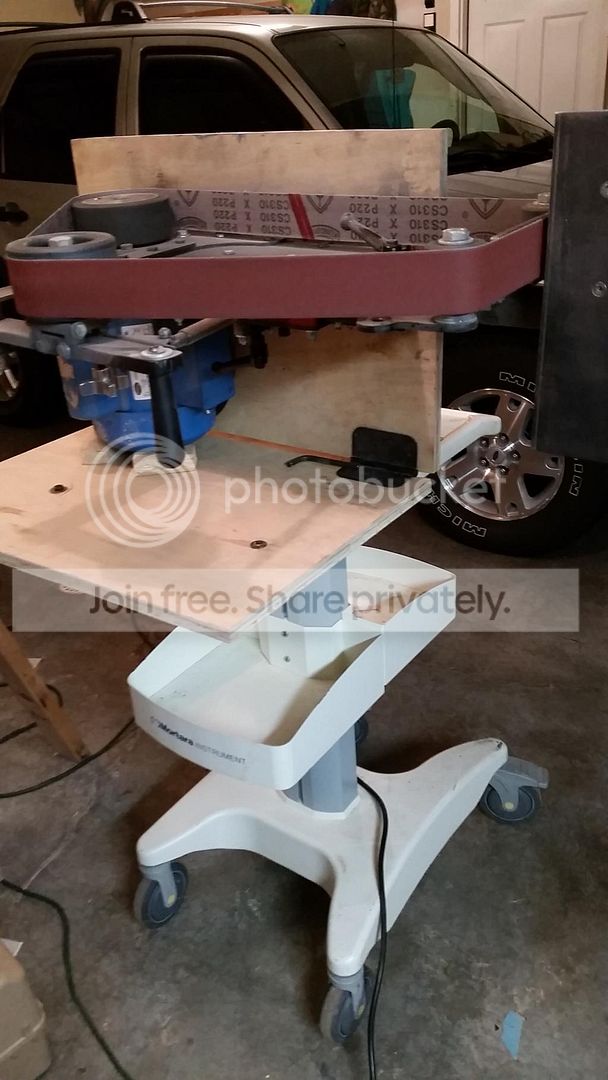

You might consider this for your grinder so you can wheel it outside and grind. That's what I do. Mine is mounted on a old ekg cart my wife got from the clinic she works at...it is stout with locking wheels
