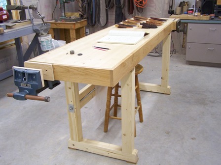

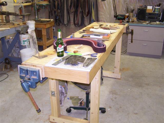

If you build yourself a real, heavy, workbench with the proper vises you'll wonder what kinda shop can function without one.
You don't have to go super expensive. I made mine out of face laminated 2x4's and framed it with Alder. I got the vises from ebay. Its the centerpiece in my shop and I don't know what I'd do without it.
This is what it looked like brand new.
Elephants could make babies on it and it wouldn't budge.

That was when we first moved in. The first project was the bench. This was a few months later. Its dirty as hell now...;)
