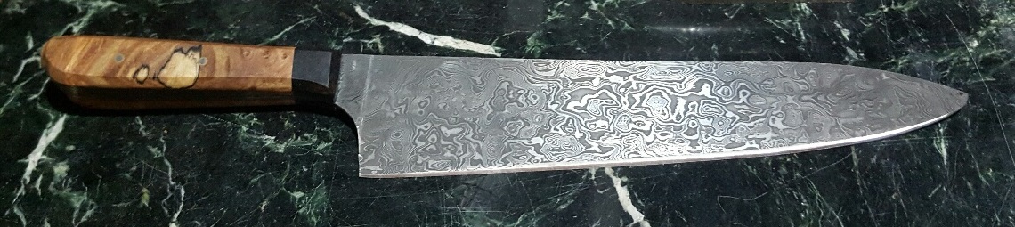

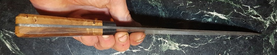

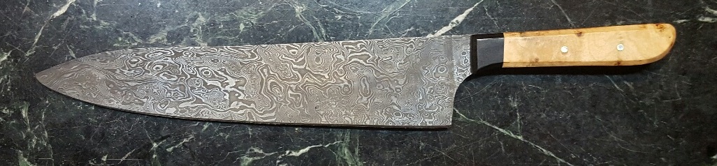

Thanks for all the suggestions, replies and help on this project. Here are pics of the final result, the etching on the tang didn't show up well in the pics. I ended up trying to finish sand the scales off the tang because I had already etched the blade, and then epoxy/pin followed by a quick buff/polish using my dremel polishing wheel and compound. Worked OK.
Damascus pattern was made by grinding random grooves through the original billet. Handle is stabilized maple and ebony with stainless inside brass pins.
