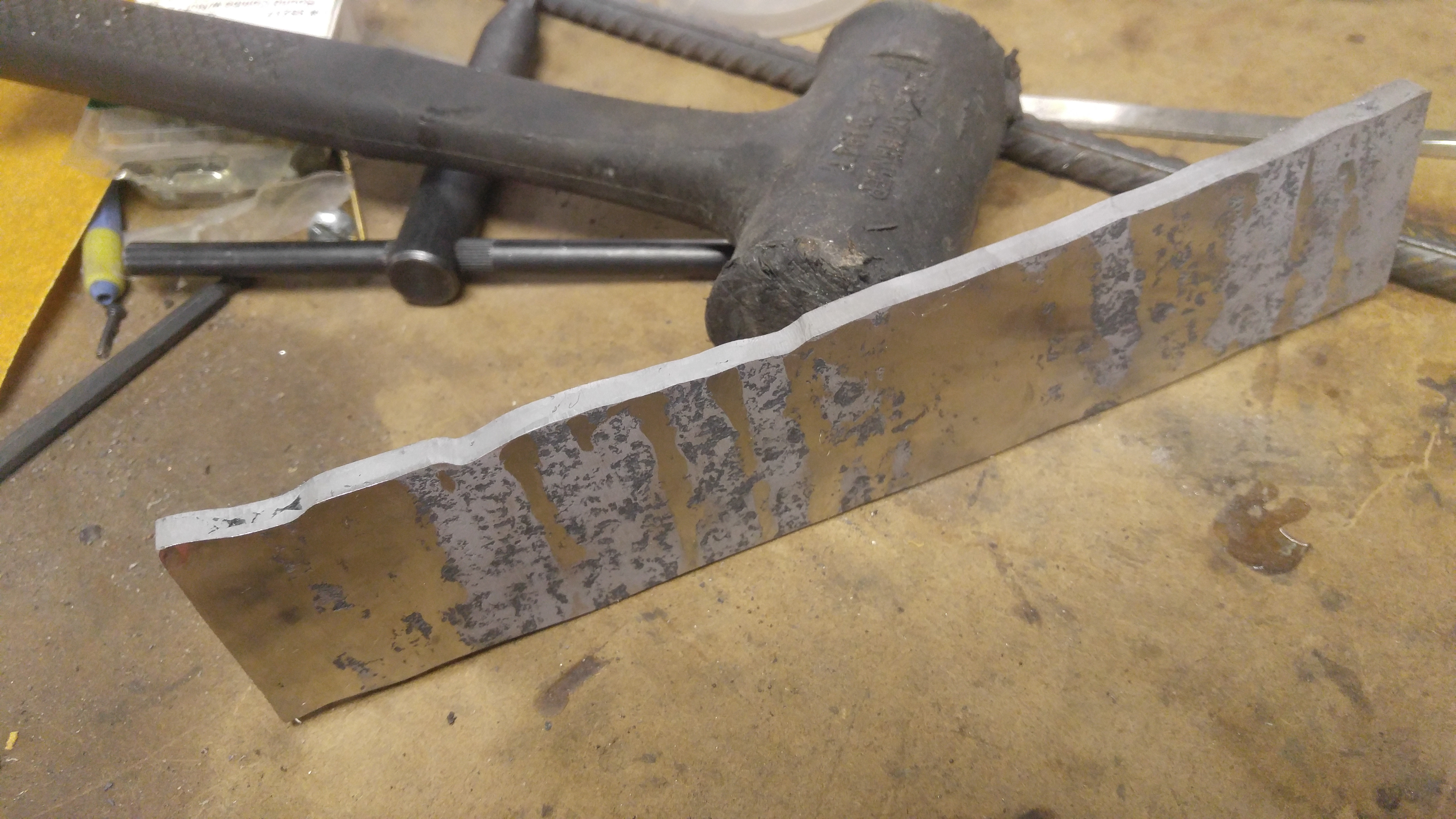

D2 is some other worldly stuff. Seems like its cracking on the edges. Even trying to leave the billet to cool off in the forge.
Got a good forge weld:
But i can't figure out why its still cracking:
It requires me to dig into the billet to remove the cracks:

D2 is VERY picky especaly with forging. You have to remember as it's cooling its hardening and leaving it in the forge to cool down is still WAY to fast to prevent it from hardening. When I anneal D2 it takes a long time in the heat treat oven. I heat to 1600° and hold for 2hrs then cool to 1000° at a rate of 20° per hr. I have tried 40° per hr and it also seams to work but 20 seams to be best. Crucible says 25° MAX per hr cooling. Dropping 600° @ 20°/hr is 30hrs plus the 2hr soak and then the cooling from 1000° which I do by just turning the oven off. When all said and done it's a 2 day process but makes good steel.
But all that said, those cracks look like thy happened from forging ether to hot or to cold. Like CPM3v if it feels at all easy to forge it's to late and you are in the red short range and the steel is coming apart.

i was forging it around the 2K mark. did forge easily enough with my press.
Also I dont have an oven, the forge is all I have. Perhaps if I add more steel to the forge, like heat up 2 huge masses of steel and put the billet in between, they will retain the heat longer?
or should I tap out with the D2 and move to A2? I dont want to quit yet. If I can successfully forge the billet, and CNC it to shape... I could pay someone with an oven to heat treat it.

Gotcha!;) Advice given already sounds right to me. Sounds like it's cooling too quickly. I would try the 20 degrees an hour process. Should end up with a good billet to work with.
You're forging too hot. Red short occurs when the grain boundries melt and the steel crumbles. 2150f is the correct forging temperature. You are probably over 2250f.

O1 can also have red short issues. It's not impossible to forge D2 there is forging info on most D2 heat treat data pages. Forge welding is obove and beyond that. I have forge welded it to other steels but my most exciting day was when I welded it to 316 stainless. I never made a blade out of it but if I attempt it again I will use the oven to heat it to proper temp.

I am going to try one last thing before I tap out. adding more mass. Eithe by way of larger chunks of steel and sandwich.... or perhaps heat up a tray of sand. More mass will retain the heat longer. I dont have the money for an oven, and the D2 is to thick for any stock removal usefulness. Will keep you guys updated.
