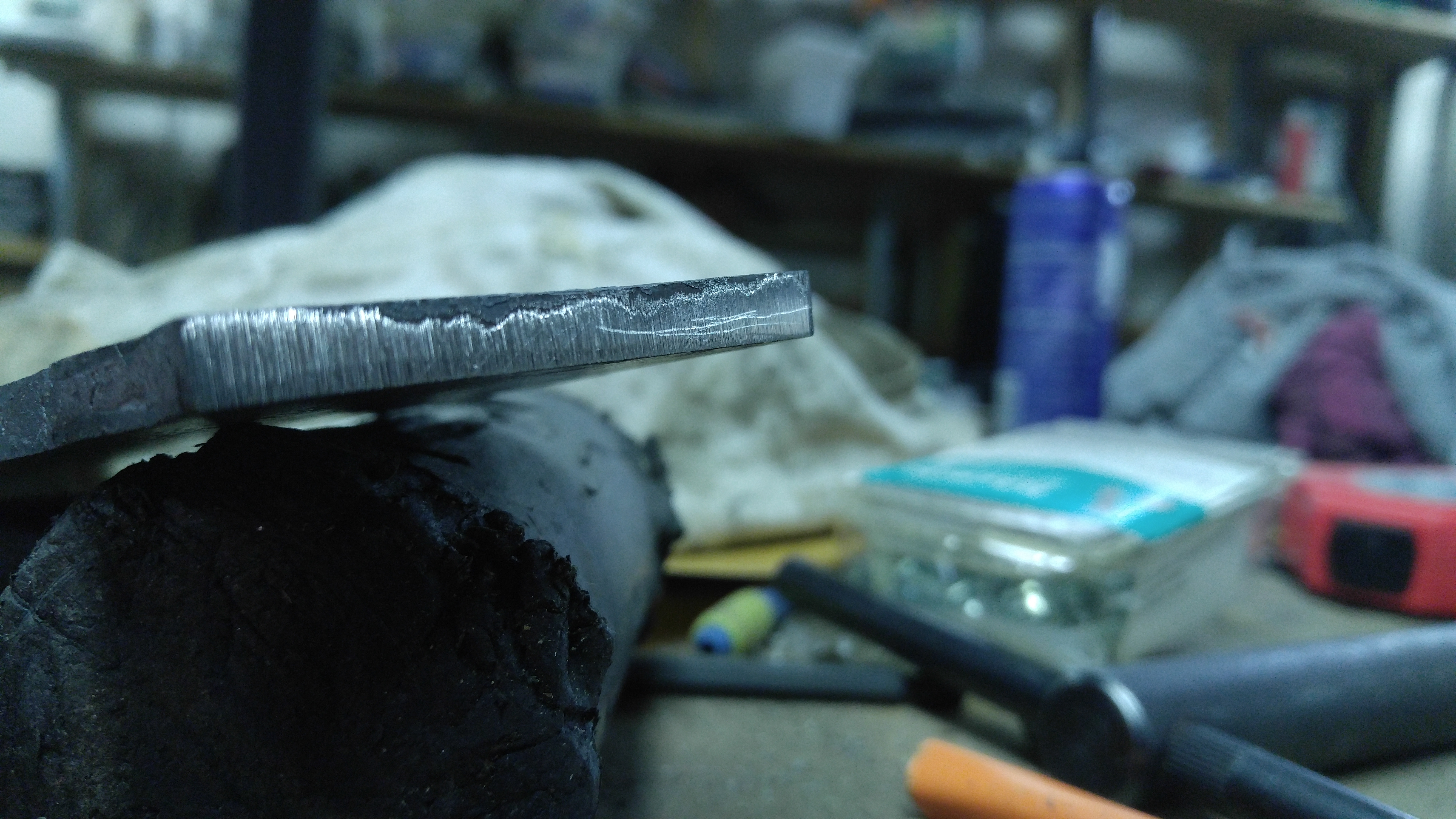

This is the first time I overheated it, and it was my own stupidity. having recently bought a 100 lbs bottle of propane, it really can dump heat into the forge much faster than the 25 pounders. Very fascinating to watch D2 turn into a cold solder. Wonder why the O1 wasn't as affected.
Can you tell me more about the vermiculite?
I may not give it up quite yet. The extra mass in the forge was enough to soften it up.
This is the original billet scratching the center D2 with a 65 HRC file.
Went to check the other files of the test set, and a 50 HRC file skates, but a 55 still scratches it.

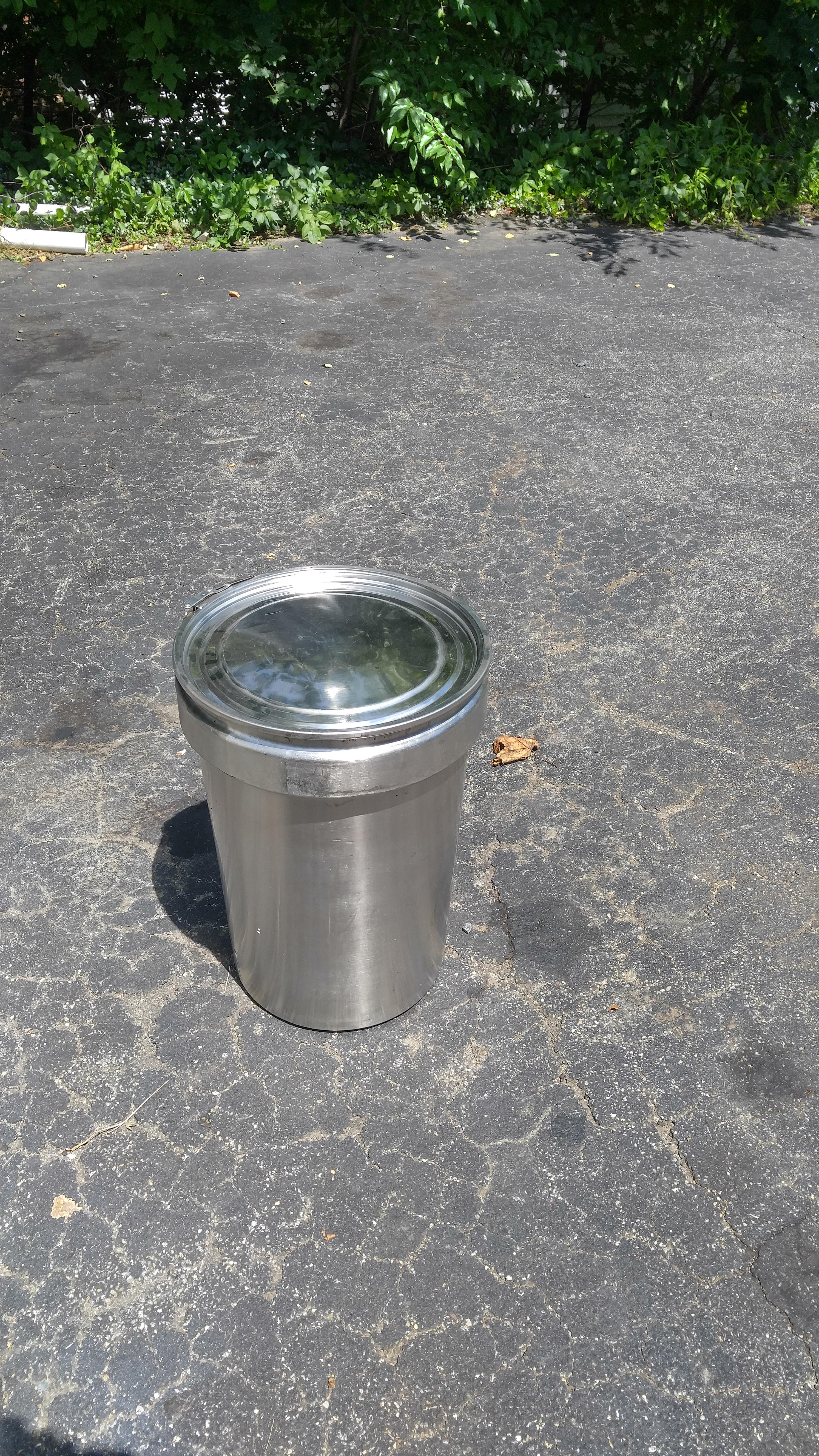

Fill a large metal bucket with the vermiculite and plunge the red hot blade down the center. Leave in the bucket 10-12 hours. This will allow a slow cooling. The blade may still be warm when you take it out, so don't just reach in bare handed.
56 quarts of vermiculite
an A2/O1 billet sitting in here until monday. Even left it in the sun to add just a bit more heat. There was some cracking in the edges of the A2, and i never let it cool down. Not a fan of A2/D2 so far.
