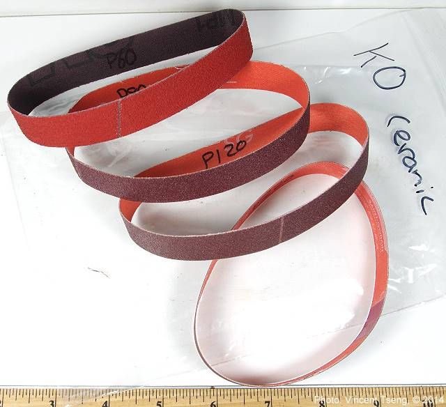

Brian -
Work Sharp have some new belt sets either on their site or pretty soon -
this is the short description sent to me by Dan Dovel the designer of the WSKTS -
The belts ...are all in stock now (and on the web site soon.)
· The U243 set is a more complete set of the stock belts (with tweener grits).
· The U264 is my preferred set for freehand shaping/sharpening. They are stiffer and will produce a flatter convex bevel if desired. (I don’t recommend them for tight recurves such as a Chive.)
· I prefer the ceramic set for repairs, profiling, and angle changes on thick blades. Just work your way through the grits and then switch over to U243 or U264 at X65.
· The MicroMesh belts work well for finishing/polishing handles etc. as well as smoothing sharp edges on spines or liners. The 6000 and 12000 make a good post sharpening strop if needed.
· I recommend the diamond belts for ceramic knives only. The diamond will also cut steel blades but the life/performance isn’t as good as the ceramic or Norax belts. (They will work on carbide blades if needed.)
· The leather is pre-conditioned with .25-2µ abrasive and can be recoated as desired. I typically only apply an occasional coating of mink oil.
From that description it seems you might want to investigate ceramic belts.
Hope that was some use to you.

I'm definitely interested in the new belts you wrote about Vincent. Like you said, especially the ceramic ones. If they are lower grit (40 to 80), that would be great. I called Darex today to see if they had a release date, but the person I got on the phone had no idea what I was talking about. Maybe Mr. WorkSharpEngineer will chime in with a release date for us. :)

Thanks Austin; looking forward to the info. I've been starting almost every blade at P120. All I seem to be getting lately is super abused dull knives. I've done maybe 3 or 4 that I started at X22 or X65. The blade on my Leatherman only needed about 3 minutes end to end, starting with the X65 IIRC. It's weird, but now I really don't think of the P120 as being *that* abrasive. I keep going with the P120 on these blades until I get a burr on both sides, full length, which can take some time.
After that, I literally make 4 to 6 passes per side on the other belts and just step through them, until finally slowing down the machine to speed #1 to remove as much of the burr as I can with whatever belt I stop at, which is usually the X4.
Having a 60 or 80 grit to work with might make that first long grinding step take a lot less time. Half as long (or less) would be great! :)
