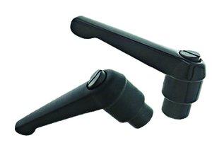

The BEE are good machines.. but one complaint I have with mine (2 HP Variable) is the way the platen locks, the handle gets in the way of your left hand as you're grinding one way.. The solution I'm told, is to grind freehand lower on the platen and it doesn't get in the way, but sometimes the work rest is nice. Otherwise very good machine, and looks very much like the Wilton, all enclosed etc. I'm still thinking about how to modify it, to give more room for my hands with the work rest on.
If you have the same tightening handle that I do
It's an indexable handle
Push the center button and move the handle to the position you want.
They are about 10$
http://www.fastenal.com/web/products/detail.ex?sku=3125593&ucst=t
Ya I have the same handle, and I have it pivoted out of the way, but it still gets in the way with how I'm holding the knife (handle bar type grip). I was talking to Ed Caffrey a couple weeks ago and he had the same complaint with the BEE he used. I'm thinking if I ditch the handle and use a nut, it will be a little more annoying to adjust, but might be "out of the way". Anyway, not meaning to hijack this thread, just wanted to throw that out there for consideration if he's going to look at a BEE.
