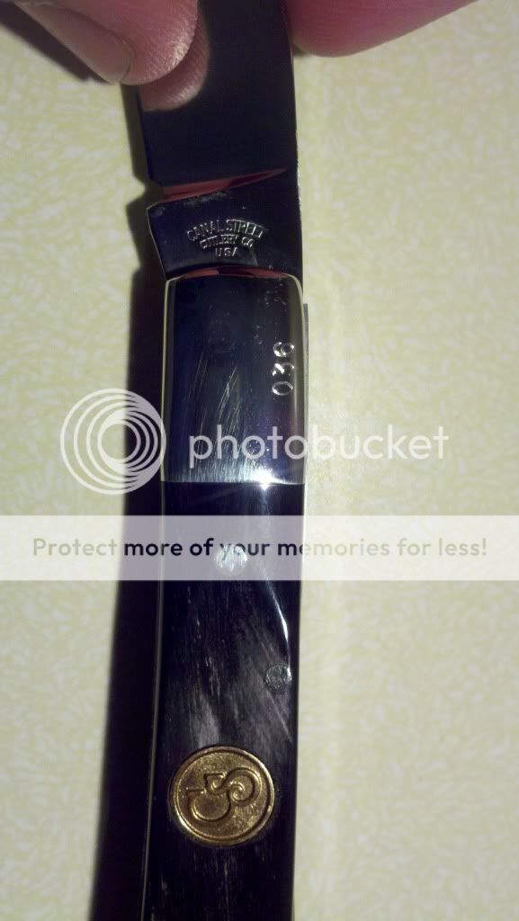

Just got my first canal street pinch lock back. And not so great. When opened and locked the lock bar is raised slightly
Also, the gaps between the liners and lock bar are quite big. I'll take another pic and show you. And it really feels alot lighter than I thought, feels pretty cheap really. Should I send it back?
I'd make sure there isn't any polishing compound or other debris in the joint that the lock could be hanging up on. If it's clean, though, and it were mine, I think honestly I'd be sending it back. I try not to be too picky, but that seems a bit much.

You're right. In my letter to them I wrote that I still have high hopes for their company. After all we're both in new York state. The company is about 3 hours from my house.
But the knife felt cheap in the hands. Makes me nervous.
I don't think the Pinch feels cheap at all. It's essentially a single blade bare-head trapper -it shouldn't be heavy. It's a knife made for cutting and slicing, not ultra rough work. A spear point straight or baloon jack is better for that.
If it was mine, and I could get the lock bar flush thru cleaning, I would gently pein the center pin on the handle until the gaps closed to a few thou (squeeze this area and you should see the gap disappear). Remember you can't always make a lockback as gap free as a slipjoint and still keep reliable function (depends on materials and design).

I tried cleaning but it was still the same. Thanks for the tip on the knife is supposed to be light. I'm used to a case Texas jack, which is much heftier. Not that I do any hefty work with it.
If that lock bar won't sit were it ought to, I would definitely return it to the vendor or mfg. If the vendor, I'd want a new one sent ASAP and not wait for a repair. I hope you get satisfaction, I really like mine. It is easy on the hands in use, and rides nice in the pocket. ;-)

However, that raised spring on open would send me into orbit as it affects the in hand feel. Nothing worse in my book:eek:

That spring end sticking up would be the deal breaker for me. You could almost overlook the gaps, but not that spring.
CSC puts out great knives. I might expect that type of result from a mass produced factory knife, but not the boys over at CSC. Shouldn't have left the building to begin with, but I'm sure they will make it right.
Yes. It's going back today. I'll post back here and let yall know how their service department is.
