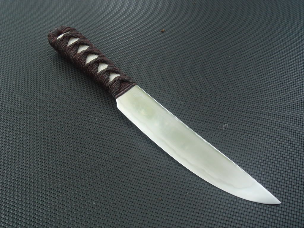

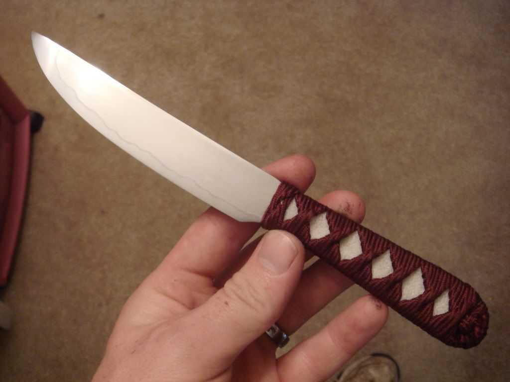

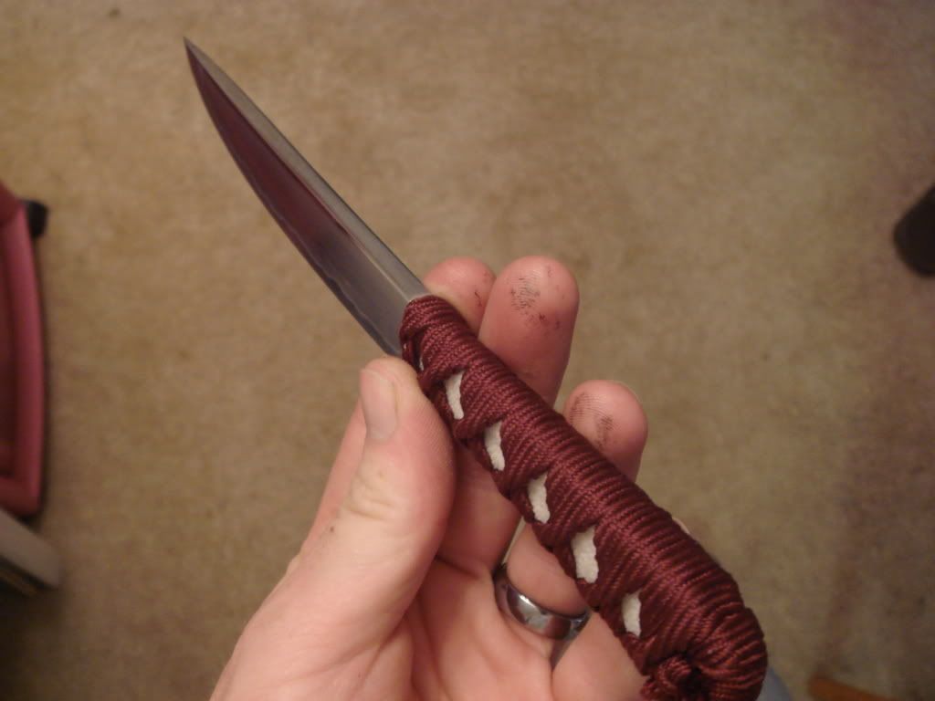

hey everybody
forged this blade out of W2 at the same time i made the wak. finished it up over the past few weeks. i havent had really any time. working full time now, and trying to finish up two sheathes... i just like making knives more than sheathes, so sheaths take foever... but enough complaning
OAL: 9"
Blade: 5"
forged from W2 steel
3/16 thick spine tapering wider at the butt
Rayskin under Silk Ito (i am going to resin treat it)
double hamon line
inturupted quench in parks 50
finished to 400 grit then polished
slight convex grind (it is WiCKED sharp!)
Kydex sheath (not shown)
$lod! thanks everybody. this knife is gonna go to iraq. making the sheath TekLok compatable.
comments apprecieted
please email me at Knifemaker87@gmail.com i prefer paypal and will ship the knife as soon as i recieve payment.
thanks so much!
~Chris
Chris, that is so incredible it approaches the absurd. Talk about a cool hamon!!!!

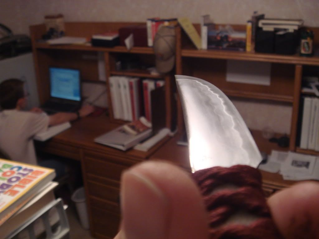

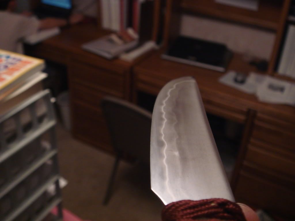

How did you do the quench? Did you end up using satanite, or did you try Rick Barrett's stuff?

it was an interupted quench, in... 3 seconds out 3 secnds back in till cool. i got some of the stuff Rick uses and it is really cool... it is totally differnt very plasticy and.. it dries with a "skin" real fast... but it is good stuff

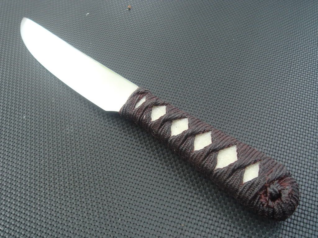

i just put the resin on the silk and it is now like... black. *sniff* all the color is gone. if it stays black i am gonna take it off and re wrap it. i liked the red.
we shall see if it stays black or not
~chris
it'll probably stay black or if not really really dark red....damn resins! they always darken everything! Bitchin bitchin blade I must say! That Hamon is like OMG beautiful!
nice blade. I think the pricing is just right, not sure if higher will necessarily be a good thing - there's a fine balance. love the hamon.
really classy looking and has a nice handle shape. But you better watch out, I think it has a mind of its own- It is trying to point towards the kid on the computer!
*laughs*
yes it did lighten up to a dark red... so the resin is alright... i still like the natural look.
i used back furnace cement for the clay, as recomended by Rick Barrett.
thanks for the comments on the hamon.... i just got it on the low end of critical. it turned out cool.

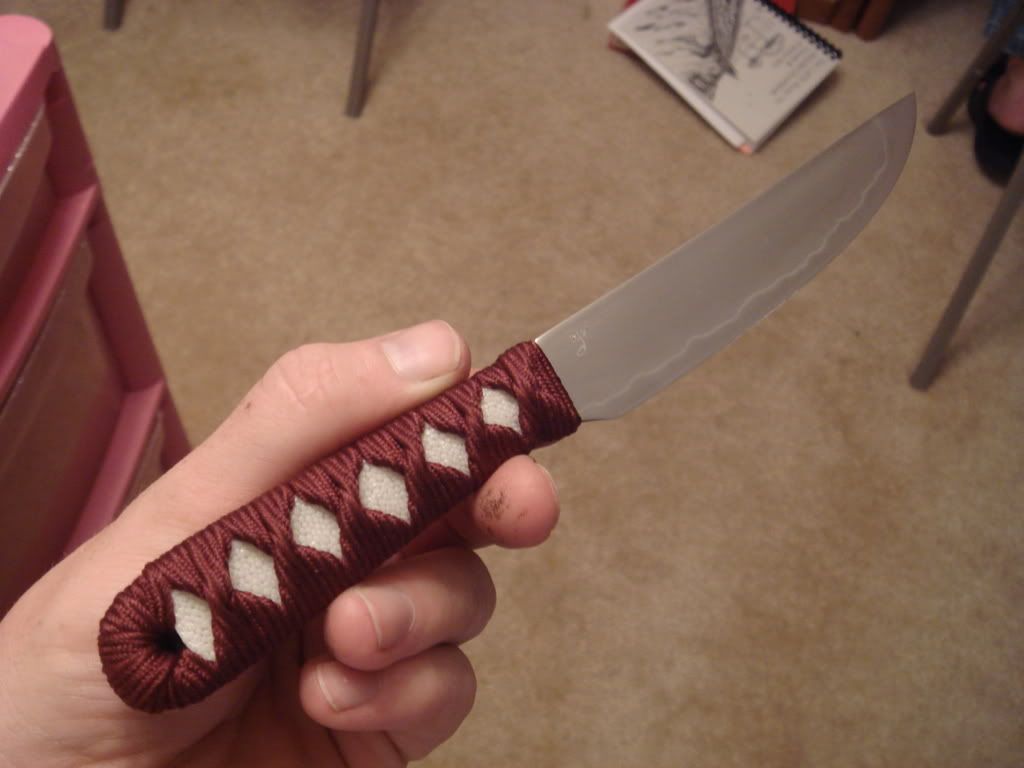

and here are the pics of the resin coated handle... i dont like the color nearly as much... but it is 100X more resilient to the elements
do you think it detracts from the whole?
thanks for looking
