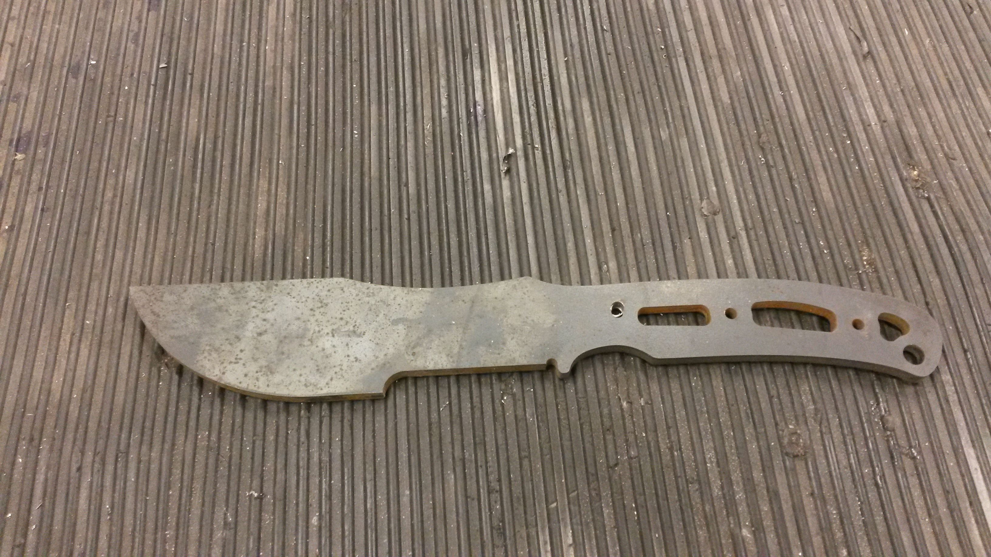

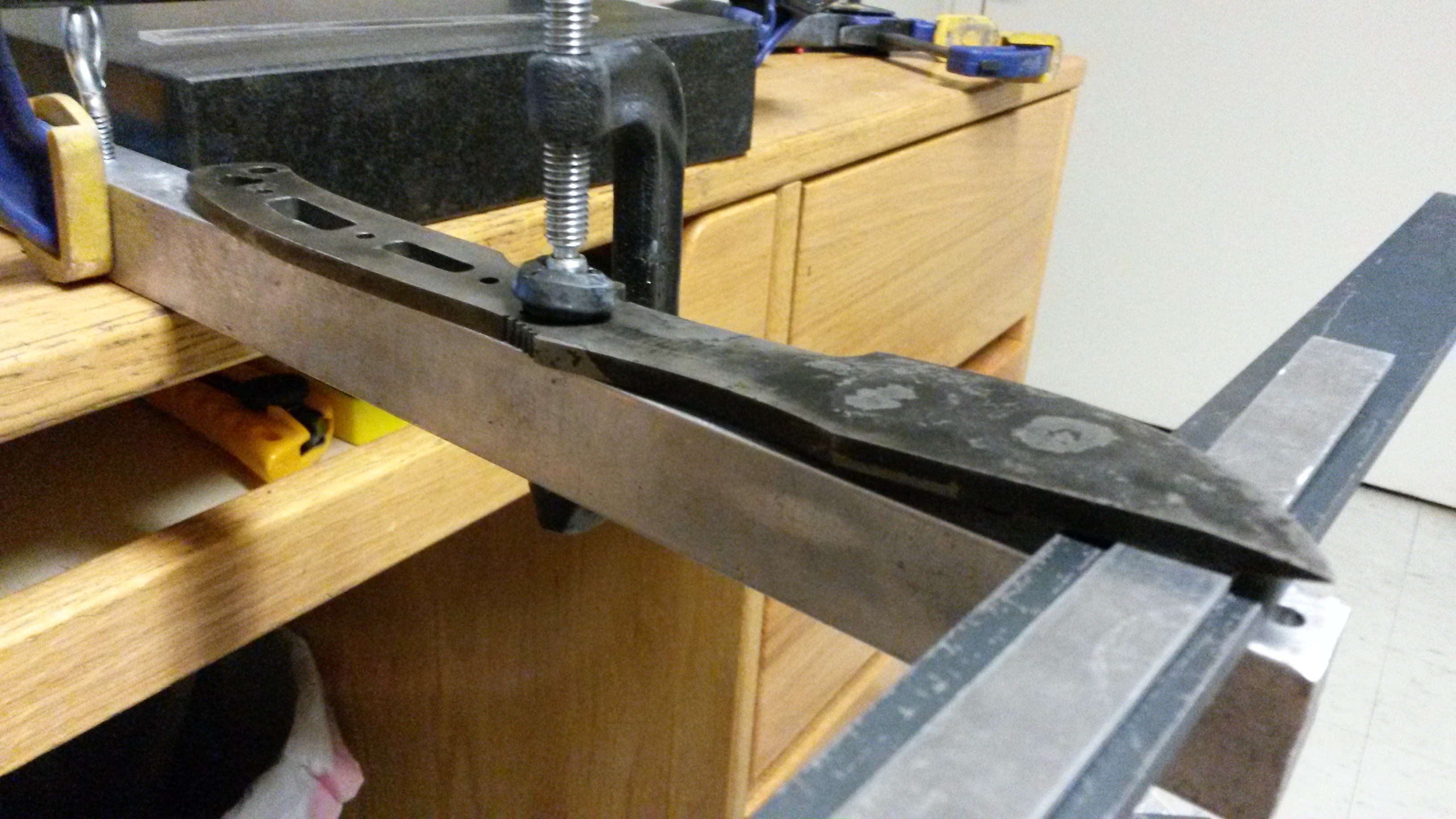

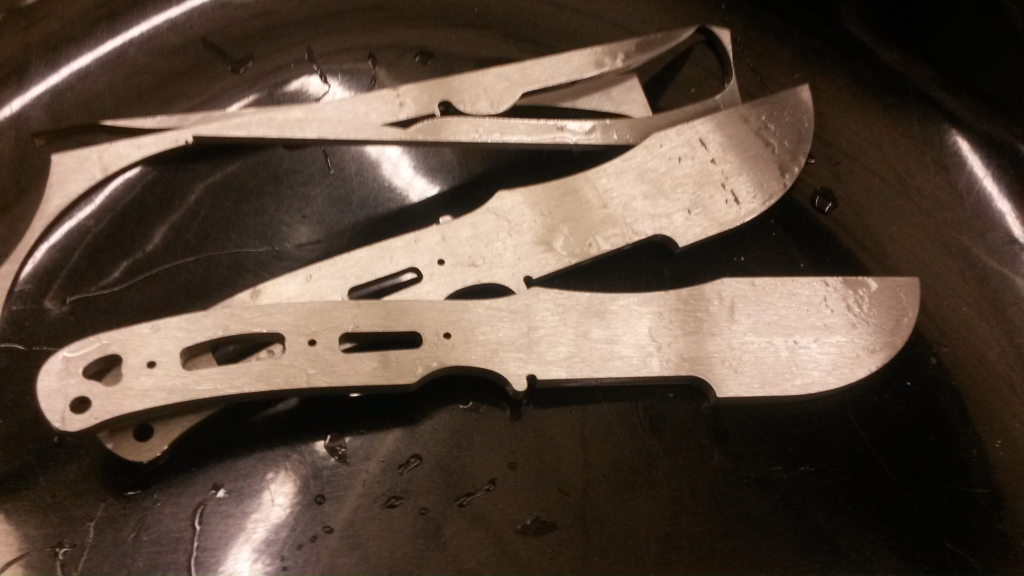

I water jetted a full size dummy of the blade out of 3/16" mild steel. The water jet screwed up the first hole so I drilled it through, but no big deal. It gave me a pretty good idea at the heft and feel of the knife in hand (which I'm actually very happy with). It's still quite a fat prybar.

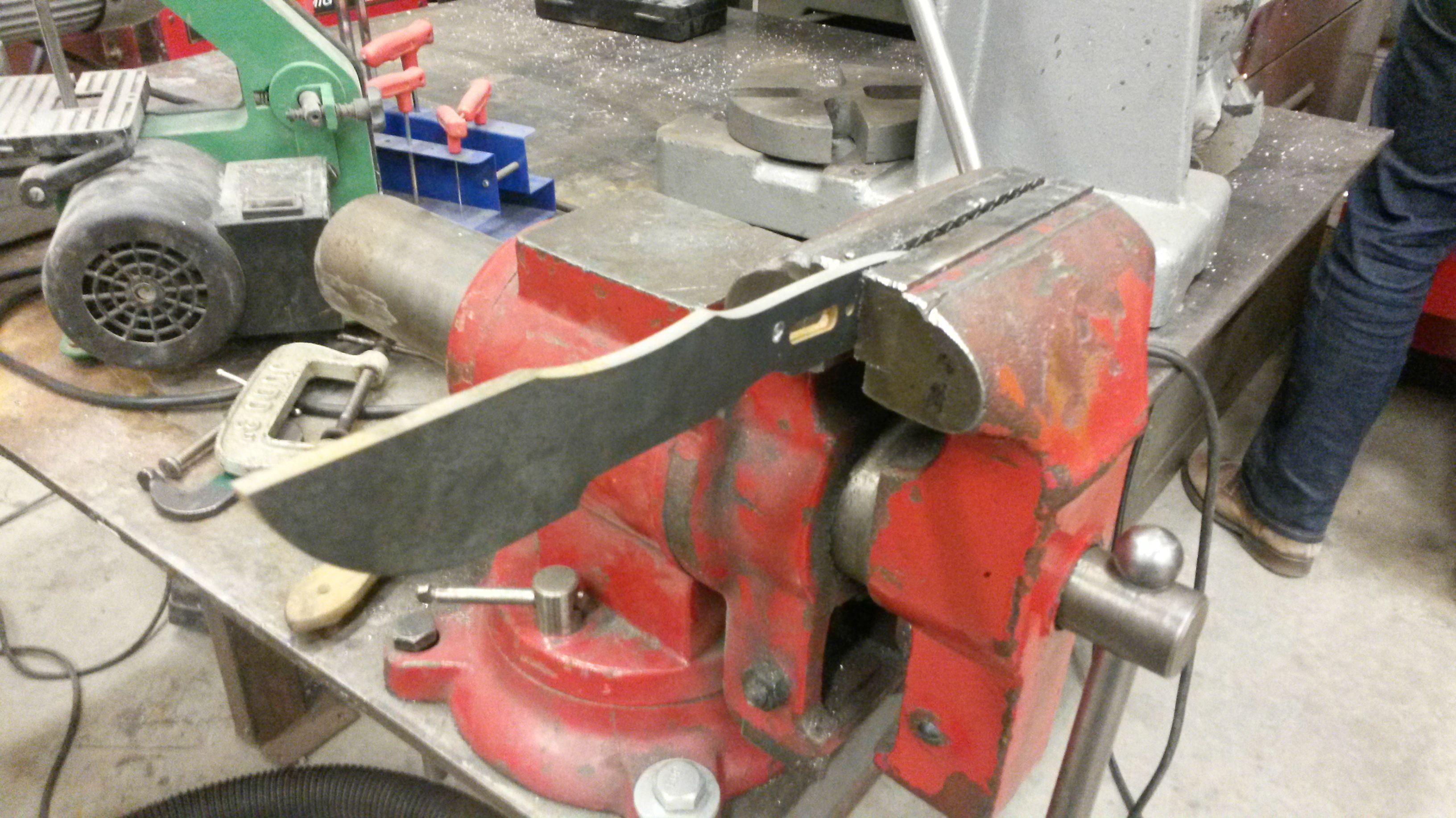

I clamped it up by the handle and whacked the blade a bunch with an aluminum tube (it was about 1.5" square x 0.095" thick I'd guess).
I did, however, use much more conservative cutouts than before. I think I'm ready to run this out of O1 (when it arrives), though I'll make the profile oversize and the holes undersize so I can finish them up with drill bits and a die grinder for the lightening holes. Hopefully the water jet doesn't screw anything up, since the one in my shop is admittedly pretty squirrely.

Water jet 2 blanks today, with just a hair of material to spare. Two blanks just in case I screw up/decide to do a second one, since I don't expect to use 3/16" stock for any of my personal knives anytime soon.

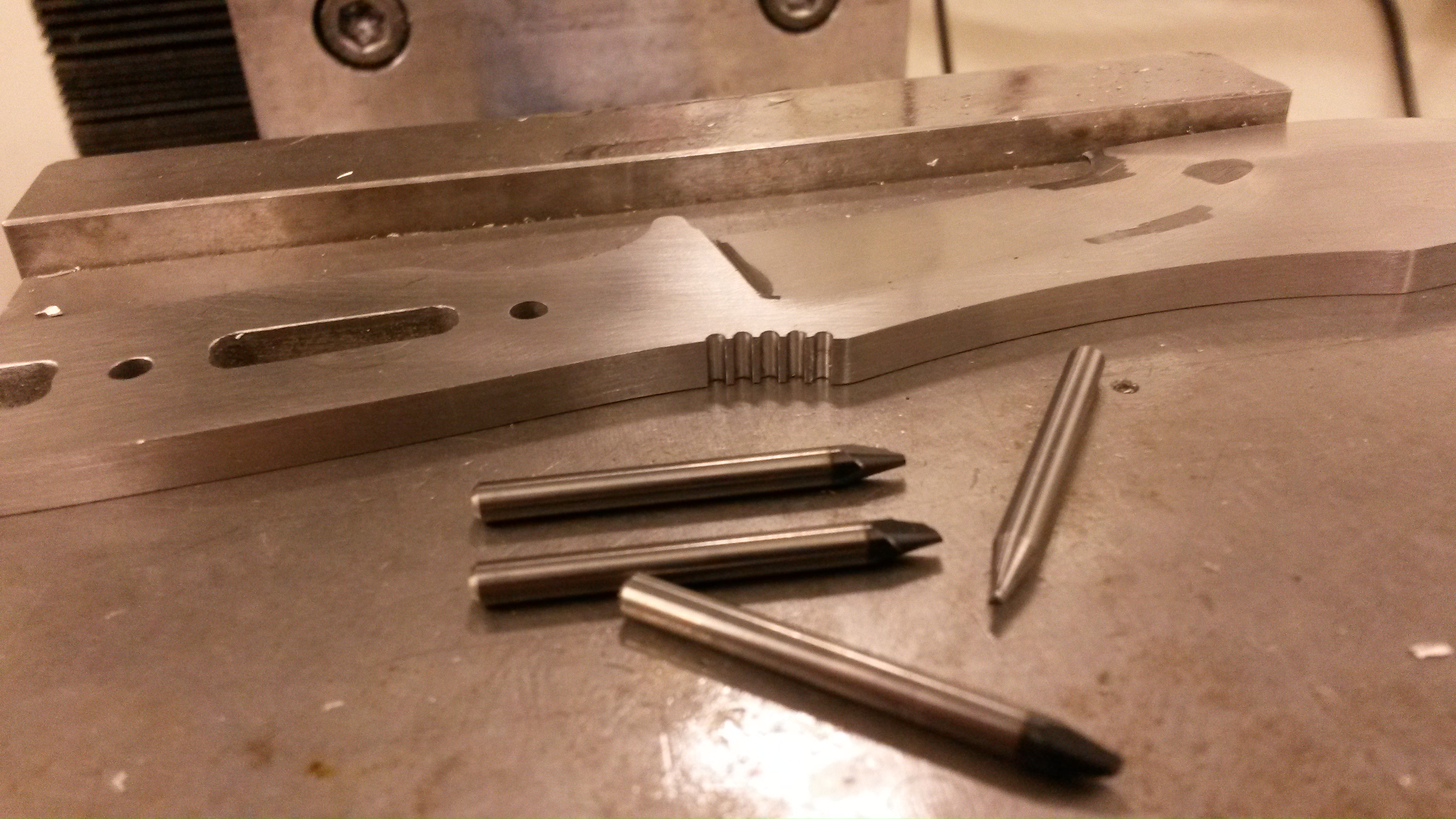

Was playing around with scribing some jimping. I think I'll try doing it with a triangular needle file on my mild steel dummy blank and see how I like it.

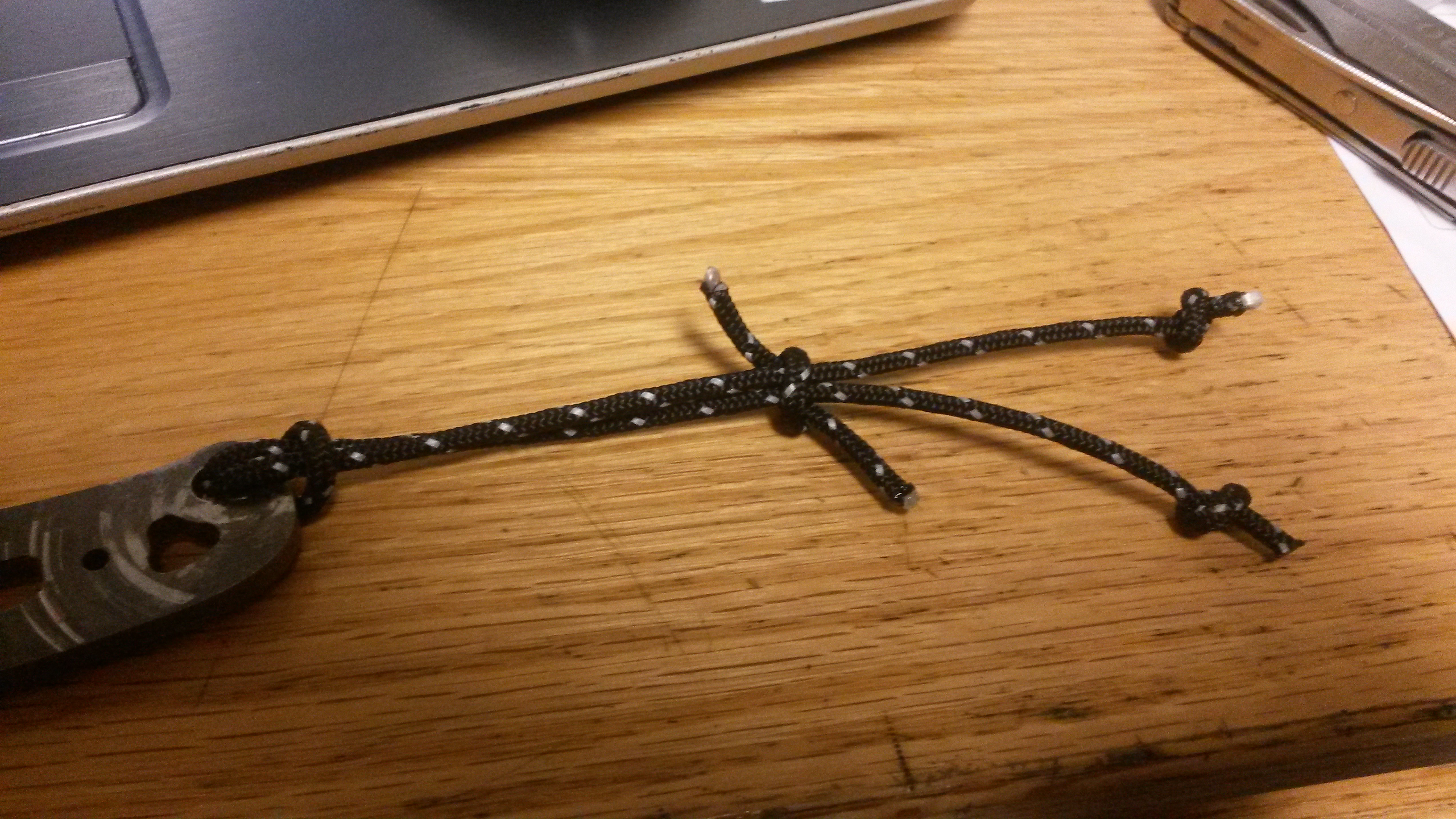

Was also playing around with the lanyard I plan on attaching. Need to use better knots on the real thing.

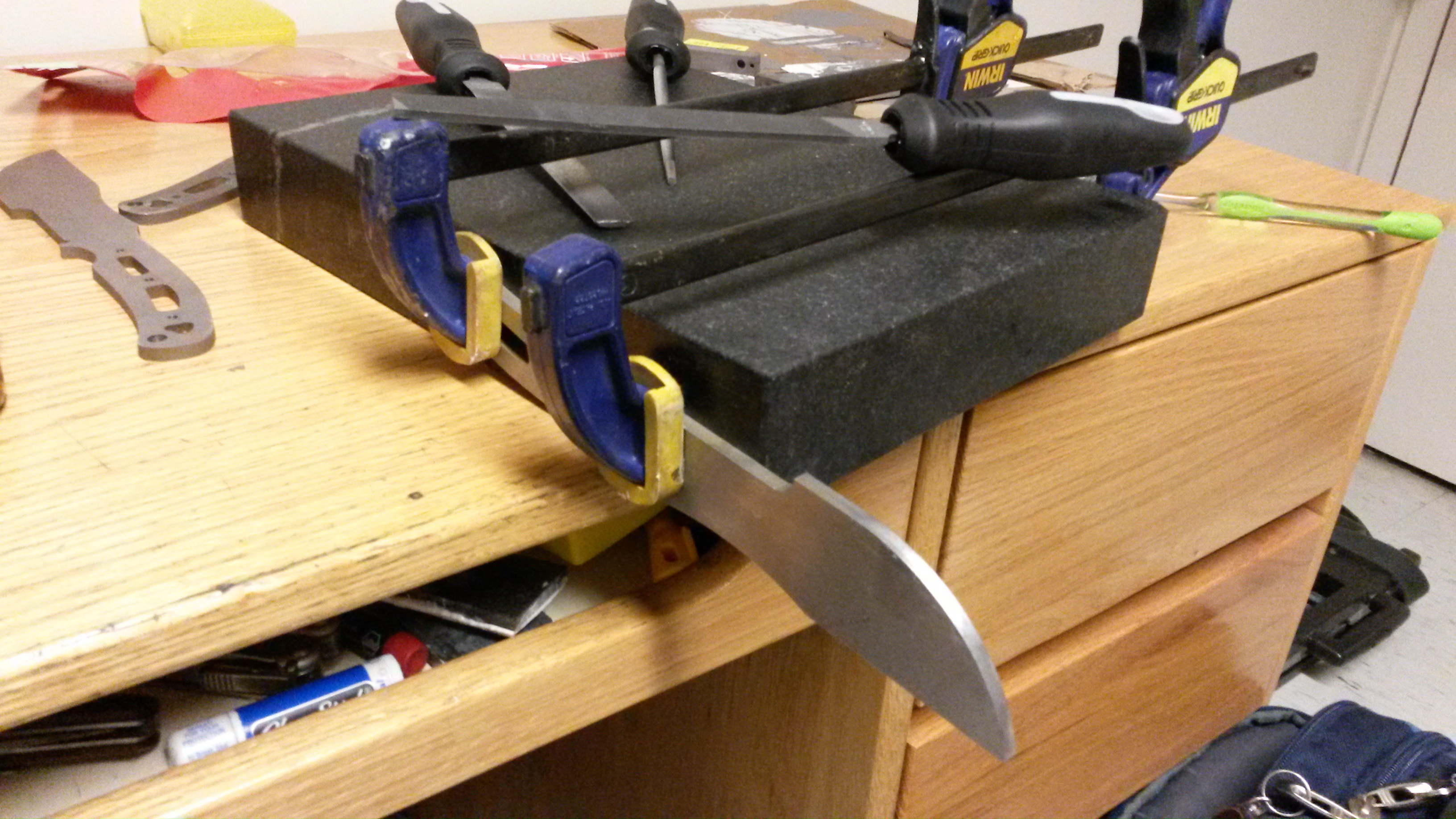

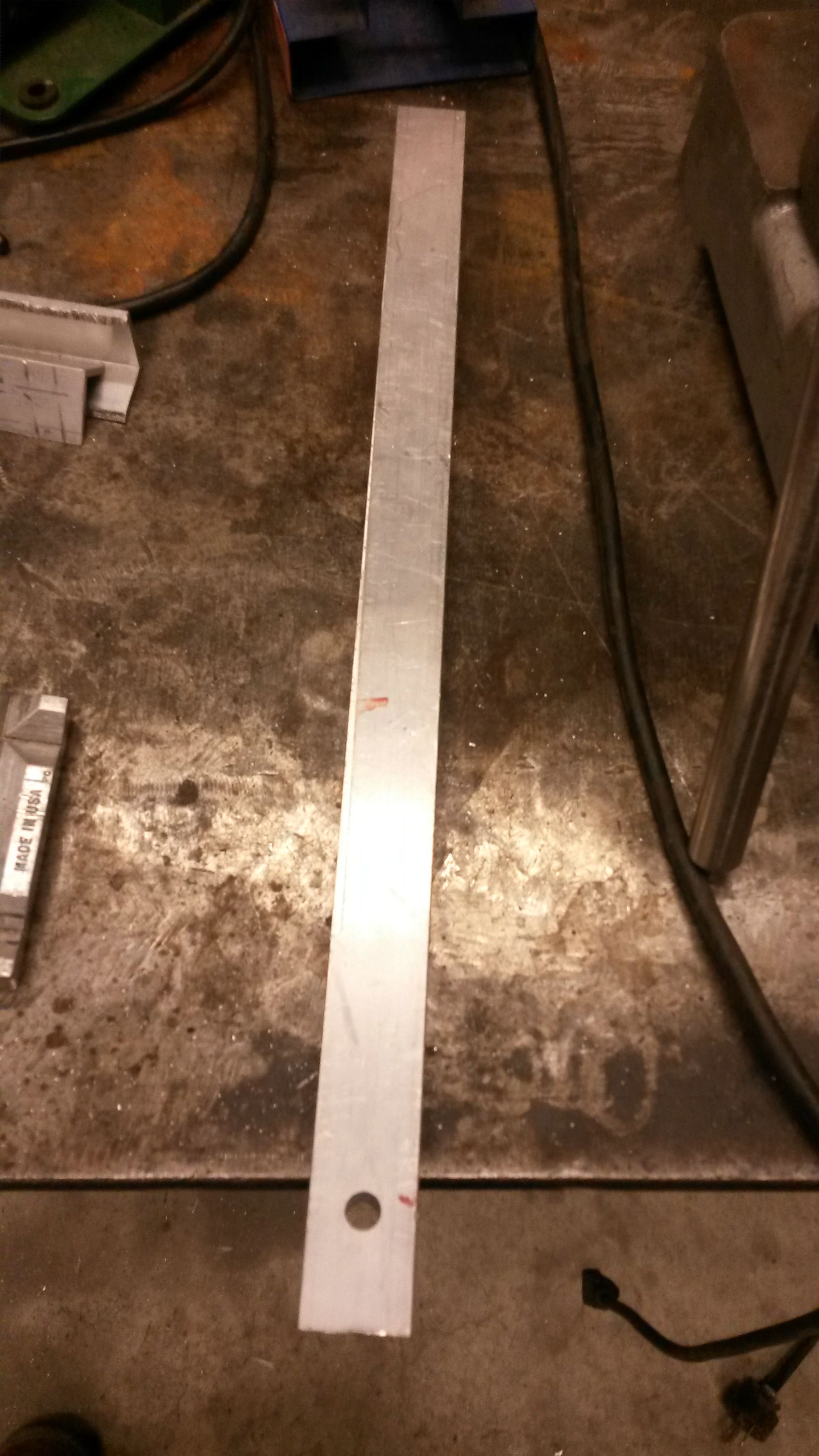

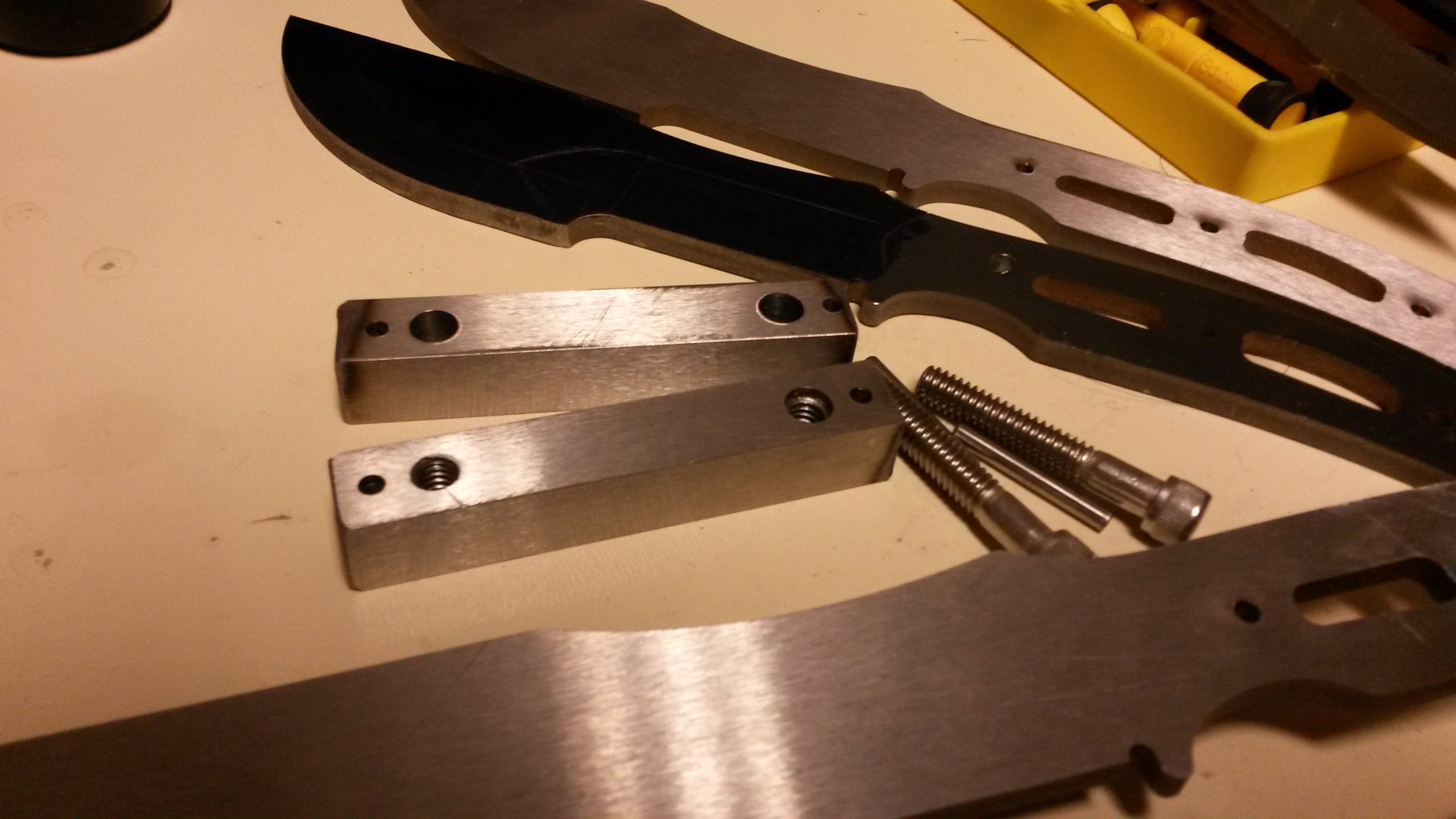

Just wanted to post an update (if anything just to keep myself from forgetting this thread!). Finally got around to making myself a file guide (boy, 3" x 0.5" x 0.5" looked so much bigger on the screen!), hoping to harden it soon and use it to test out Brownell's ATP-641 and see just how nice of a finish it leaves after quenching. Currently have way too many irons in the fire though, so all the knives I'm working on are all slowly crawling along.

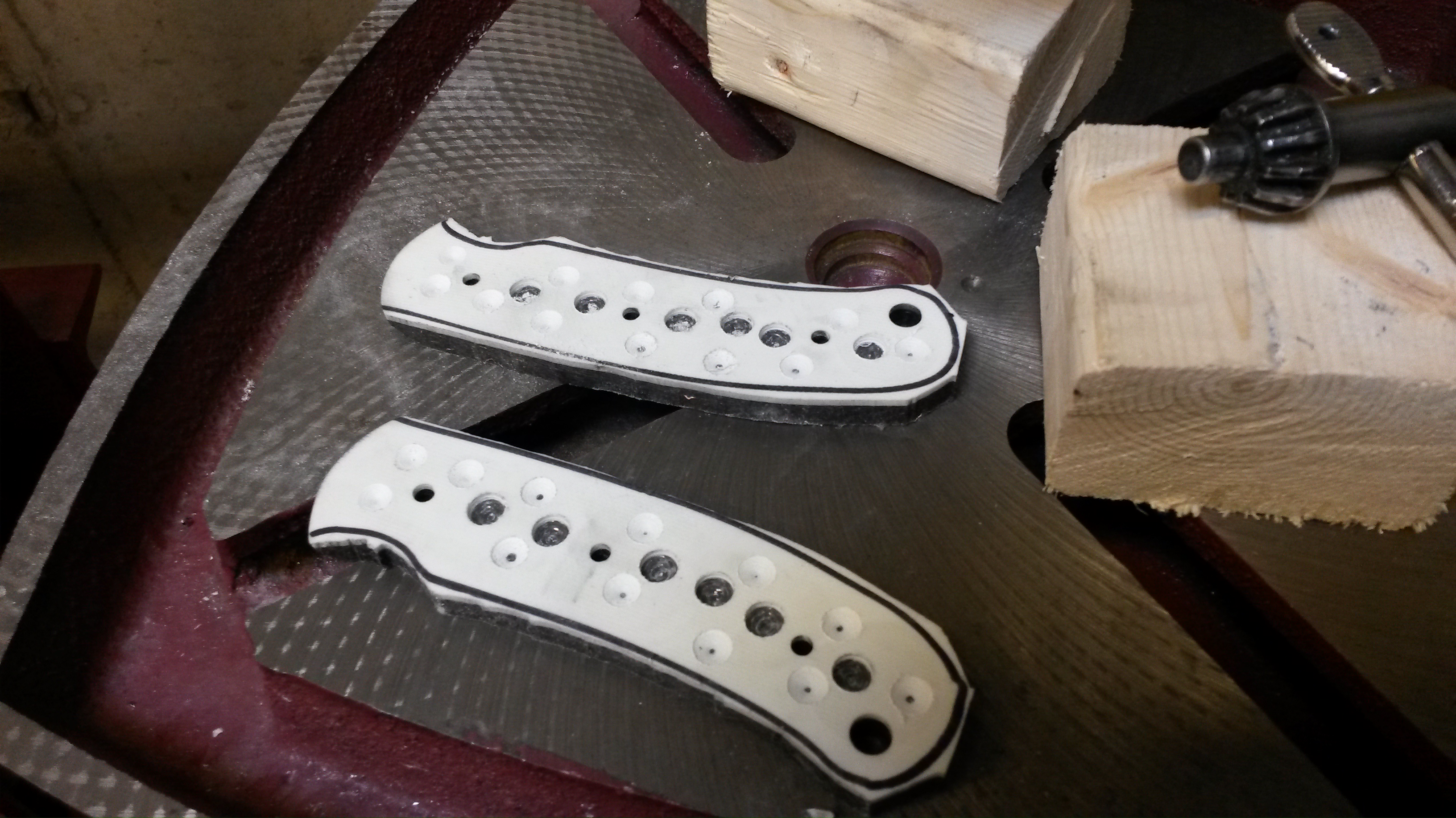

Epoxied white G10 Liners to Lightning Strike CF. Afterwards I flattened them on a machinist's block and super glued them together.

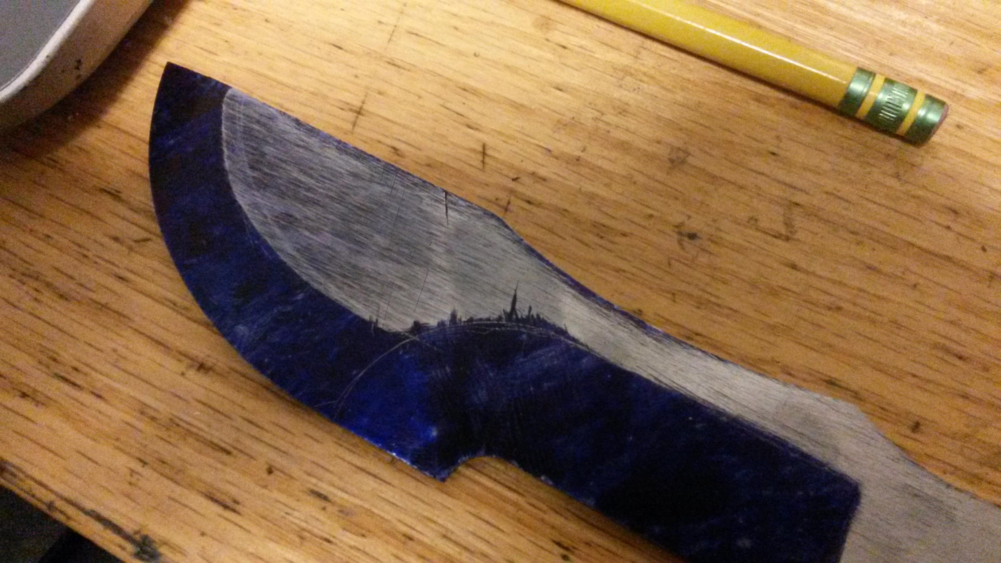

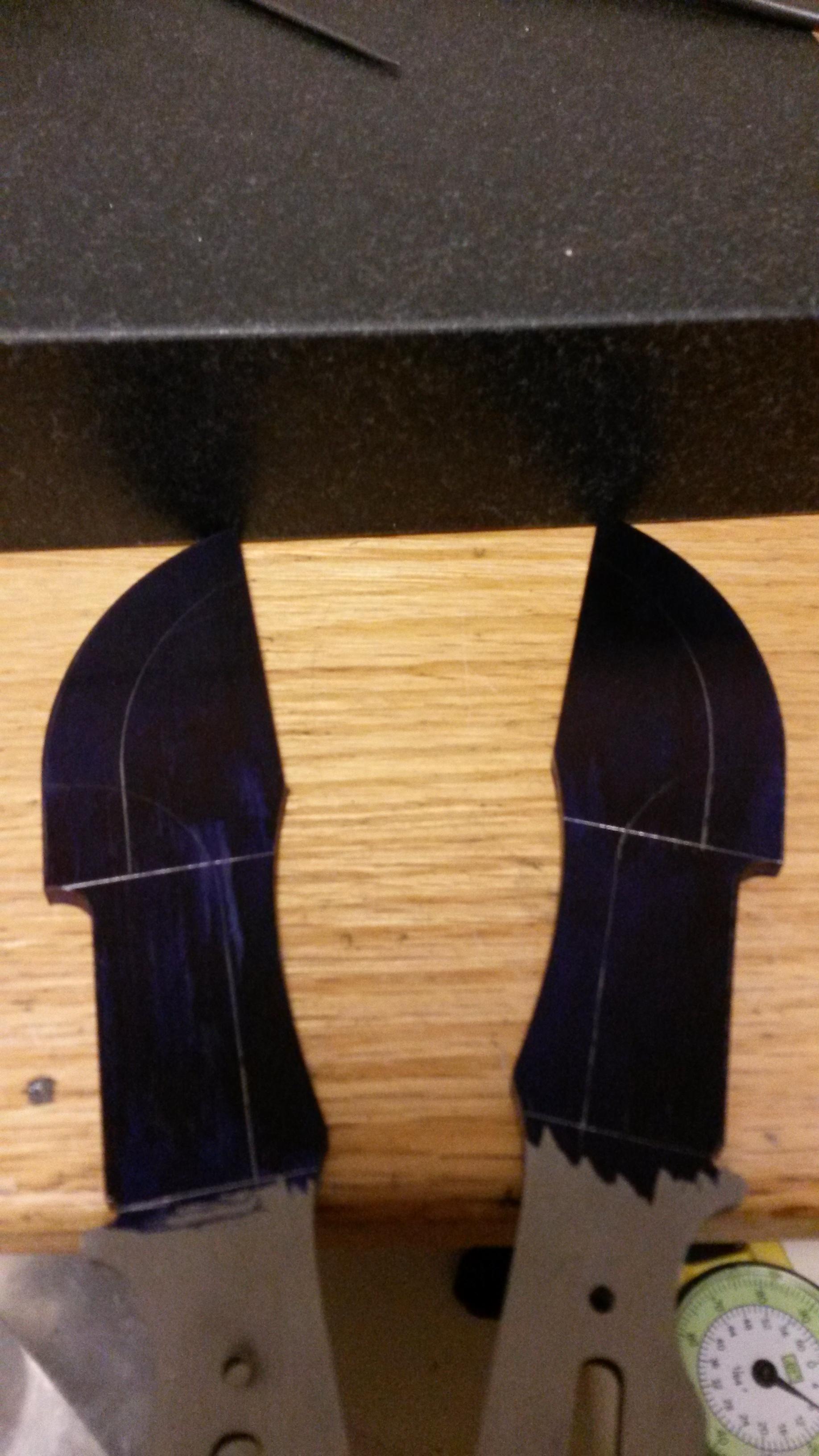

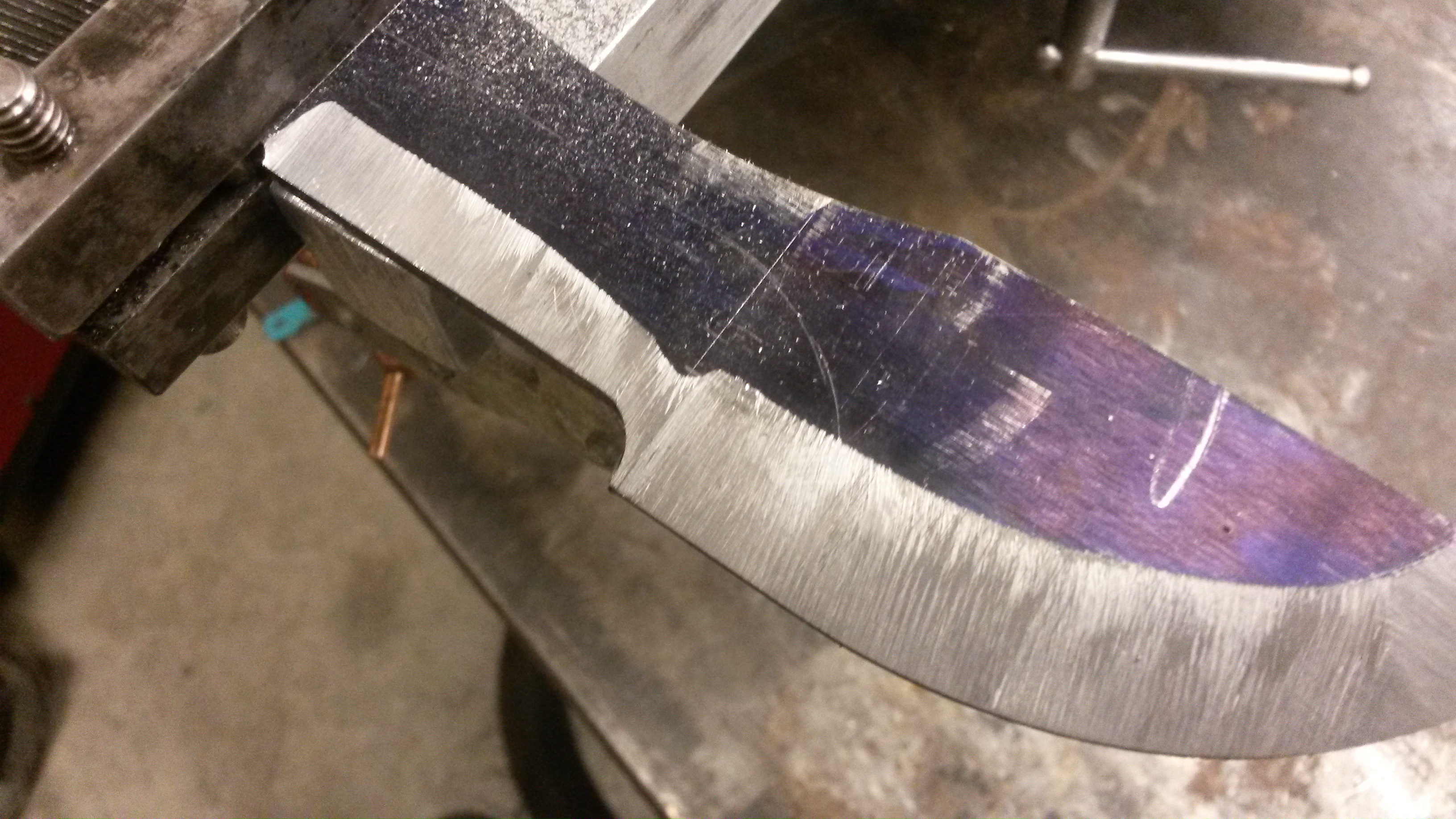

Hit the blade blanks with some Dykem and scribed my grind lines. Lesson learned: don't use Dykem in a closed, cramped college dorm room!

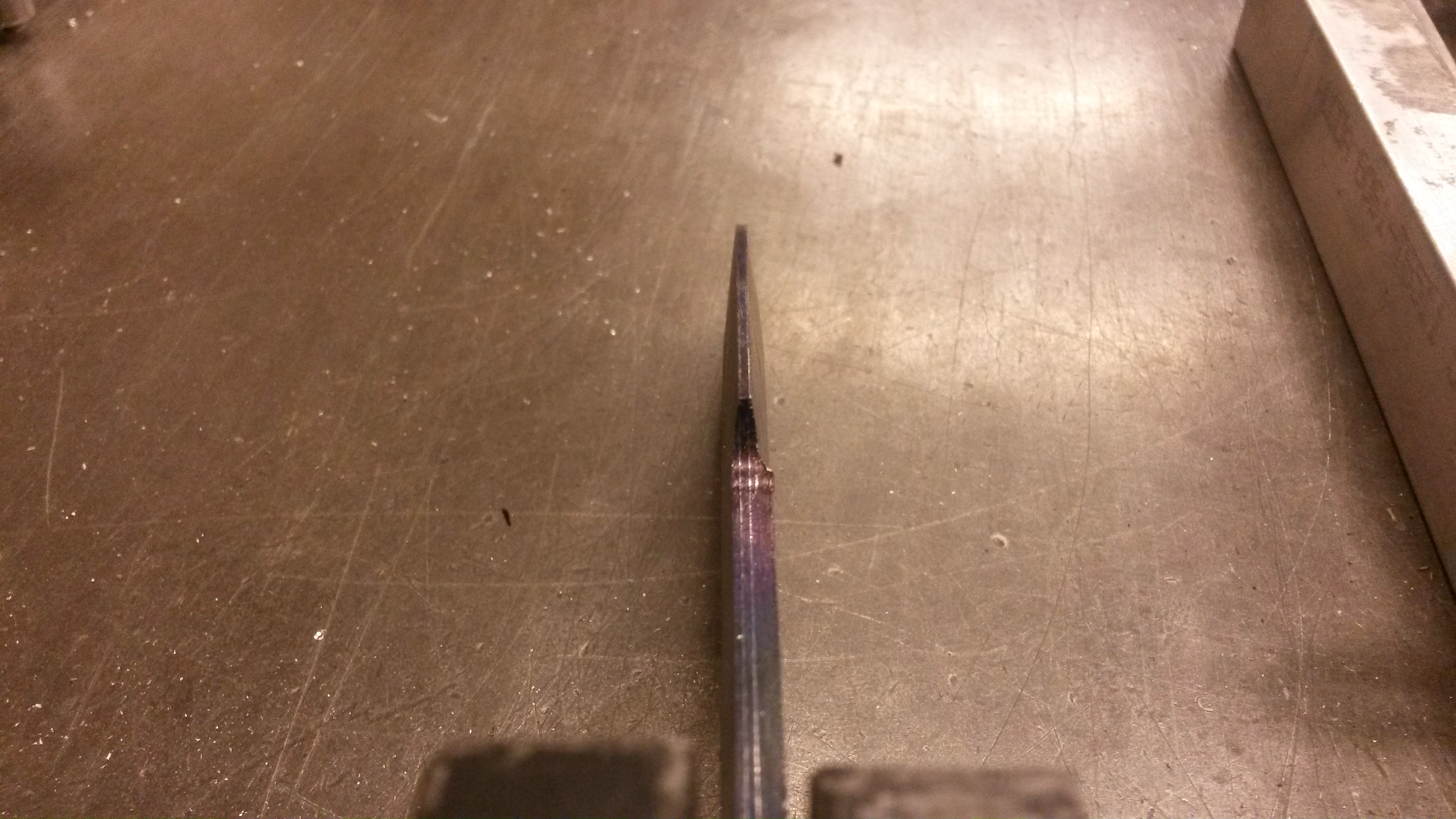

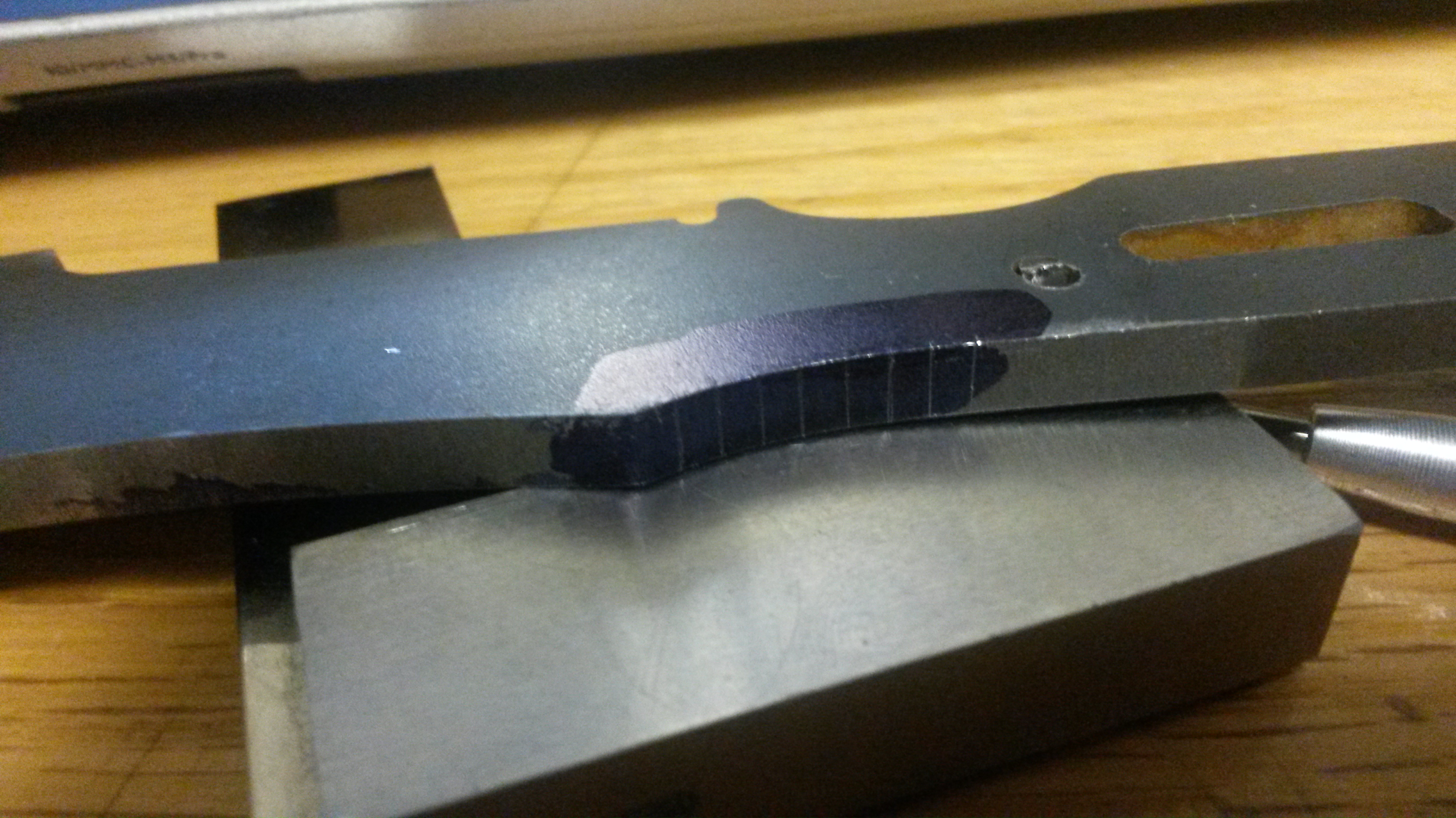

Scribed edges to get a target thickness of 0.020". I figure I'd probably accidentally go past that after draw filing and sandpaper anyways.
Scales had their holes drilled and roughed out on the band saw. Also had their front edges ground on my HF 1 x 30. If I'm still awake, I might get the front edge of the scales to final polish before popping them apart. To the left is the cut off scrap from the scales, which I figured I could use for a stacked handle or something somewhere down the road. I was a little worried since the epoxy gave before the super glue when I was hammering them apart. I'll have to be careful when I do that with the actual scales. On the right are a pair of walnut/blue and red stabilized maple burl that I'm going to use for new handles for a $20 Walmart kitchen knife. Talk about lipstick on a pig, but it has a bit of sentimental value since it was from a kitchen set that was one of the first things my family bought when we first moved to the US, and all the other parts of the set (paring knife, utility knife, scissors) are all lost/destroyed except for the kitchen block.

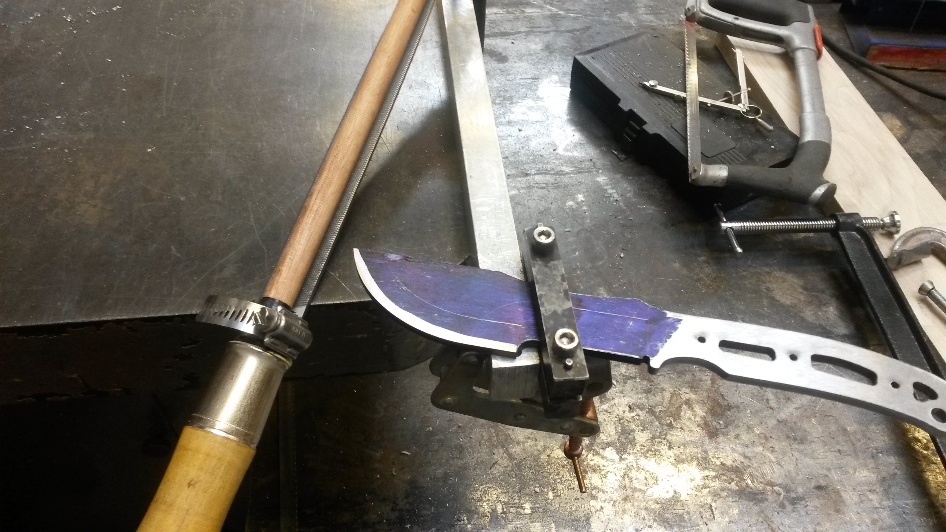

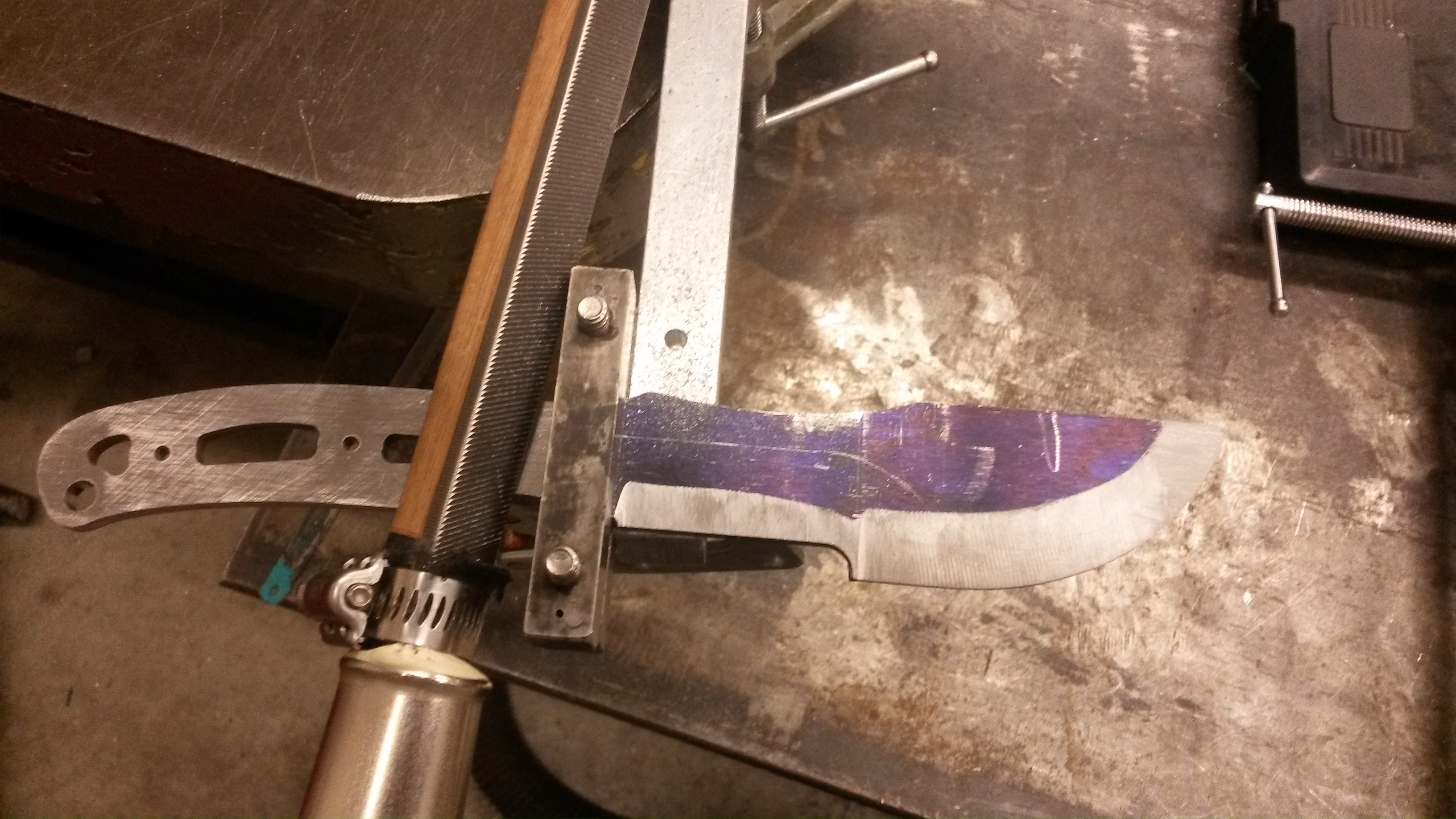

Using the new filing jig. Holds up pretty well, but there's more of a learning curve to it than I expected
Had to fiddle around a lot with offsetting the filing jig since the plunge would always start at the jig, so the actual full depth cut would be 1/8" or so forward of the jig.
Still not sure what I'm going to do about the quarter rounder.
The sharp belly on the tracker doesn't quite play nice with my filing jig since it was designed for my folders with a more gentle belly, so I still need to freehand clean everything up with more filing.

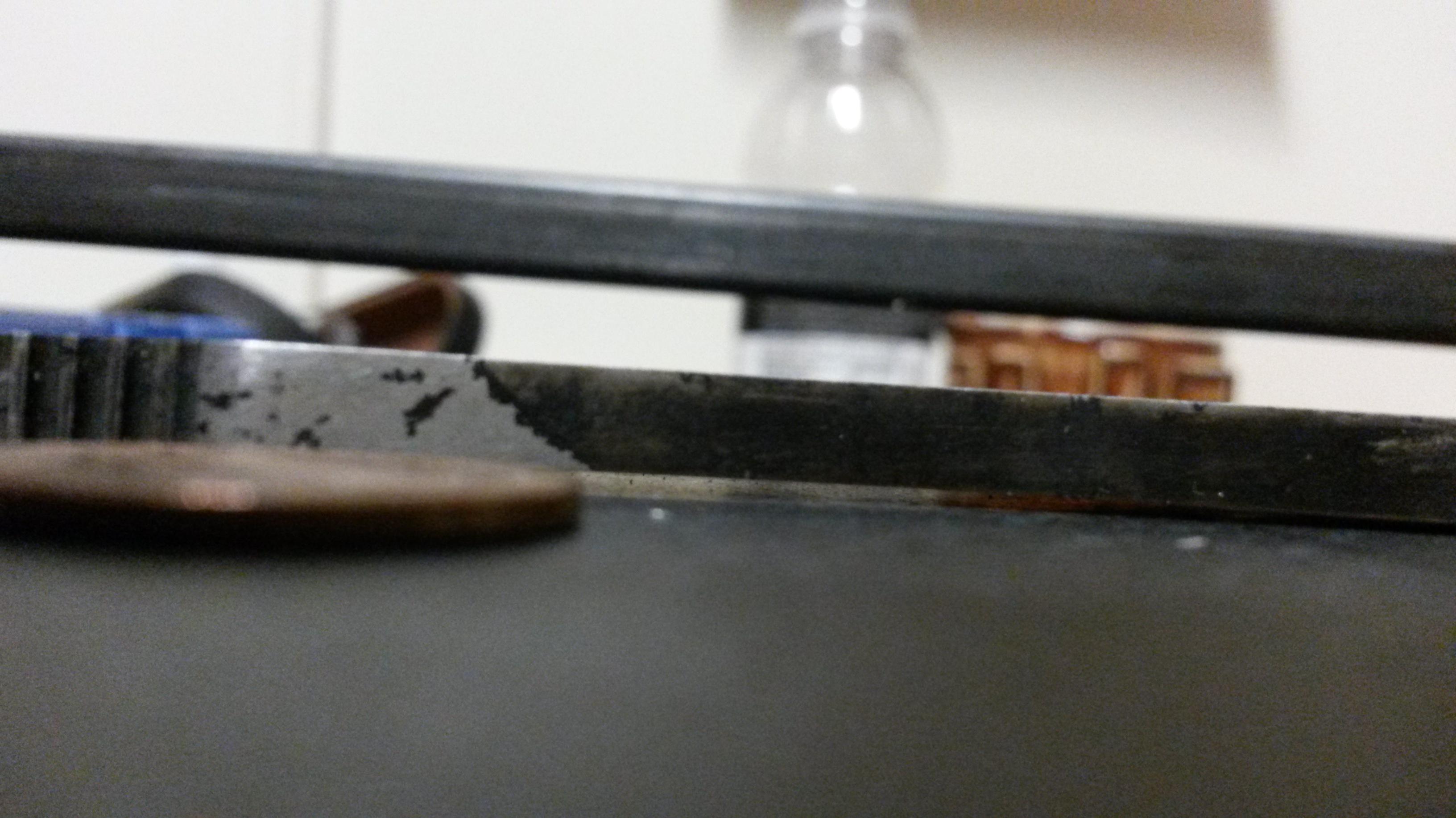

Edge thickness was 0.050-0.040 before I turned in for the night, so I'll have to go back and get rid of some more meat. This filing jig also doesn't quite handle the obtuse primary bevel of the chopping portion, but more whining won't solve it, only more filing :D

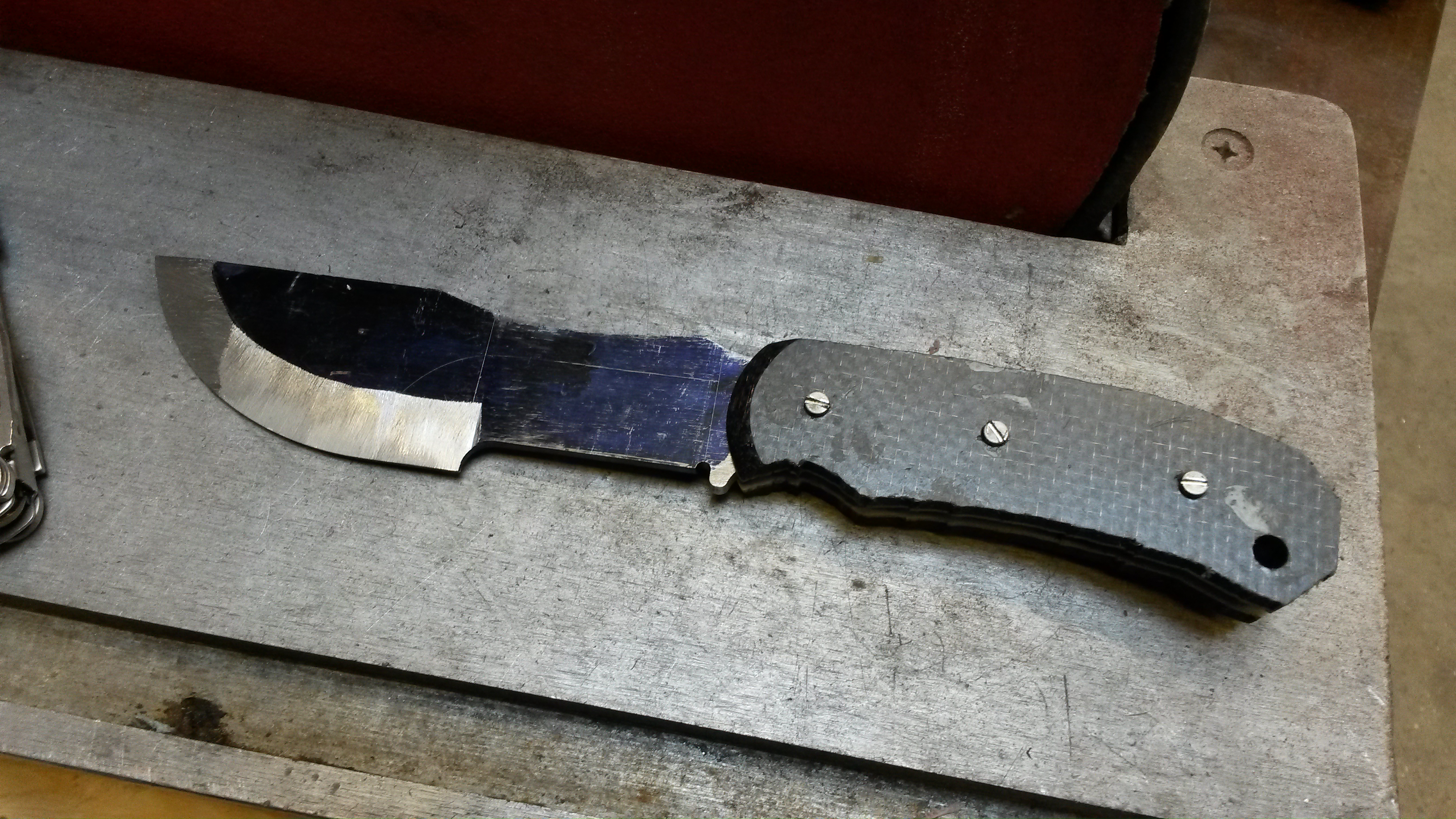

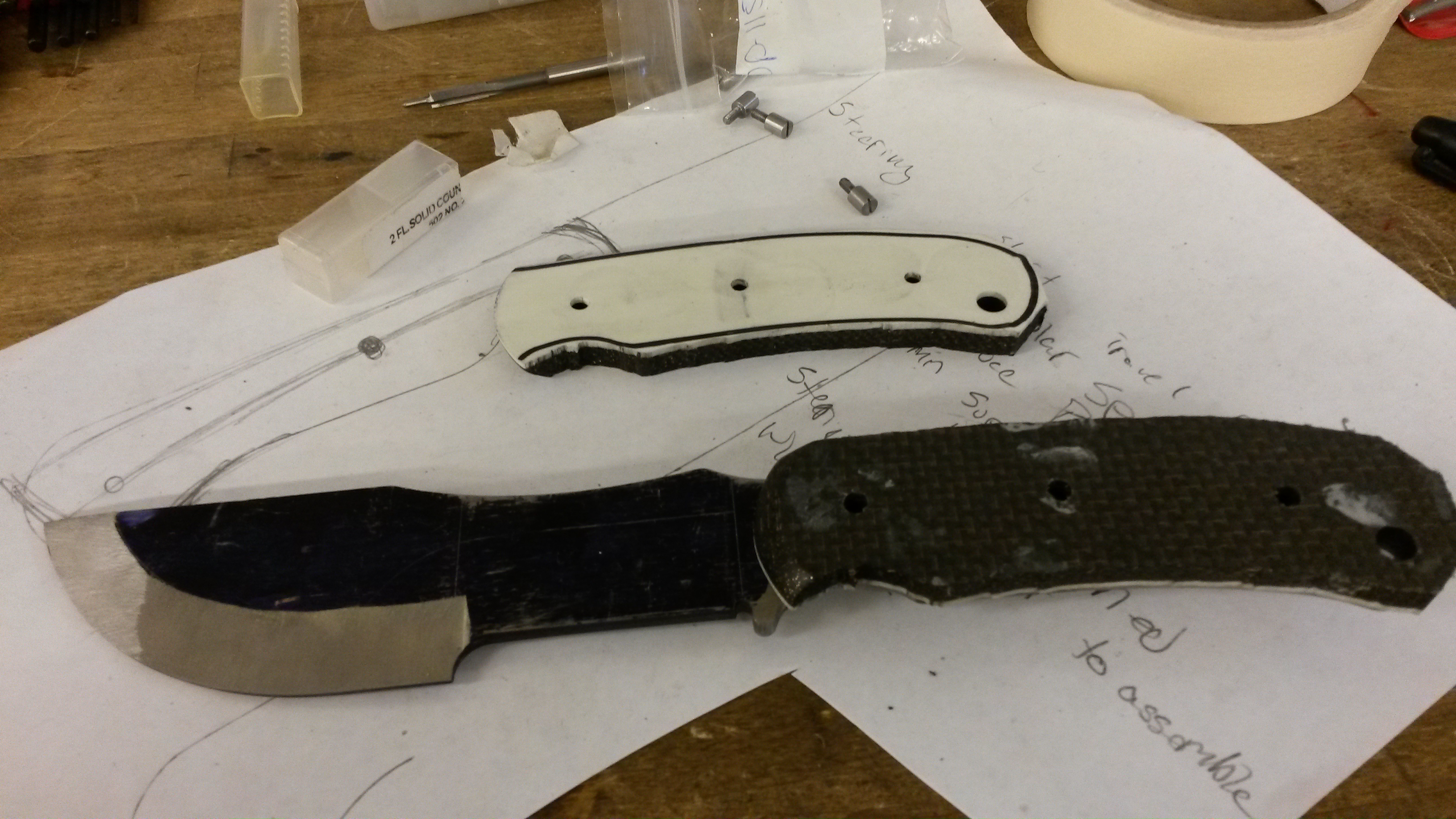

I chamfered and sanded the front edge of the scales to 2000 grit. Finally getting a glimpse of why this stuff is so pricey. I had to knock down a couple stray wires, but luckily they seem to stay in place once it's sanded smooth.

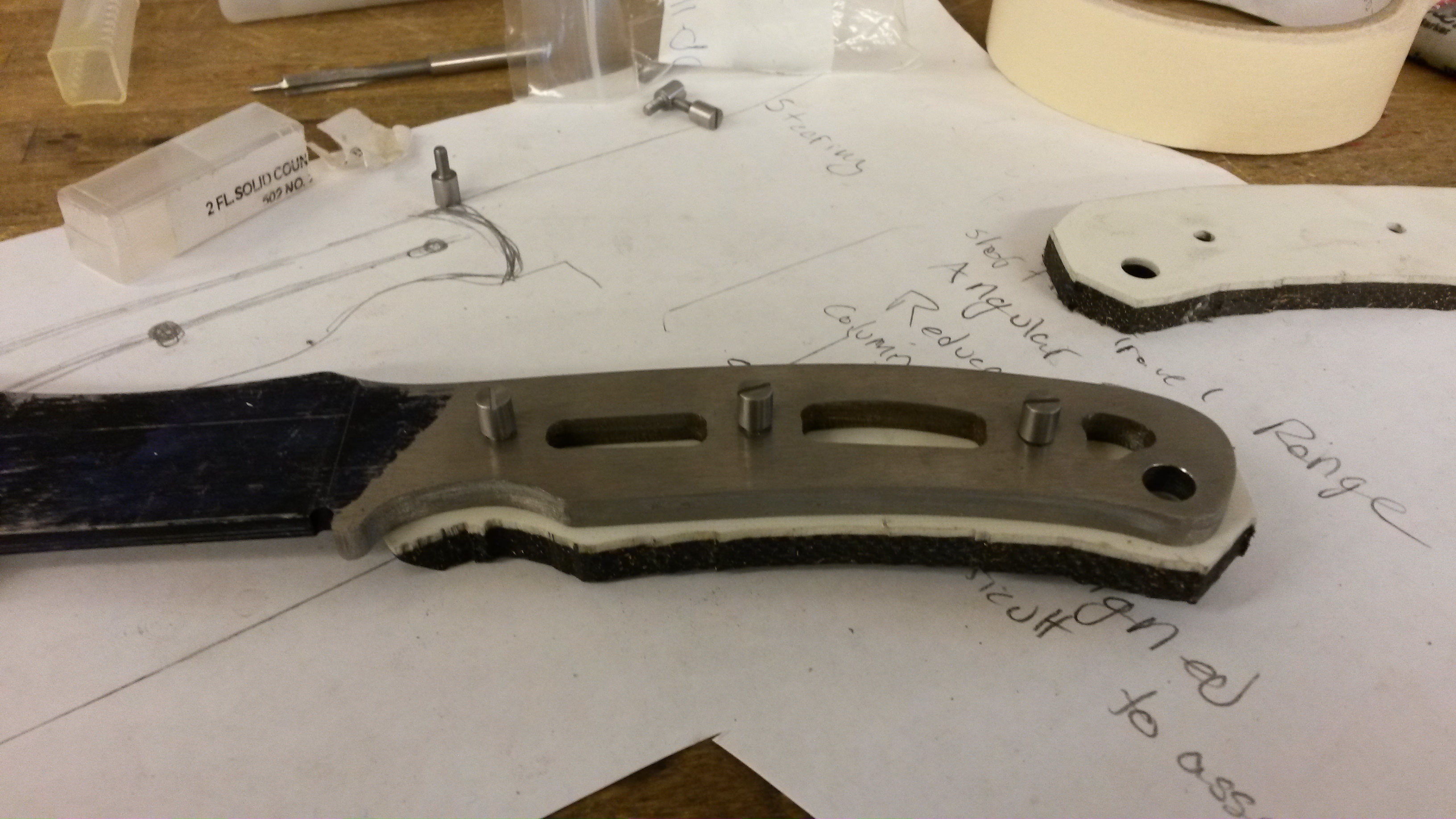

First time using corby rivets, but I've used Loveless bolts so it wasn't that big of a deal. Drilling holes and counterbores actually took me a good hour or two, since the complete set of nice drill bits is in a different room of the shop than the drill press, and I snuck up to the hole sizes through half a dozen drill sizes to try and get a nice snug press fit. I figure all this heartache will be worth it so I can take the scales off after profile shaping to cold blue the blade.
I drilled some holes for "epoxy rivets". First time doing it so I was pretty conservative. I drilled to the CF along the centerline of the scales, but only just barely past the G10 liners closer towards the edge since I was afraid of grinding into one of the holes.
Scales dry fit. I feel like the longer I work on this knife, the less massive and ridiculous it feels. Maybe because I only got into knives a year ago and I wouldn't carry anything larger than a small folder.

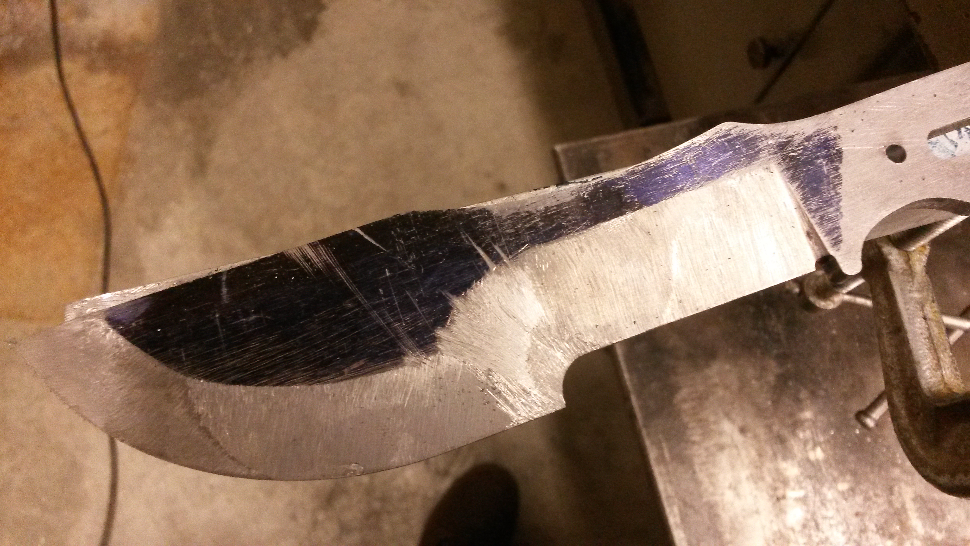

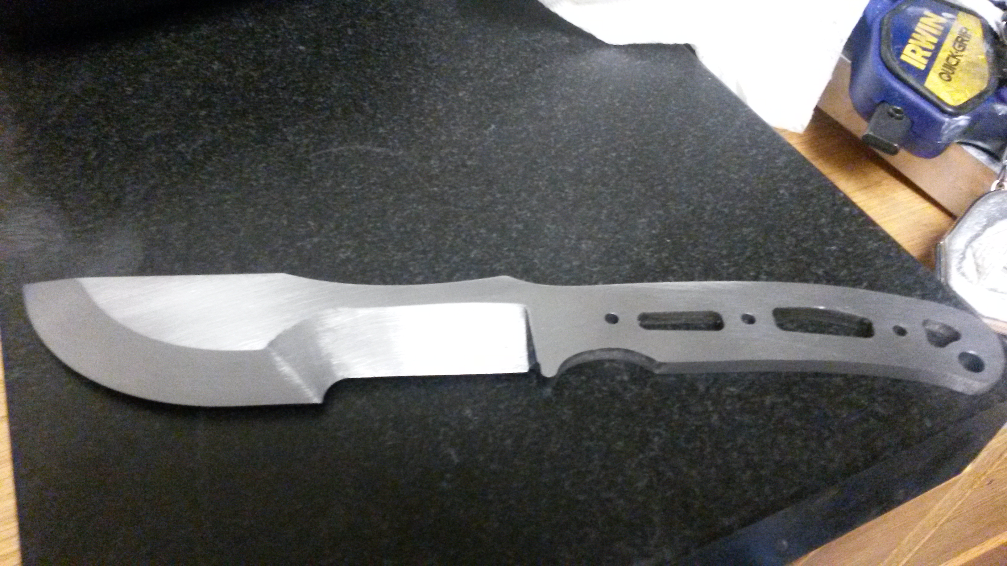

Finished roughing out the bevel on the draw knife portion.

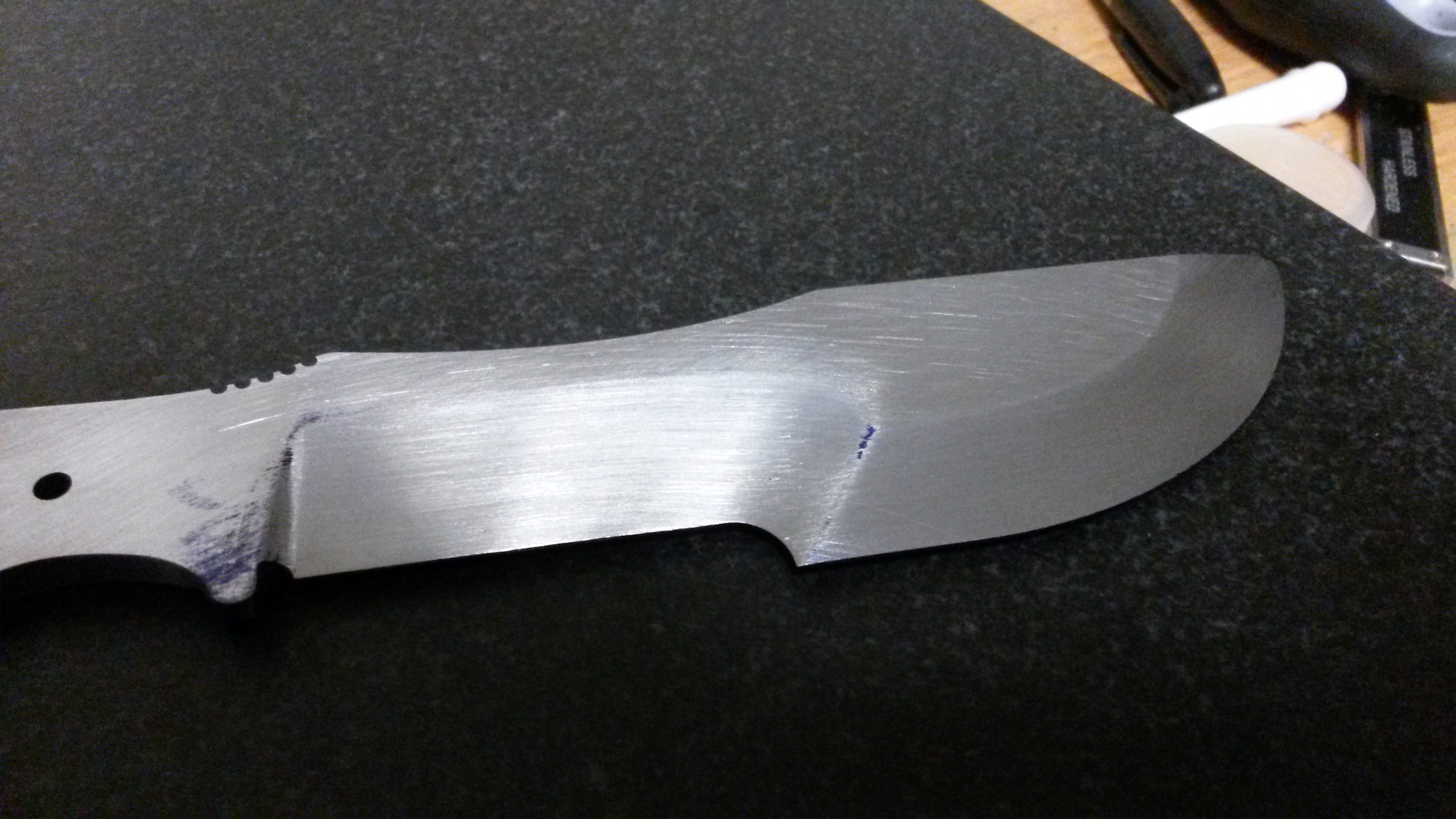

I tried free handing the quarter rounder with a rat tail file and a half round file. The other side turned out alright but this side was pretty gnarly.
I slipped up with the rat tail and half round file more than I'd like, so I'm gonna have to pay for it in cleanup time. Nothing to do but file down the flat until the gouges are gone.
Looks like I need to tune everything up with some more filing, but the bulk of the material removal is done. Grinds are going up higher than I originally planned for to compensate for and clean up some boo-boos, but that doesn't really bother me since I'm more of a full flat ground kind of guy anyways. The edge thickness throughout the blade is around 30-20 thousandths now, so I also still have plenty of room to safely refine the bevels and maybe even sand to 220 grit before HT without having to worry about warp at the edge. Doing the complex curves freehand feels doable, but getting crisp transitions and lines seems to be the challenge. I also have to mill the jimping on the thumb ramp before heat treat, but that's easy compared to all this filing.
Got most of the filing marks out, but some of the pinning and errant marks still hiding

All the deep scratches taken out at 120 grit. I'm a little disappointed that I wasn't able to keep my sharp lines and transitions from the files through the sanding stage. I'm actually considering hitting the flats on the surface grinder on campus to get a nicer transition line.
Coat of ATP-641 before HT. I can see the light at the end of the tunnel on this project, hopefully it'll come out of HT as nice as it goes in.

Penny for reference in the foreground, blade sitting on my surface plate:
I'm a little terrified it's going to snap, but given the abuse I'm running it through right now, I guess at least I'm pretty confident it can be used as a prybar without batting an eye.
