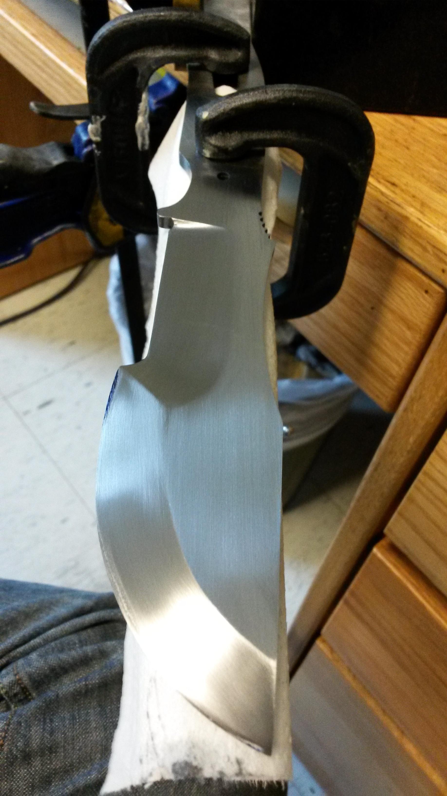

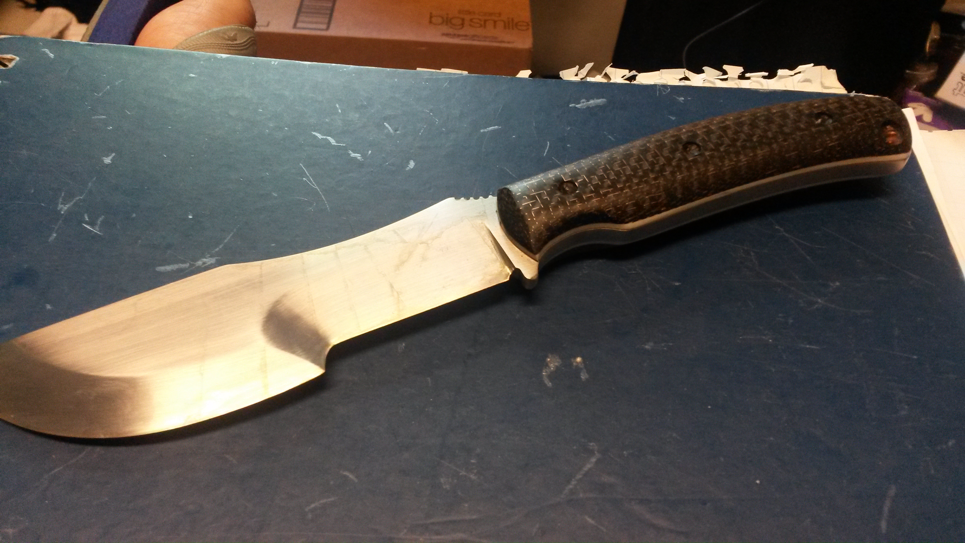

Took the blade to 400 grit. There were some pin holes at 120, probably from heat treating, but I think you'd be very hard pressed to find them amoung the 400grit lines. I need to talk to the customer about what he wants engraved on it. Then it's onto temporarily attaching the scales for handle shaping, off for cold bluing, and then back together for final fit up.
That looks beautiful. I hope everything works out and really appreciate letting us follow you throughout the process.:thumbup:

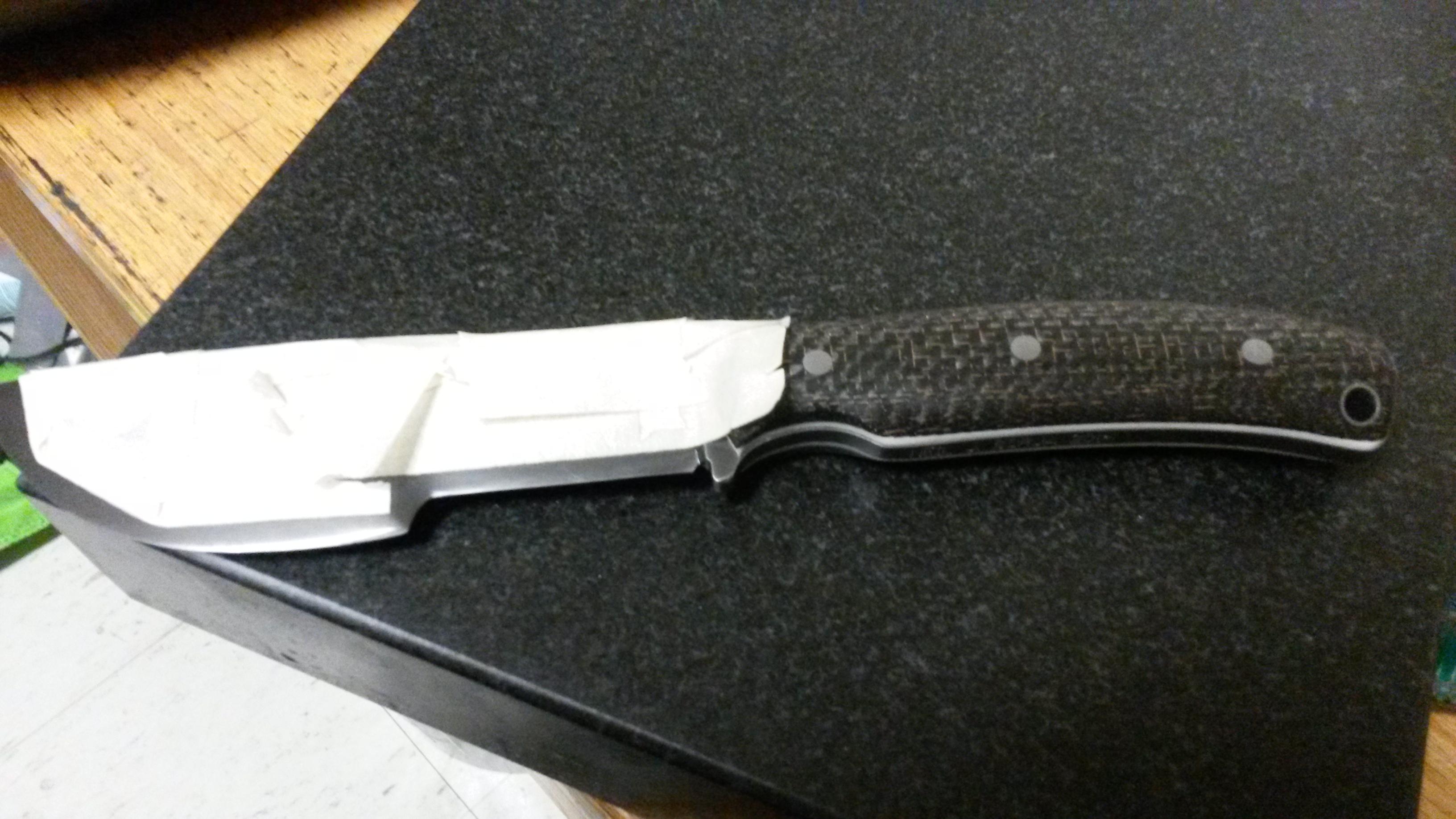

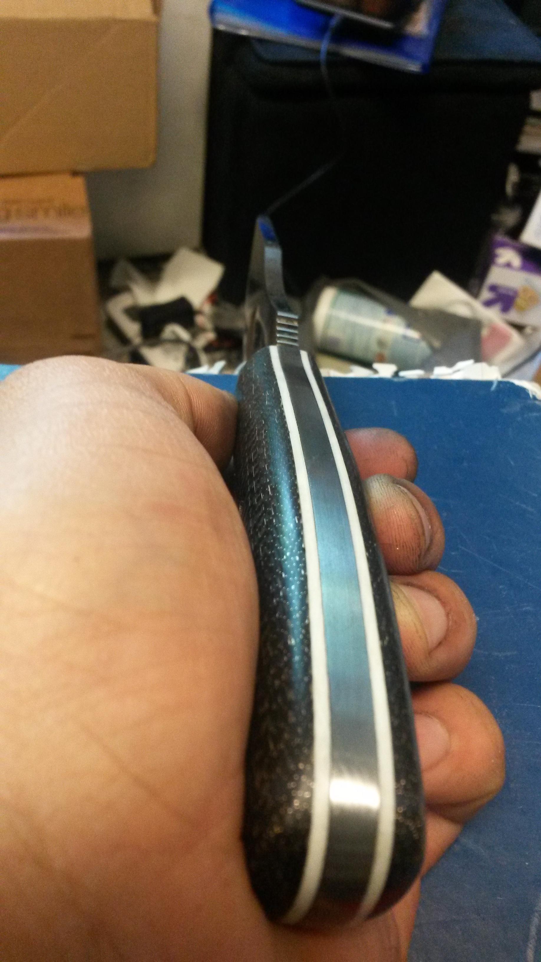

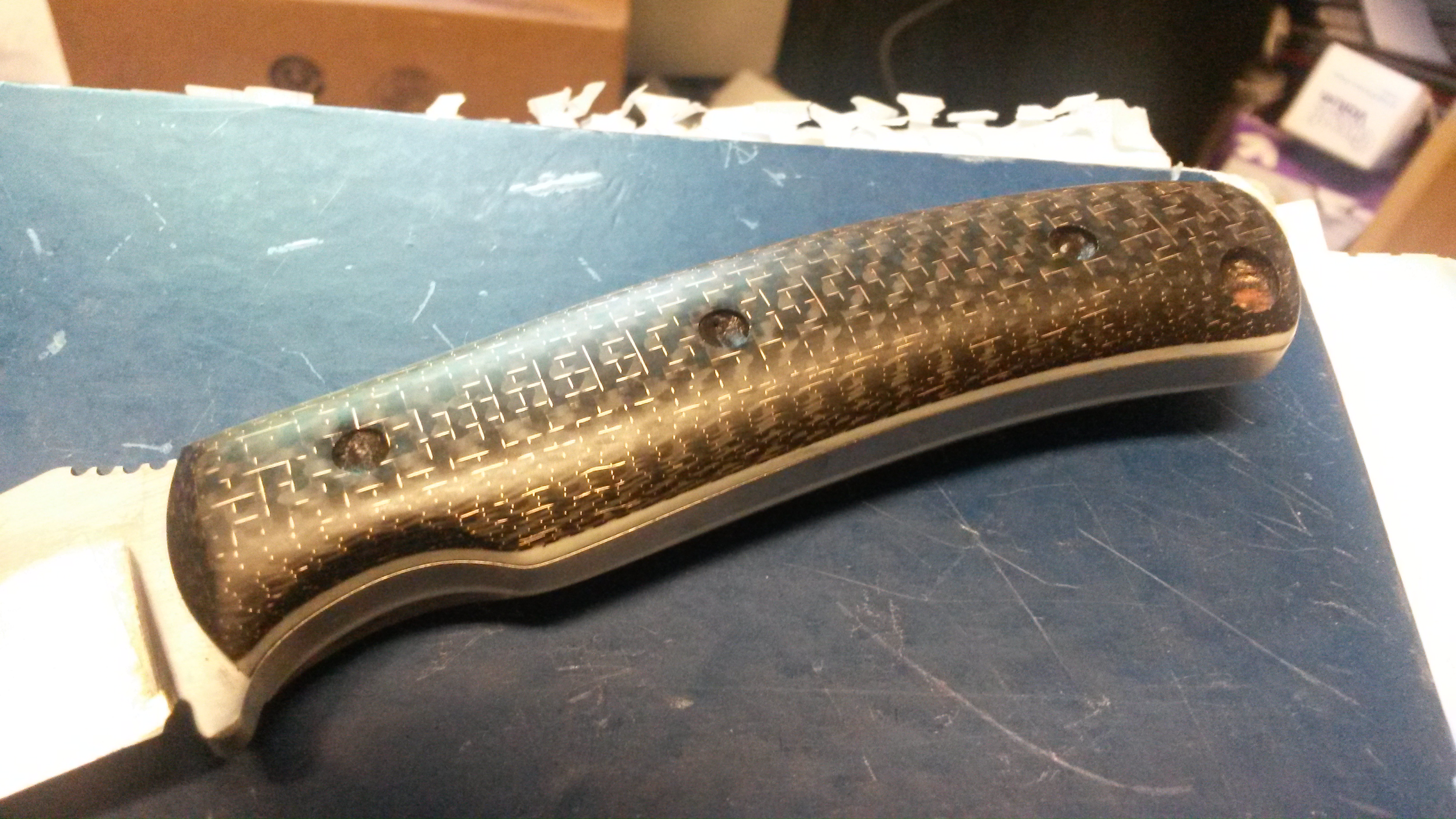

Temporarily attached scales for shaping. The temporary pins were held to the tang with super glue, but the scales themselves are just press fit onto those pins. Took the handles to 400 grit, next step is to punch out the pins, touch up the blade with some more sanding, and engrave it.
I was surprised how small the handle turned out, even though I tried them out every step of the way. I wear medium gloves I think, and any smaller and this handle would be uncomfortable.
well it looks really cool by now, great work. i can't comment on the technical side like hardening, but handle and blade seem to be coming together nicely.

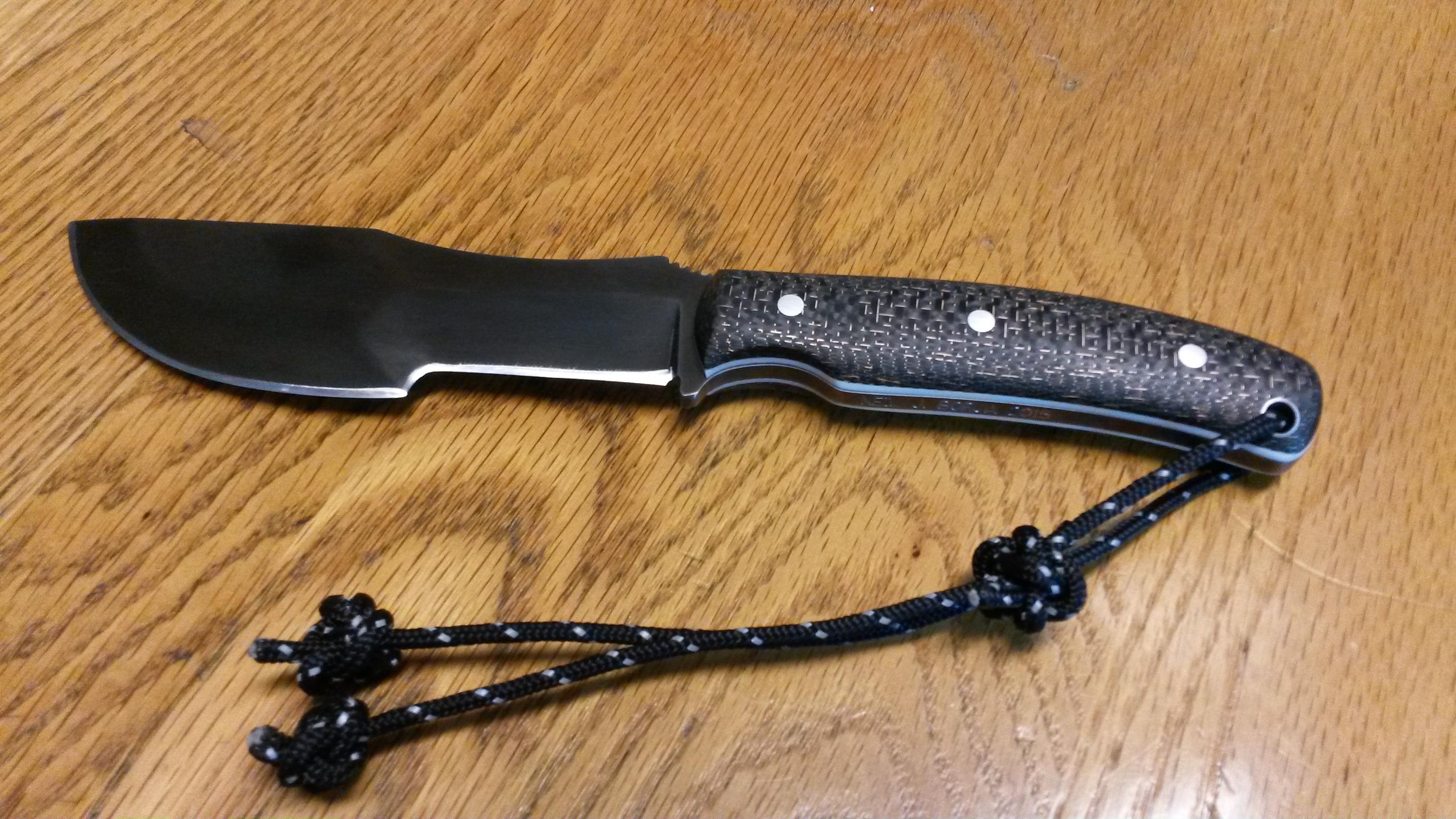

After a couple nights, I finished it up!

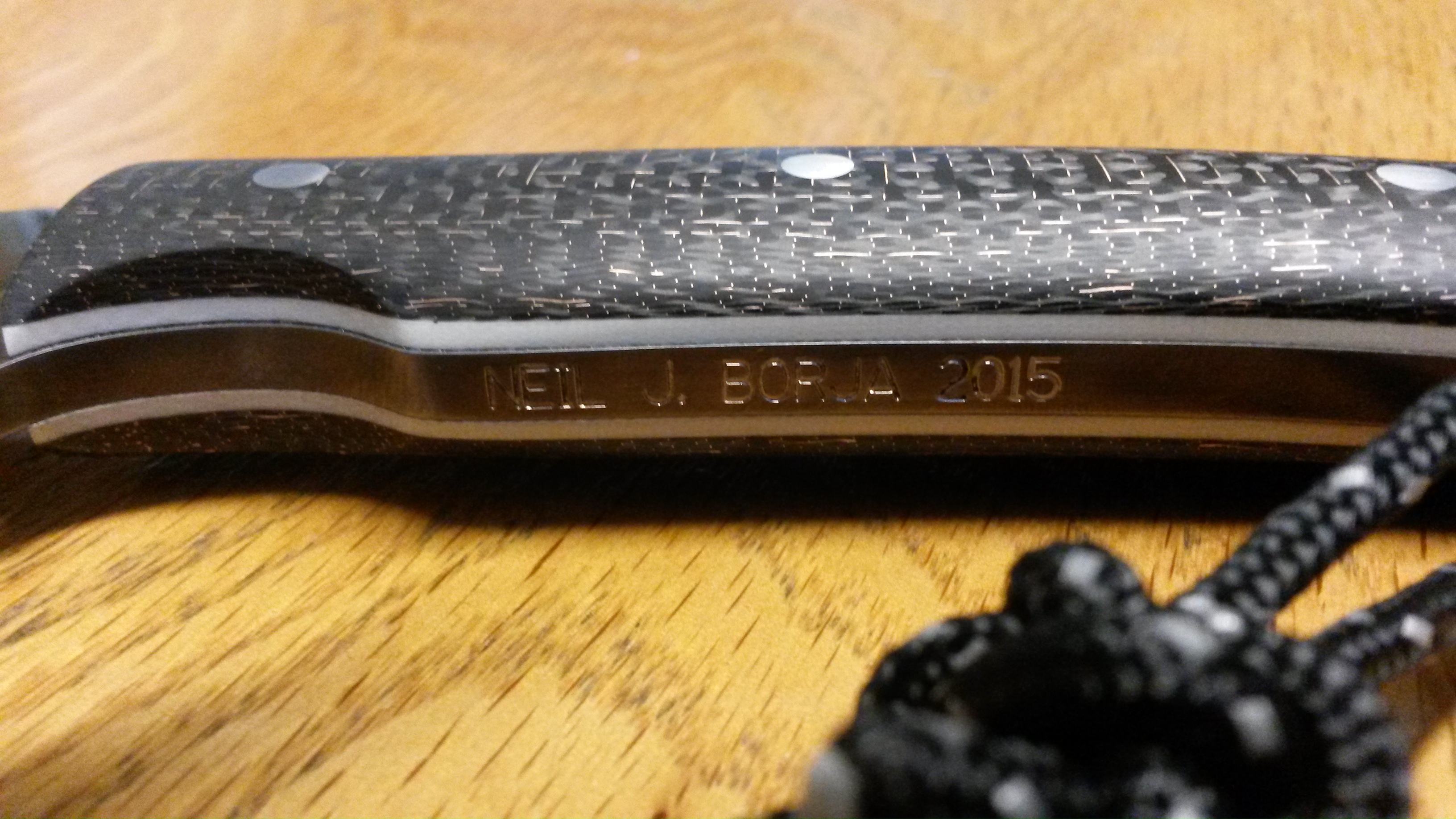

Knocked out the temporary pins holding the scales on and used cold blue on the blade.

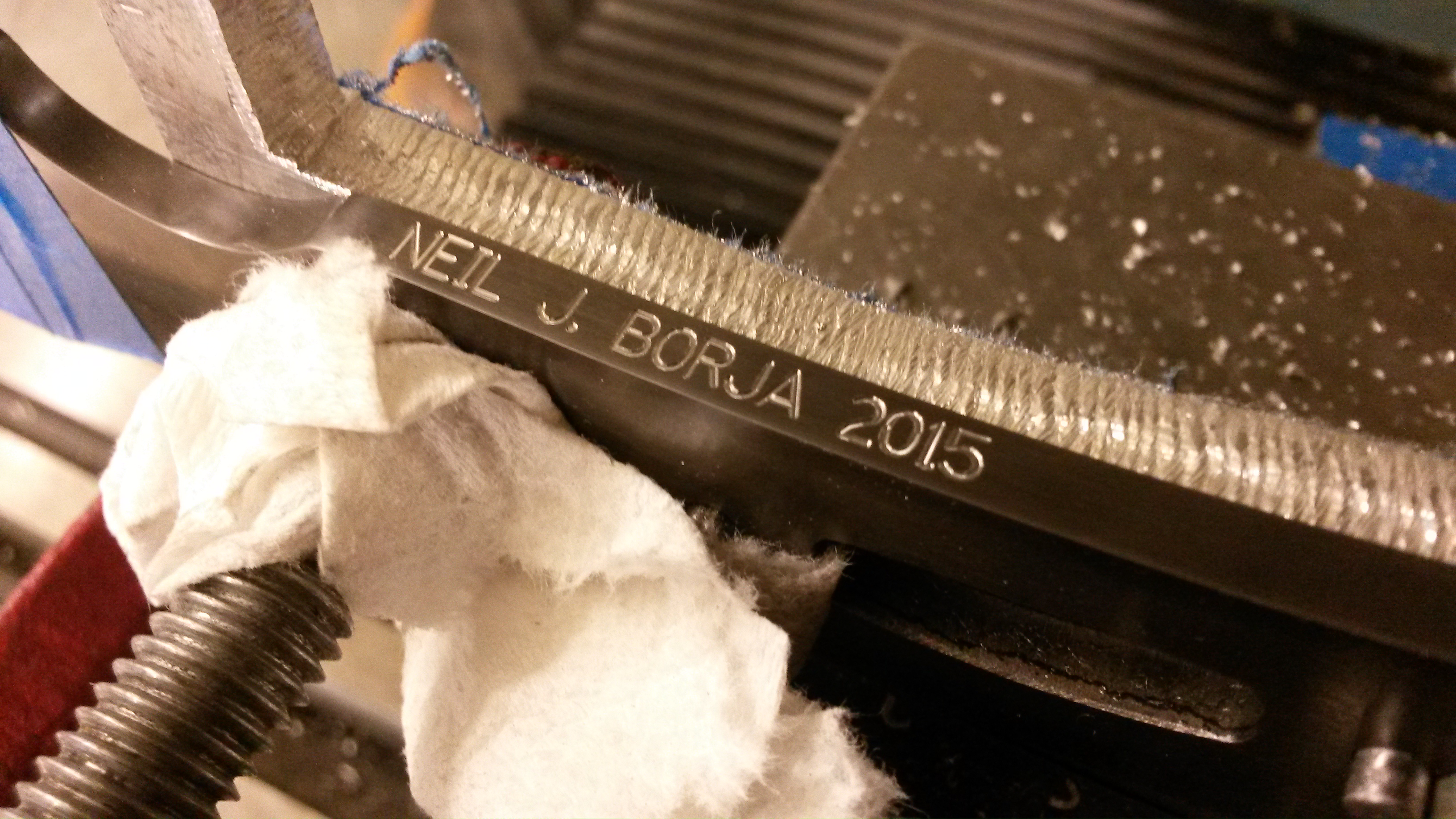

I made a jig for it using some scrap aluminum and used a carbide engraving tool to put my name on it. I was very nervous at first, but it looks like the carbide bit into the hardened steel just fine, and I didn't deviate too much from my initial CAD model.
There was a little bit of trial and error with the Z offset to get it to mark all the letters without gouging fat letters into the high spots. Quite frankly, I was really proud of the bright cut steel's contrast against the blued steel. I was prepared to blue the engraving, but the contrast really surprised me! I also marked the recipient's name on the top of the spine using the exact same process.
After making a huge mess covering everything in epoxy and then cleaning everything up with acetone, I ground the pins flush and took the handle back up to 400 grit. Unfortunately, the handle scales cocked a bit, since the final corby pins and thong tube were slightly different from the temporary pins I turned. Doh! It's not the worst thing ever, but it makes it feel like a badly CNC'd fixed blade with out of spec handles. Blade taped up for sharpening.

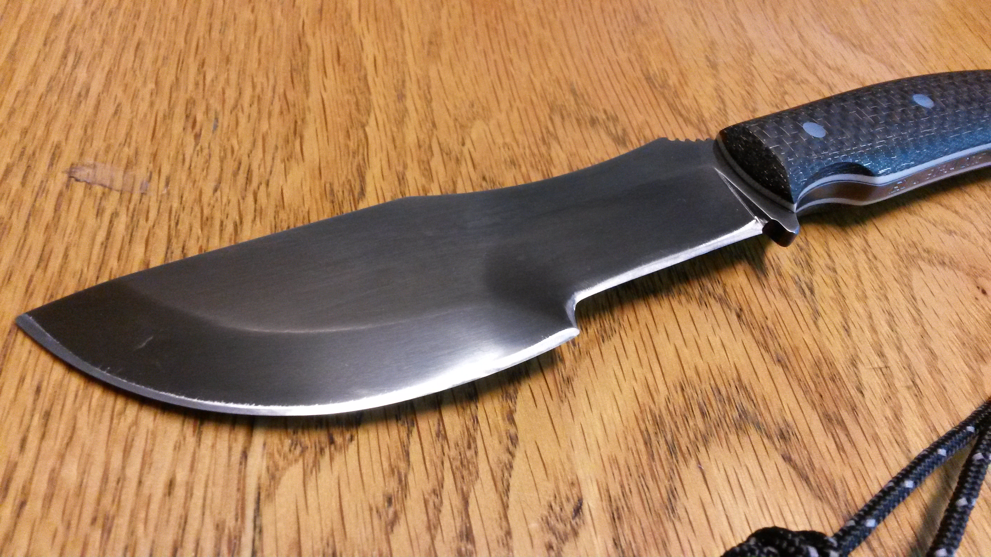

I finished sharpening it with my Lansky right as my morning wake-up alarm went off for a photo finish. I'm still not super happy with the sharpness of the quarter rounder compared to the rest of the knife because of my inexperience with sharpening gut hooks and the like. I put an adjustable reflective lanyard on it too.
Hope you enjoyed my little WIP! Apparently the recipient (customer is one of my university shop mentors who wanted a birthday present for his brother) is an Apache pilot, so I hope this knife is cool enough for his ride :eek: Again, thanks for the advice and support throughout!
I love it! The 1/4 round looks awesome and that's not an easy section to work. The whole thing looks fantastic.:thumbup:
Man that turned out great! .. How many knives did ya say you've made now? ;) .. Love that you blued the blade, it really takes it to another level and goes great with the scales and white liners (perect how the white liners flow right into the "white" edge of the blade like that). Congrats on finishing it and following through to the end and learning from every small mistake, now the next one ya make will be even that much better :thumbup: And thanks again for keepin the thread goin, till the end also. These types of threads really help others learn along with ya and who knows how many makers it'll help in the furure. :thumbup: :thumbup:
