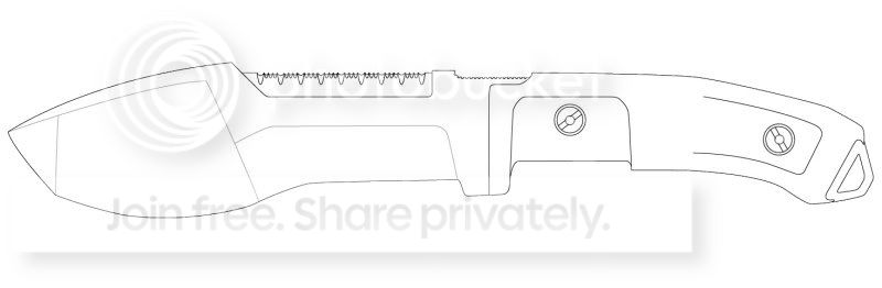

Recently a fellow came to BladeForums looking for someone to make him a WSK/Tracker style knife and sheath, with some of his own design features and preferred materials. My pal Richard J saw the thread and was kind enough to point the gentleman in my direction. He checked out my website, liked what he saw, and after a couple emails, we agreed on all the details. This knife is quite different from anything I've made before, and I'm really looking forward to the challenges it presents.
Quite naturally, the client is eager to see what progress is being made, so I thought this would be a good time to do my first WIP thread. This way, I can keep him informed of how it's going, and hopefully get some tips from y'all to improve my processes.
It's extremely helpful when a client provides you with a clear, detailed drawing to work from:
He wanted a corrosion-resistant steel with high toughness and good edge-holding, so we decided to use Elmax. I have heard excellent reports about this steel from other makers, and I'm excited about working with it for the first time. I ordered a bar from one of my favorite suppliers, Tracy Mickley at USAKnifemaker.com. As always, it arrived exactly as described, in a timely manner. :thumbup:

I am not familiar with either of those brands/models; this is a custom order and I'm working based on the drawing the client provided me. I thank you and Rick for pointing out the similarities. I hope I don't get sued! :eek: :D
The client has requested black canvas micarta for the handle scales. It will be fun and challenging to mill them in the manner he has described.
