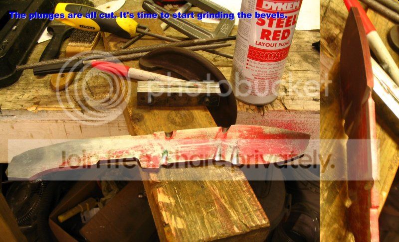

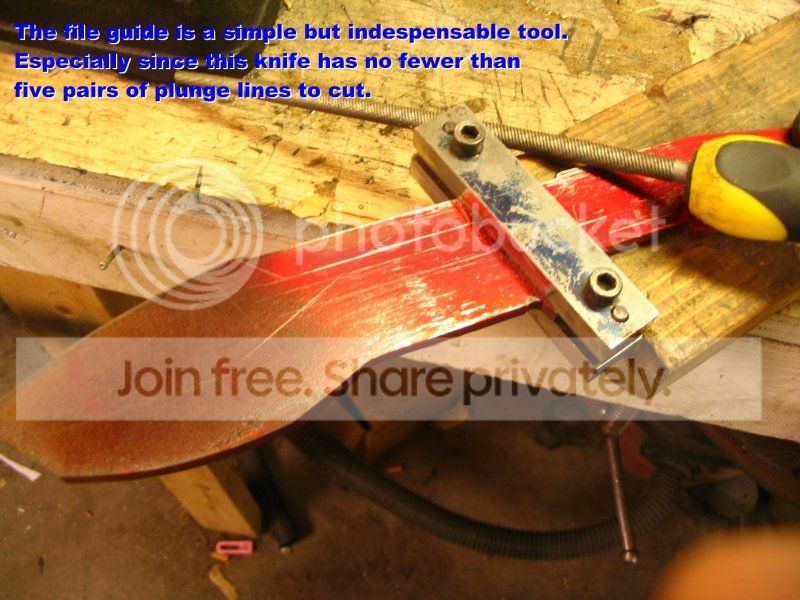

Finally got some shop time on this one and finished another step. Since the compound flat grinds in this design need to start and stop at fairly precise places, I elected to set all the plunge cuts by hand. I start each pair with an aggressive file and clean them up with a smaller, smoother file to clean them up and tighten the radius a bit. Since there are no sharpening notches, I want each plunge to be a fairly small radius to give the most cutting edge possible, but still be smooth and round to avoid stress-risers.
Naturally, cutting with a round file at an angle to the workpiece leaves a groove in the shape of a triangle. So it's important to set the file guide at about half that angle, not where you want the plunge to meet the surface of the piece. Otherwise you would end up with odd-looking placements when you're done with a complex grind like this.

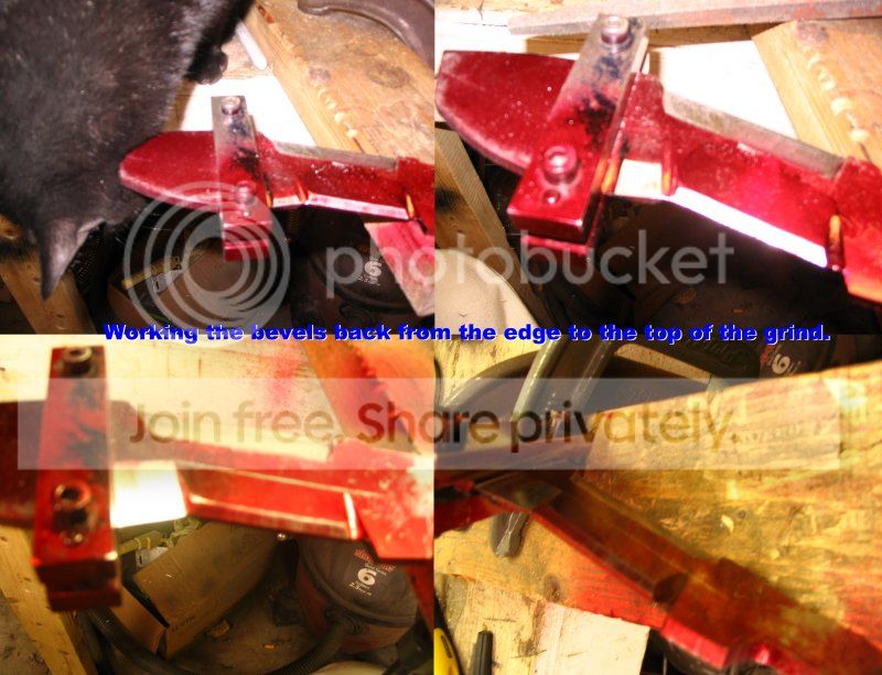

Since the compound flat grinds are so narrow, I decided it was best to cut them by hand with flat and square files. I start by making a 45-degree bevel down to the desired edge thickness, then work it back in facets to the final height of each grind. As always, I start with coarse tools and switch to finer ones as I approach final dimension. It's painstaking work, but it allows me a great deal of control.
These bevels are essentially set, but will need further refinement to remove deep scratches left by the files, and clean them up nice and flat/straight.
