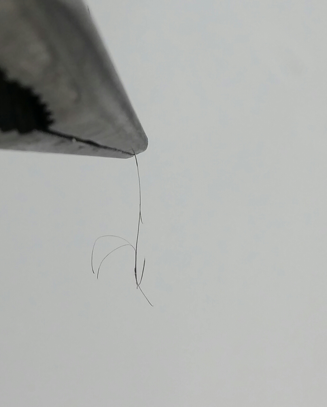

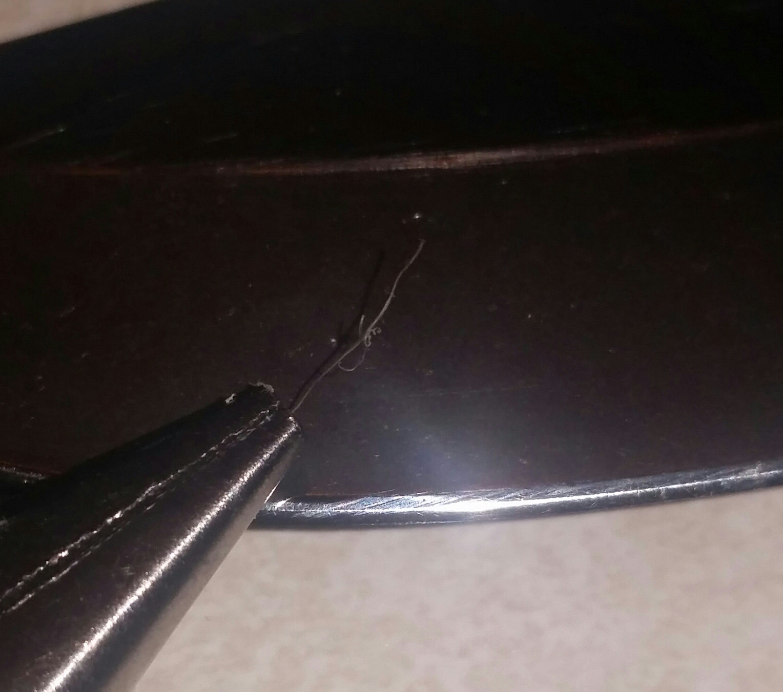

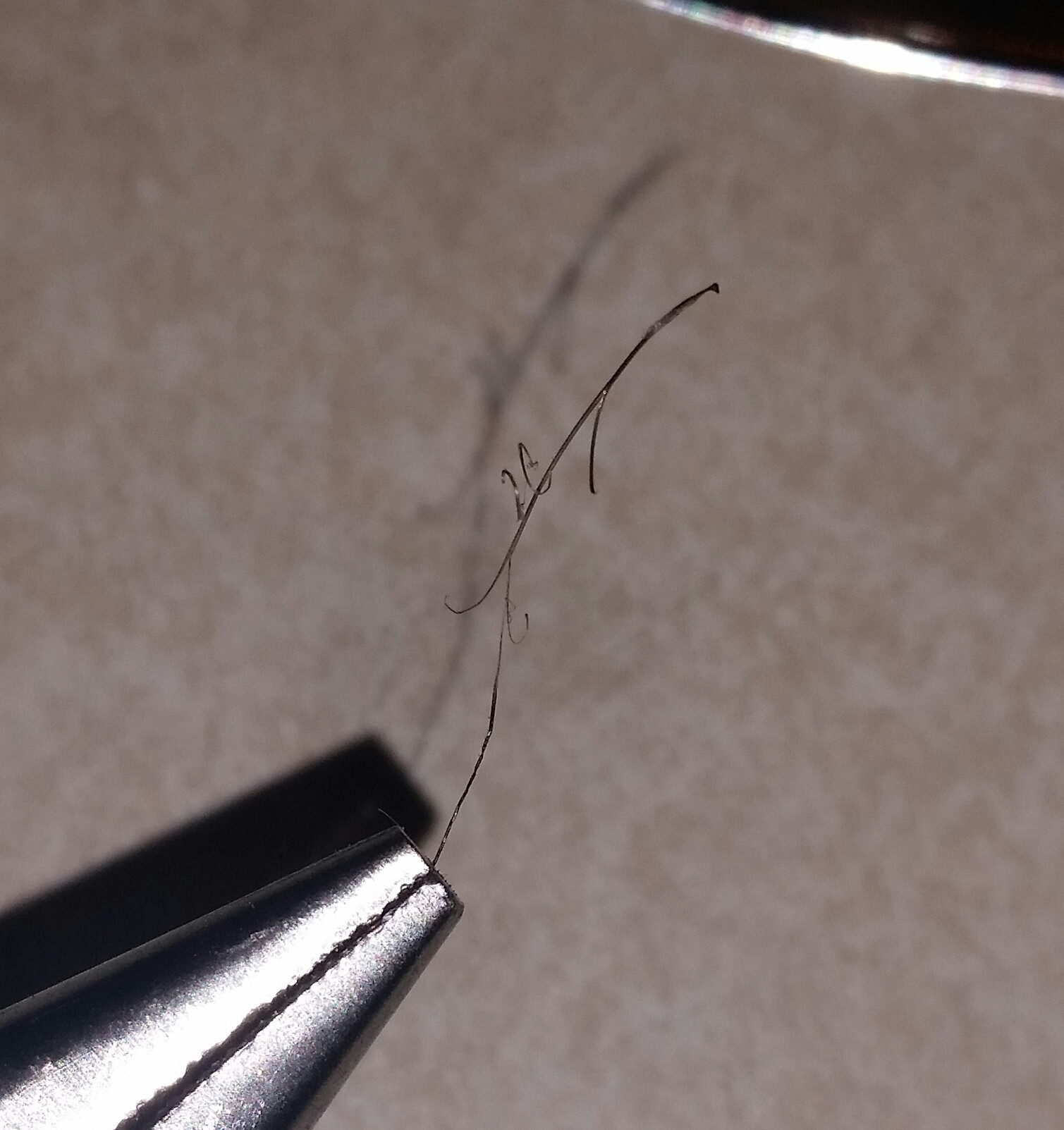

The blade grinding attachment definitely produces a much sharper edge than that of the wskt-ko. While the regular will get a knife sharp it never got my knives hair whittling sharp. With this attachment my knives are sharper than ever, and easily whittle hair. One knife so far is so sharp it can't whittle hair bc it just cuts it in half.
Very impressed with my results from this thing
