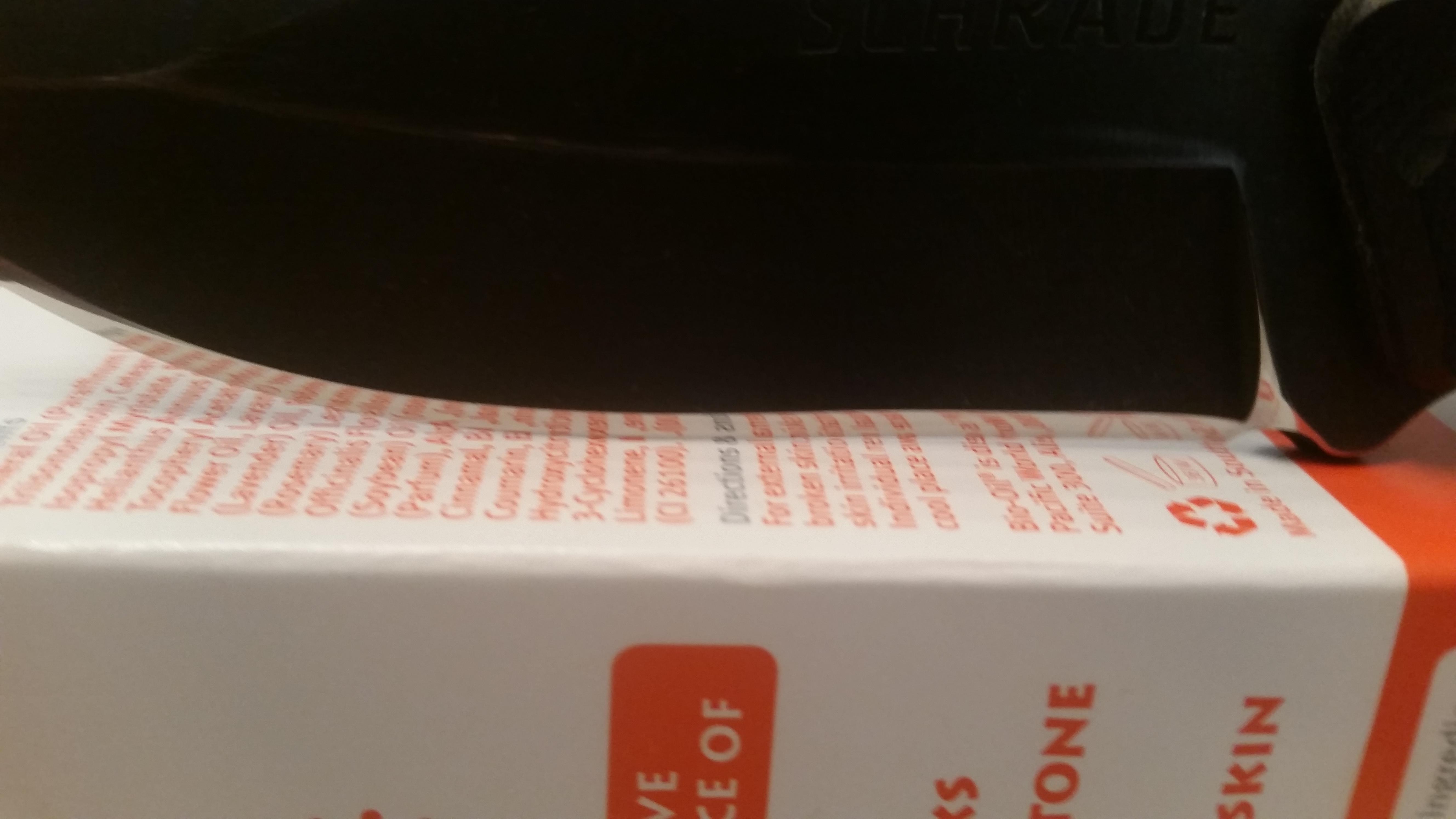

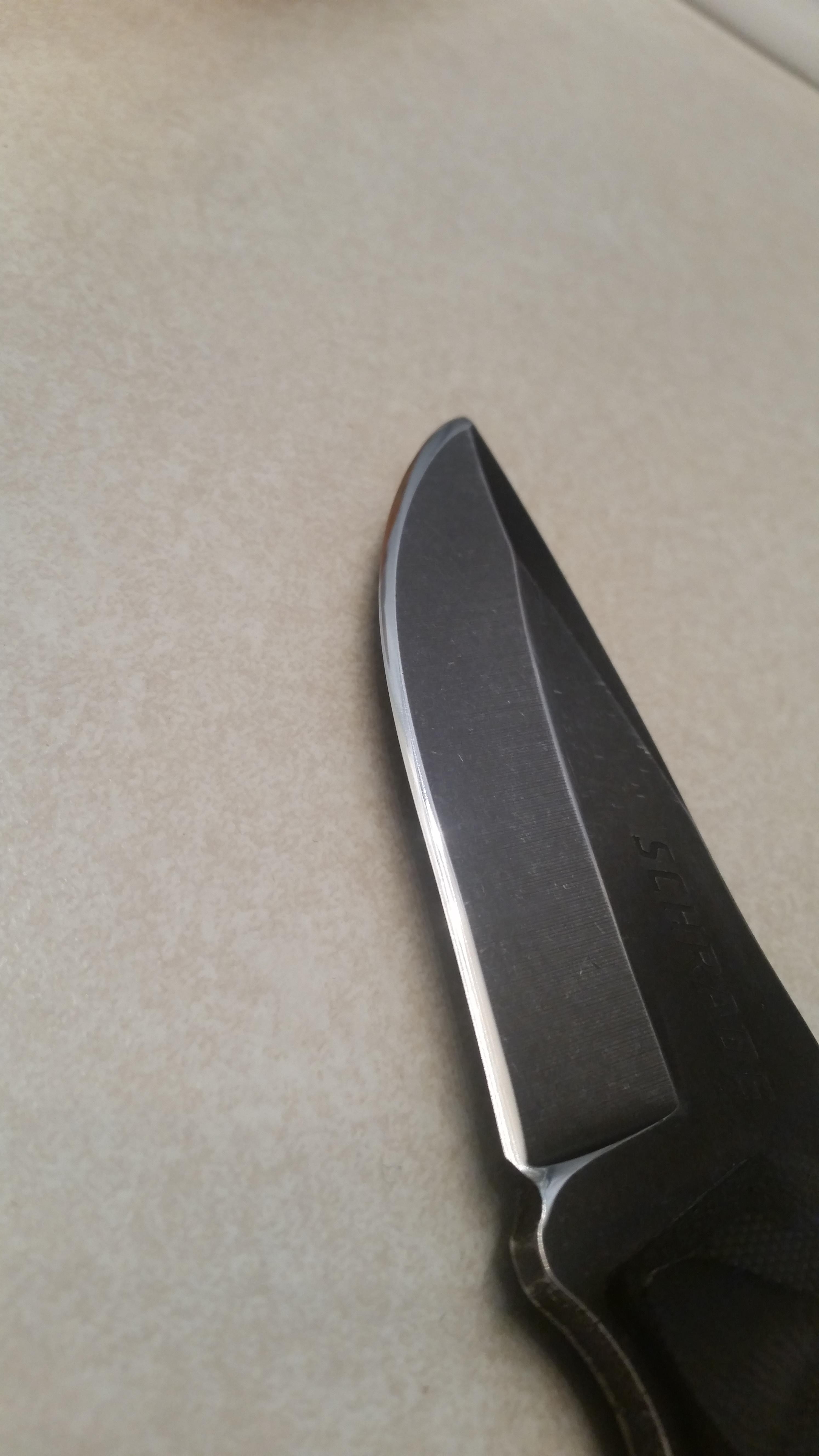

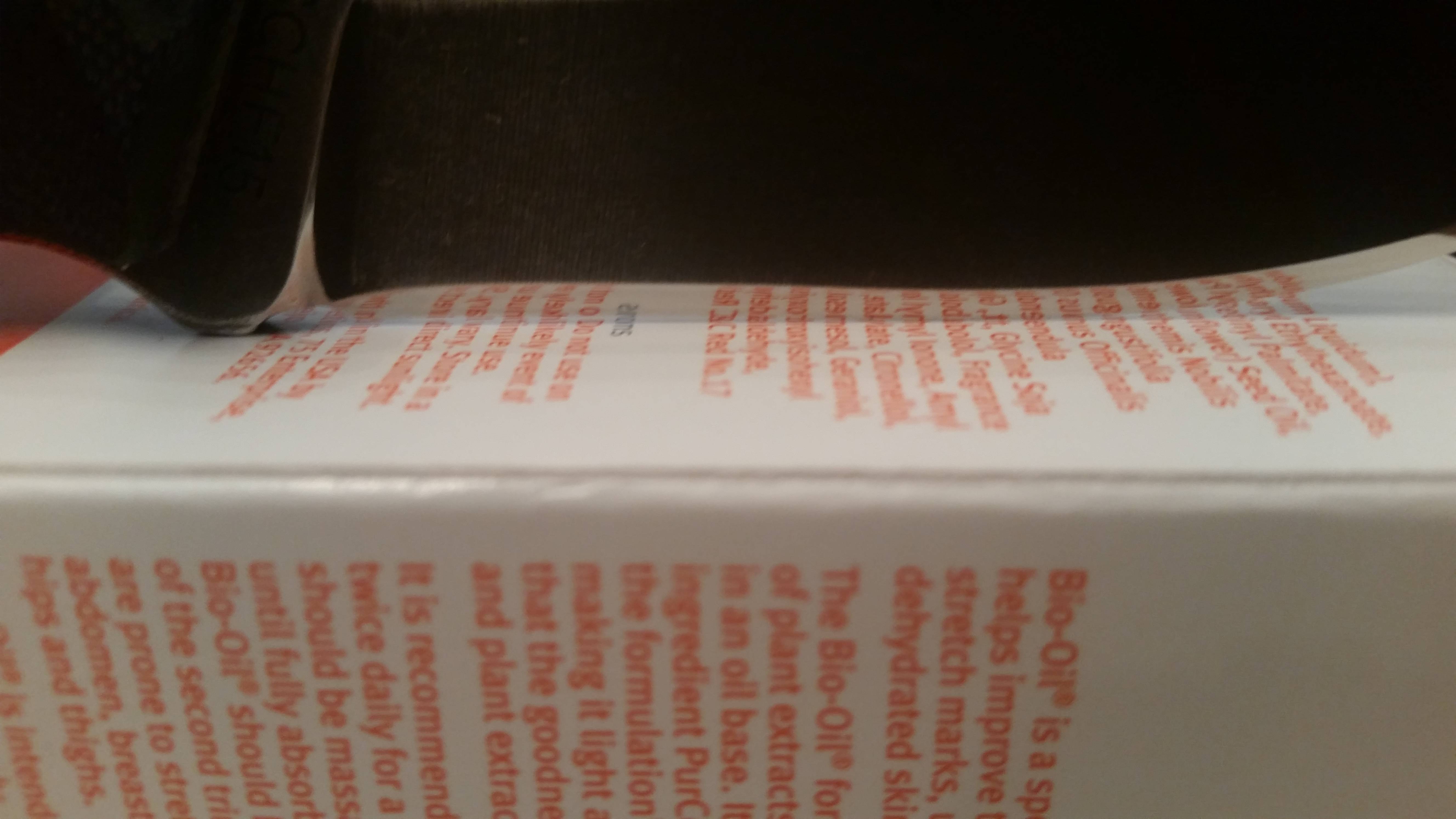

So after having a good bit of time using the blade grinding attachment I've discovered the source of my original discrepancy. One being the spine thickness effected the original ko slightly, but I was tilting forward slightly when approaching the belt..with paying closer attention to my approach the angles are closer together from one to the other with only slight variation in angle oppose to 5+°.

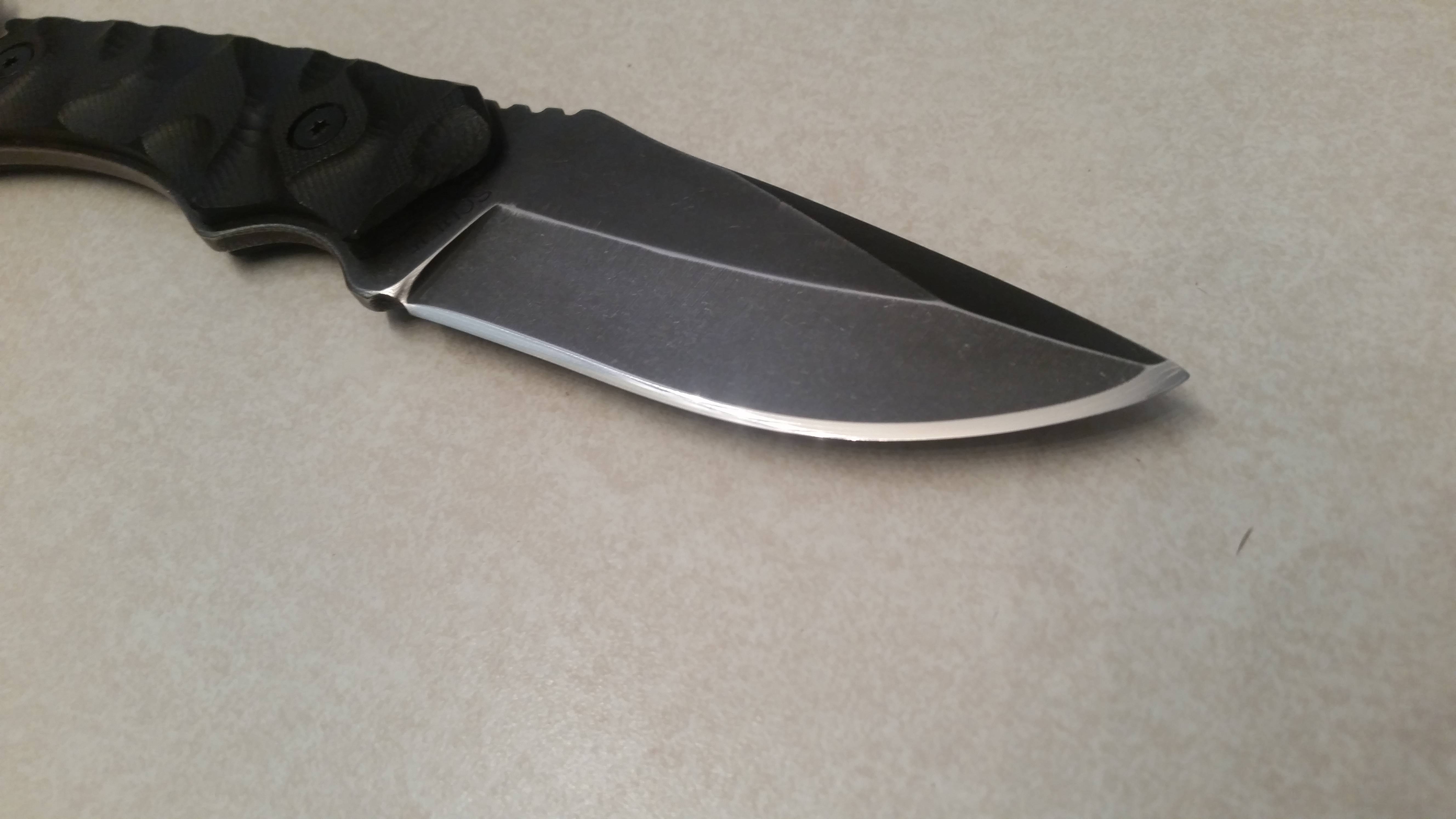

This ones actually 15° per side now instead of 20° like before, by simply paying closer attention.
The results are quite impressive thou compared to the regular ko-wskt. It doesn't get a knife near as sharp as the grinding attachment does.
