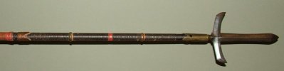

That's odd, not to say I have seen them all, but I personally have never seen a yari mounted in bamboo. I have seen them wrapped in a lacquered bamboo much like rattan.
I have owned a few, as well as toured most major museums and temples in Japan. I own the book, NIHON NO MEISO, Yari, K. Numata, 1964 and though I have not looked through it recently, I can not remember an example shown mounted in bamboo. I may have to pull it from my shelf and take another look.

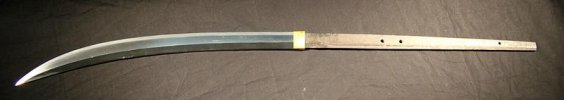

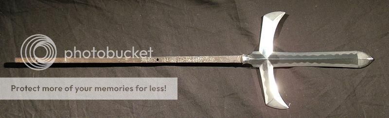

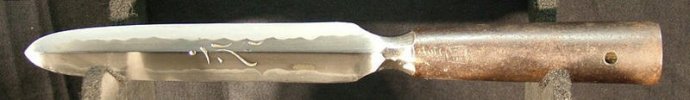

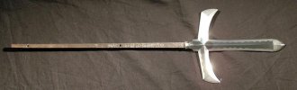

Here are a few photos of yari which you might enjoy as well as get some ideas from for future projects. I have owned sue or omi no yari, fukuro or socket yari, Te yari (sometimes called kago), jumonji yari, sankaku yari, ryo-shinogi or yonkaku yari, kikuchi yari, sasaho yari, naginata, nagamaki, naginta naoshi, etc..
Well, that's the photo limit for one post. If you care to see more, let me know and i will upload some others. I could do a whole post limit on naginata variants.

This one is just wild. It would be a real challenge to build but what a piece!! It would fit right in with the modern tactical grind scene even...
Wow! That's really something!
The one you like is a Jumanji yari. I suspect they would be a bitch to make. They must be a bitch to polish as well as you can't hardly get anyone polish them and if you do your pocketbook will cry.
I have some additional photos of the socket yari shown above, but none that I think will assist you much as far as showing the construction methods of the socket itself.
Yes, I can see where one might think bamboo would be used for yari poles as they do with Yanone or arrows. It basically boils down to physics. An arrow needs to be light yet strong and bamboo is both, whereas a polearm be it yari or naginata must be able to withstand tremendous torque. Bamboo being hollow and easily split simply would not last. The only one I have now with a full length original pole is a jumonji yari which sits atop an 8ft. Oak pole with a one inch diameter. (the one in the rattan example).

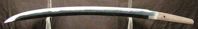

Here are a few more, from top: Te or hand yari(42" overall), Kikuchi yari(cut down tang to make tanto), Nagamaki, Naginata Naoshi, Naginata.
