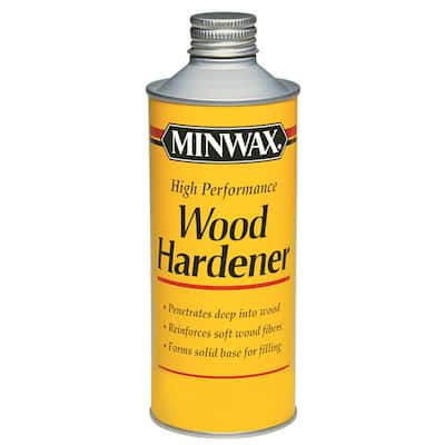

As for the wood part, I've seen plenty of solid hardwood floor warp, it's better to get them stabilized, the process is infusing resin into the grains via pressure chamber or vaccine chamber, the end result is you get the same wood in close to twice the weight and it will never deform
Thanks for that info! I'm not into guns so I had no idea that kind of metal treatment existed. Gotta get me some to play with. Does it only work on carbon steel? It looks clear like some find if acid?
yes, there are several 'grades' that will blue different grade/harder carbon steels but there is nothing in their line that will blue any Stainless steels.
Yes it is a caustic material that is corrosive. Wear gloves, eye shields and a mask/respirator.
I can build a vacuum chamber using a pickle jar and a brake bleeder and use wood hardener if needed.

Many woods that are oil laden don't stabilize well. I'm not sure if any of those qualify, but if they do I'd go that route.

Rosewood for me. However doesn't wood stabiliser rule out an oiled finish? I would have thought it would stop the oil soaking in.

Not sure if I'm going to stain it. If anything, after I stabilize it, it will get a beeswax/BLO/turpentine coating [waterproofing] that will probably not stain it. If I waterproof it before hand, it won;t stabilize because the pores will be filled with wax n stuff.
...although....I know for a fact the waterproofing agent will prevent any kind of water absorption...so stabilizing would be a moot point in that respect...
