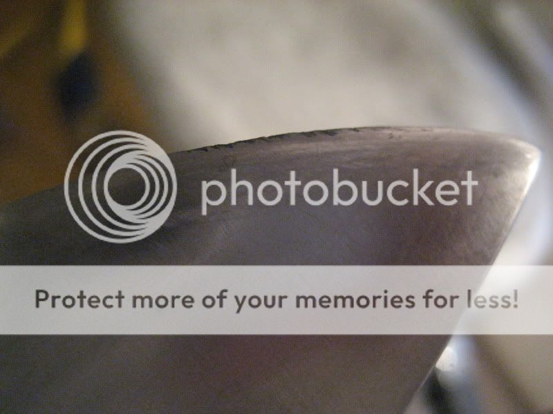

Well being that we're talking about using my BM LE... Tell me how to fix this. Its not really rolled... sort of dinged I guess. Its right at the top curve of the belly. Very fine, you can hardly feel it, but I think you can see it.

A high quality butchers steel will pull it back into place.
Use the steel lightly, the opposite direction you use it on kitchen knives.
After it's re-alighned I would strop with fine grit:thumbup:
remember it is a zero edge full convex grind:D

Opposite way? Normally you start from the base of the knife and steel and wave outward, right? Come on Scott... you know I'm slow. :D I've only been mouse pad sharpening and stropping it being that its convex. No diamond stones, right?
When you normally align an edge you cut towards the butchers steel,
to pull INFI back into place go the other direction.
Finish with a swipe or two the traditional direction:thumbup:

The physics of that makes sense. If you're chopping the same direction you normally use the butchers steel, then you're moving metal toward the tip of the blade. To push it back, work it the opposite direction. :thumbup:

As to the edge damage. Spend a bit of time with a steel like others have said. I did some nice dings to my edge, and I really thought there was no way I was not going to have to spend hours and hours on it to reprofile the edge. After some light steeling, it really took about 3 passes per side on a medium diamond stone, then a quick strop and good as new. I was amazed at how much edge I was able to push back, and more so, that it never failed at that spot with more really hard use, with side pressure, and prying etc.
