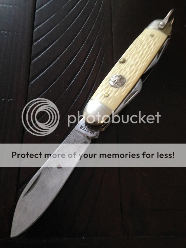

Happy to find it of course, but unhappy it was in this condition. (did you know about carbon steel when you were a kid?)

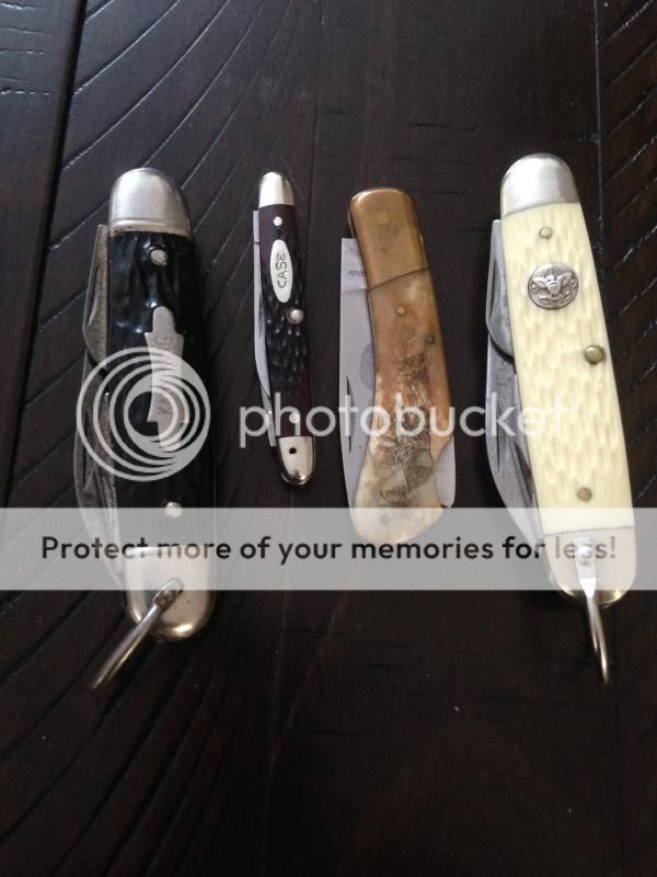

So, out with the Dremel. I remove the rust from blade and bolsters, oil it up good, and left it to sit. As you can see it cleaned up nicely, and opens quite smoothly now. Not much rust in the liners I guess, thankfully. I really like the patina that came over it. You'll notice some marking on the blade, mark side. I don't know what it is, but it's smooth to touch. I'm now going to sharpen it, and it will then have been fairly restored and put in it's right full place. In another box! A cigar box this time though, and with it's extended family.

The knife you show appears to have celluloid covers and as I looked at the blades, it appeared that knife has/had been gassing. I just wanted to alert you to the possibility and if so, the knife would be better kept in a box by itself, to protect your other knives from doing the same.
