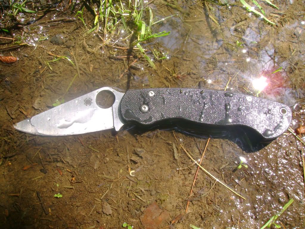

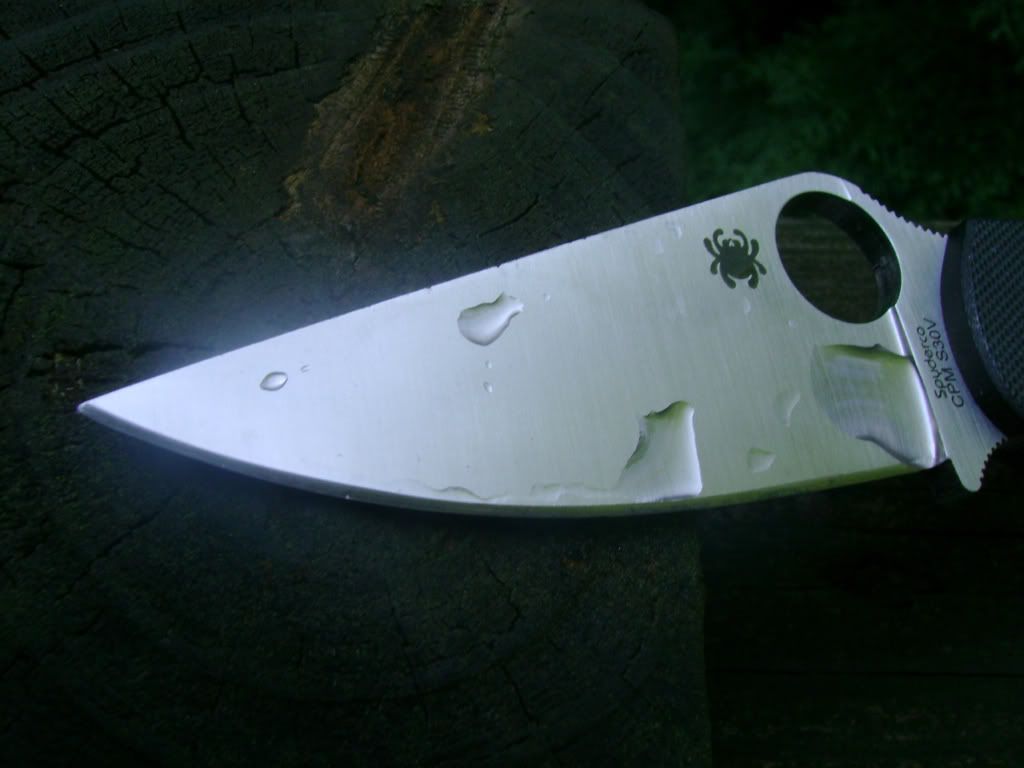

I've beat on my Para for quite a while now and it has held up exceptionally well. It has seen work duty, camping duty, EDC duty and has done everything that I have asked it to. I'll give you some of my Pros and Cons that I have come up with after using the knife for a while.
Pros-
- Great handle design. Big enough to be hand filling but flat enough to not feel bulky in the pocket.
- Flat ground blade is a great cutter.
- Premium blade steel with either CPMS30V or CPMD2 option.
- Open design is extremely easy to clean.
- Compression lock can easily be opened and closed with one hand.
- "Grippy" G10 slabs that stay grippy even while wet.
Cons-
- Alot of the knife sticks out of the pocket when clipped. (Not a negative for some as it makes it easy to get into use.)
- Blade tang sticks out pretty far from the handle when closed. (Kind of a pet peeve of mine.)
- Tip down carry only. While I don't always consider this a negative on this knife I do. Having a lanyard hole on a knife where the lanyard will be buried in the bottom of my pocket is not how I like my knives to be carried.
I will say overall the Para is one of my favorite knives along with my Benchmade 520 and CRK Small Reg Sebenza. There are others I like too but these three are the ones I always seem to be carrying.
Here is a couple of pics I already had uploaded. Nothing like some SpyderPorn. On the last pic you can see the gouges on the spine from striking on a firesteel.
