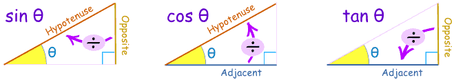

Details:
Thickness of the edge shoulder: .55mm (0.021 inch)
Divide by two to get the 'opposite' side of the angle you want to determine, therefore: .275 (0.0108 inch)
Length of edge: 2.07mm (0.081 inch) 'Hypotenuse'
Then apply some maths with SIN and one gets to 15.268 degrees inclusive.
Devide by two and you get 7.6 DPS.
Feel free to correct my maths if I am wrong. I do not work with maths as much as I use to.
Your math appears correct. The only possibly rub could be how the edge was ground. If it is convex, the effective angle could be quite a bit larger than the grind lines would indicate, the edge would be stronger also.
Either way, it appears you are testing and finding what works best for you...that is all that matters.
