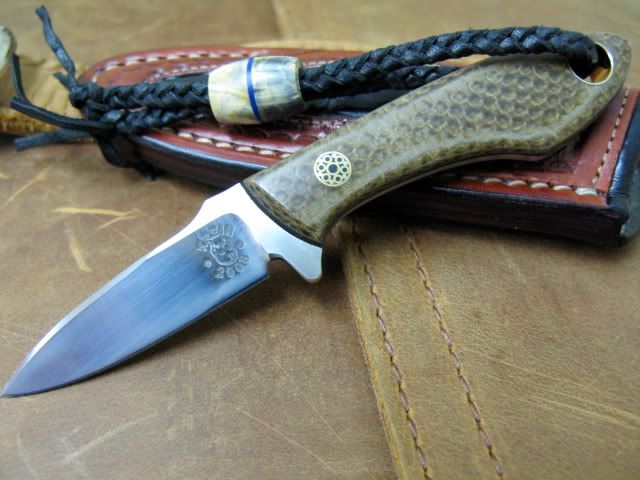

I find that Tom Kreins small fixed blade knives just disappear in the front pocket or the back pocket when carried with either the Paul Long sheath or the kydex. Here are two that are my favorites.
The first is a TK-1 that in my personal opinion is just a fabulous knife for daily carry. Pictured with Paul Long sheath - leather with alligator in-lay; and Fuzzy Lanyard
