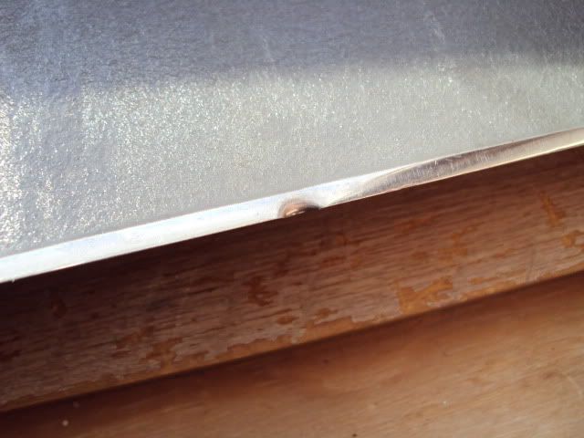

I prefer a zero convex and my knives will usually develop a very slight micro bevel from time to time. If it is ground too thin the edge will dent or chip, but it is faster to make an edge a bit sturdier than it is to remove a secondary bevel. Bark River sometimes go a bit thin on their edges and I've had a Northstar in A2 where the edge folded, but it would just glide through everything. After increasing the angle a bit on the edge it has been good.
