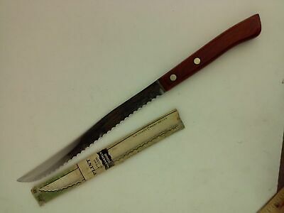

I think a Flint Waverly edge like this made by ECKO could be a good fit.
It's got a hardwood handle with 2 rivets, it's could serrated edge could have it confused with a bread knife, they're about 3/4" wide,and the one I used to have from my grandmother did have a swedge on the spine which could make it look like it's got a double edge.
To my knowledge the longest this pattern came in is about a 10" blade but that could be mistaken for 12".
