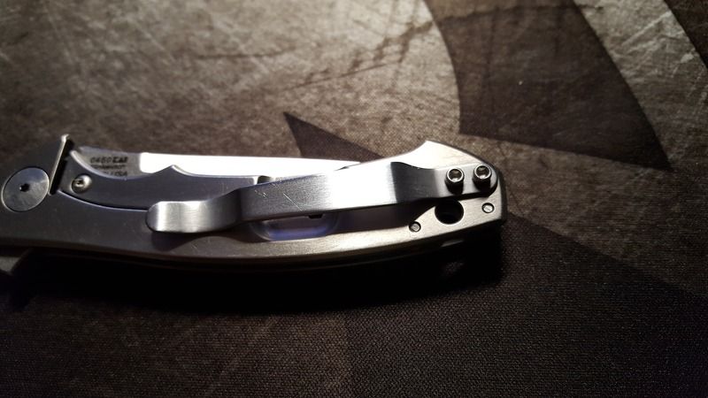

Is the issue due to a too large screw hole on the clip (could be both holes)? I am just guessing.
Yes the holes are way oversized compared to the screws thread diameter. Besides all the rattling and swaying the clip does when loosened, there probably is not much traction for the screws to hold the clip when tight based on the oversized hole diameter. I will see if its a faulty clip when I get the new one from ZT, but will try blue locktite as recommended by ZT in the meantime.
It indeed is a design flaw, however minimal. Simplest solution is to replace the standard button/pan head torx with either flat or socket head torx. The flat heads have a wedged bottom to make up for the larger clip holes. Socket heads can tightened with better strength, less prone to stripping, plus they look cool.
I too prefer the standard clip on the 450 over the deep pocket which just looks really odd just hanging out there.
The clip doesn't move, can't be pushed, in case you are wondering.
Where did you order the flat or socket head torx screws?
Yes, the large holes on the clip are the problem. A milled in pocket for the clip to screw into would also solve the problem. I used blue loctite on the threads and heads of screws, as recommended by some members and ZT customer service. This has taken care of the problem so far, but dont like the fact I have to rely on loctite to make my pricey folder function correctly. I could not flip this knife open when the clip went over the lockbar, it caught me off guard and is a big deal. Loctite is not a solution for the problem IMHO, its a design flaw thats an easy fix. ZT also sent me a clip and new screws. The clip is silver and not for the 0450cf that I own and the holes on the clip are the same diameter

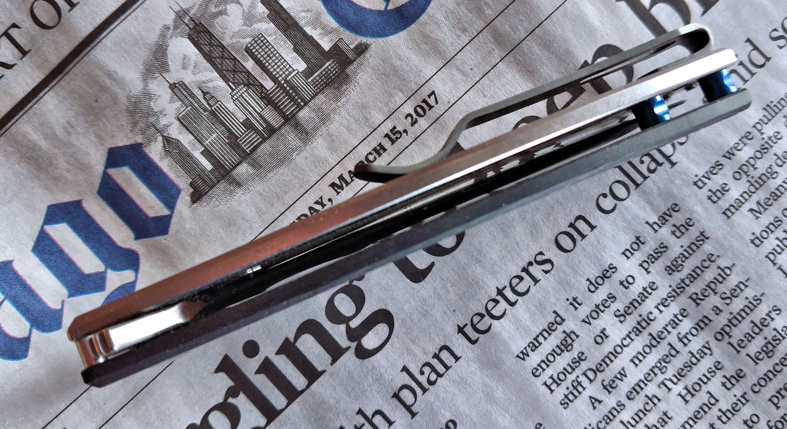

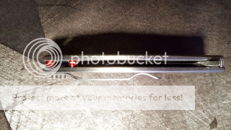

It does seem like a design flaw; both of my 0450s had the wiggly clip issue, even with the screws as tight as I could get them. It annoyed me so much that I put a deep carry clip from fleabay on my 0450cfzpd, which solved the issue. The downside is that I liked the original clip better, it lay flatter. The deep carry clip is obnoxiously large, though it doesn't feel bad in hand because the 0450 is so thin:
Great knife. I had to sand all the obnoxiously sharp spots on it to make it perfect (breaking the spine edges of a zdp-189 blade takes a surprising amount of effort) but I love the little bugger now, obnoxiously large fleabay clip and all.
