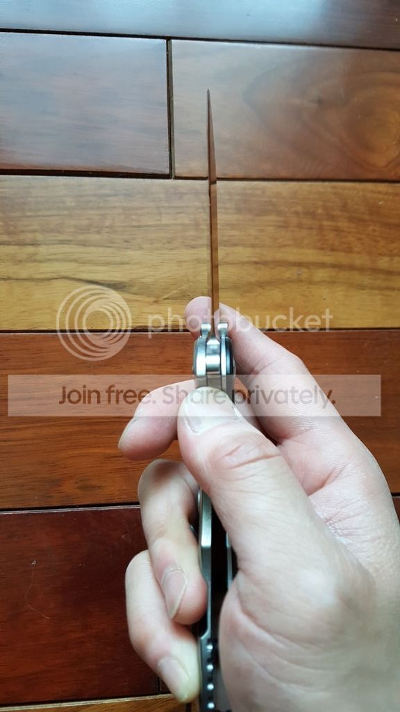

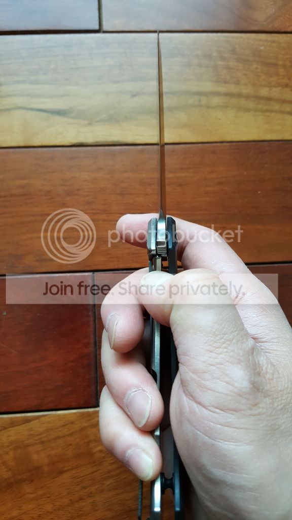

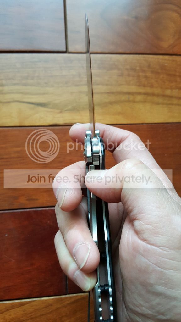

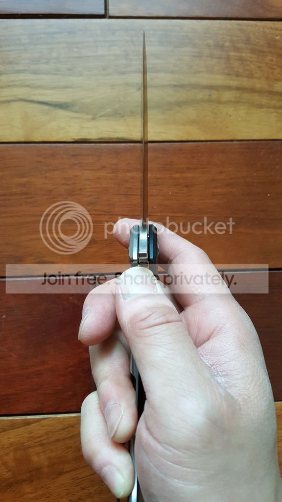

OP - I took some pictures showing how to properly unlock ZT 0452 and ZT 0562. It is relatively difficult to disengage the lockbar with the technique showing in the first two pictures (one for ZT0452cf and the other ZT0562cf), whereas the technique in the last two pictures makes it easy. Pay attention to the angle of the thumb (and nail) pushing the lockbar. (I also have videos showing it but don't know how to embed them).
Difficult
Easy

That is the exact way I was trying to put into words SE! Both of mine are very easy to un lock when using this technique. I close all my frame locks this way.
Great pics!

Great examples...pretty much sums it up for those with issues.

@Chazzip. Thank you very much for taking the time to take these pictures. That was very kind of you. The problem is that it just does not seem like natural grip for how I hold all my other knives. I wear a large to extra large surgical glove...the 0652 just may not be for me. I returned the 0452 because the lockbar all too easily over traveled and prevented closure.

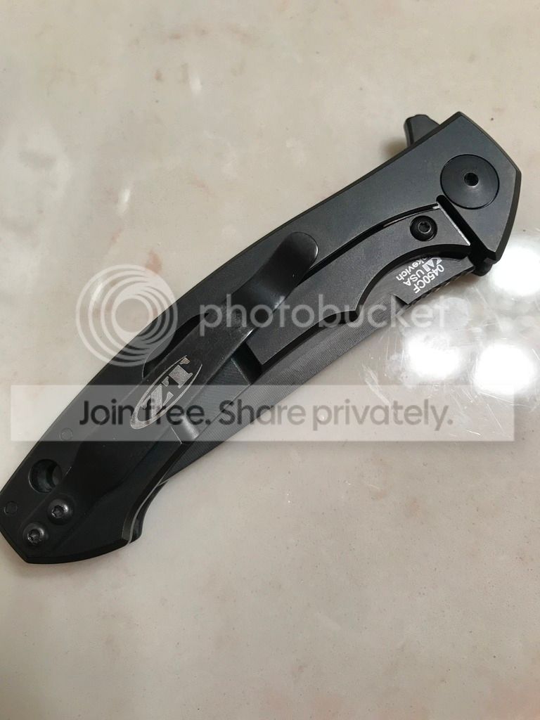

No no just loosen the 2 screws that hold the pocket clip in and slightly turn the clip off of the lock bar..like this:
I'm only going off of google images as I've never owned the 0652 but it seems like ZT likes to have their pocket clips rest dangerously close to their lock bar on most models..
I looked at the knife and I thought about it and you are most certainly right. I tried loosening the clip but there is no way to get it totally off of the bar. What is interesting is how much easier it is to close with my left hand because the rest of the fingers are on the CF scale...nont on or near the lockbar....and the thumb is angled in such a way it is easier to move laterally. For a right handed person the right scale should really be cut much deeper IMHO.
