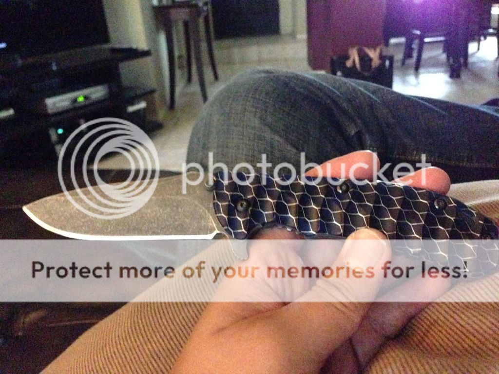

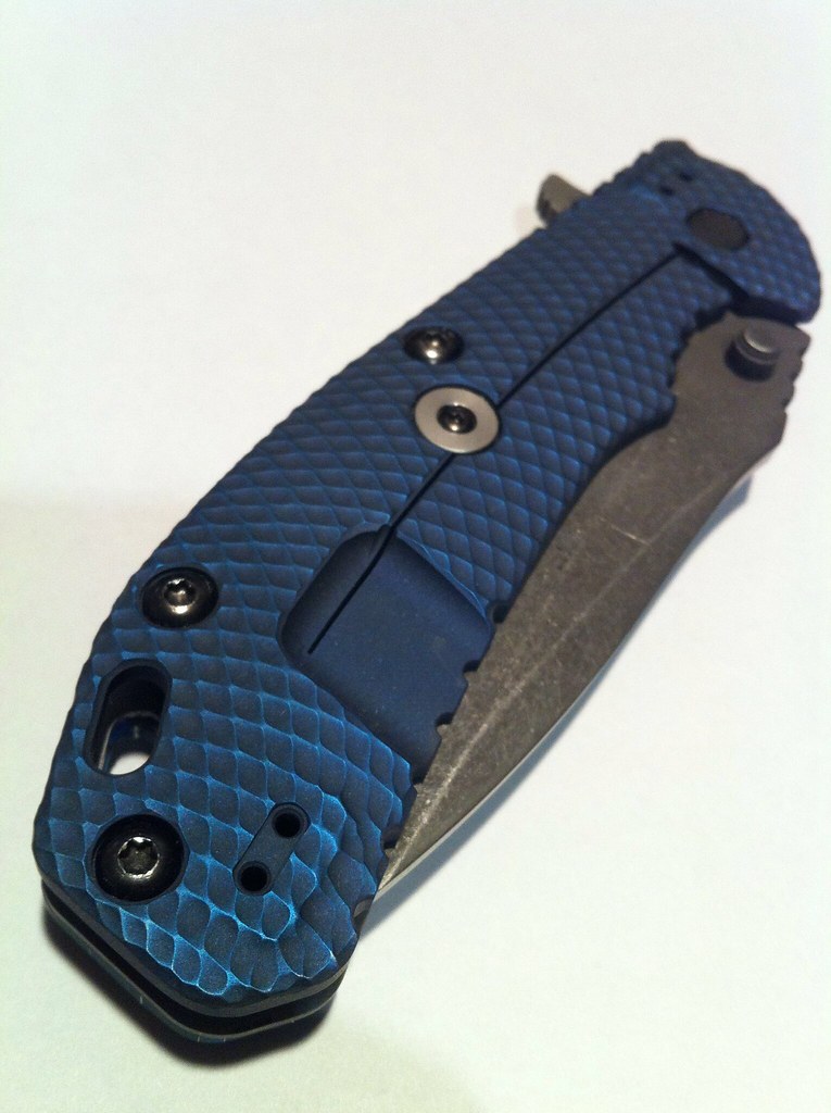

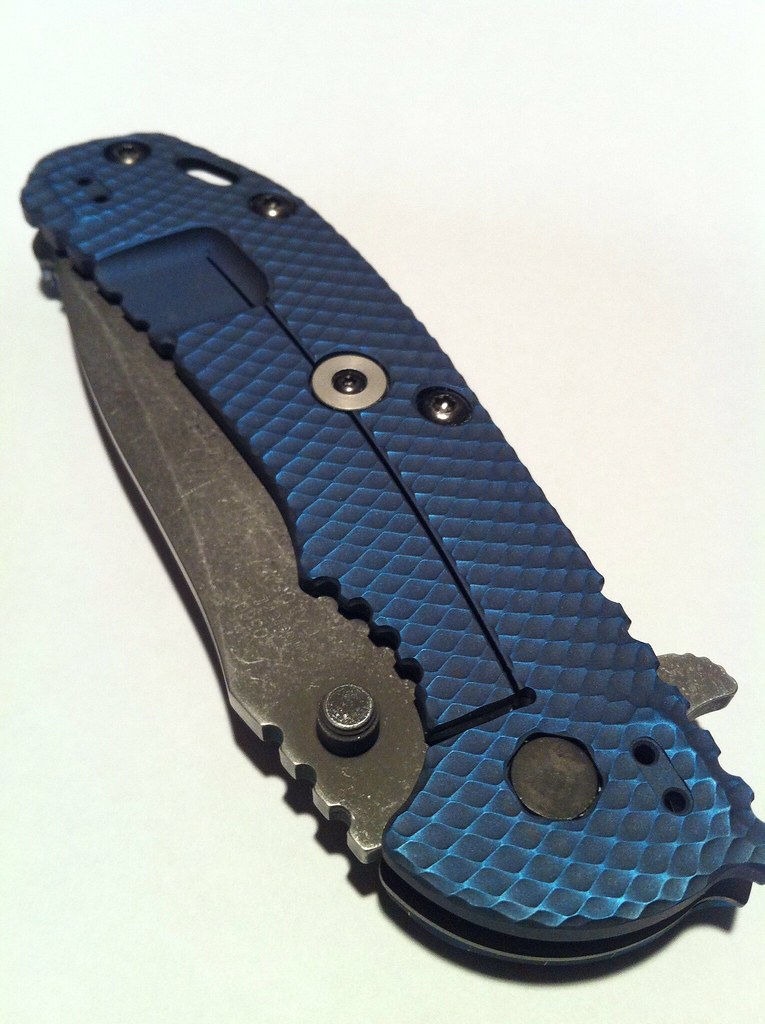

First post here! Thought I'd share my ZT. I heat anodized the frame with a butane torch and did an acid wash with mutriac acid. For some reason it took forever to darken, and even after 3 hours I couldn't reach the nice dark color seen in the above posts. Some tips would be appreciated! Anyhow, the ironwood scales are by Cuscadi.de and the tritium lantern is from TEC.

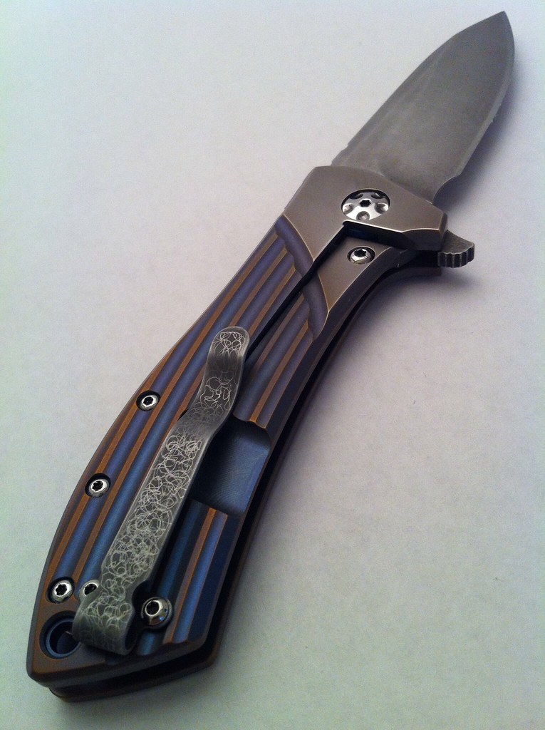

here is a nice tease, i'll post a full thread and video when its finished, making a blue twill scale to go with it:

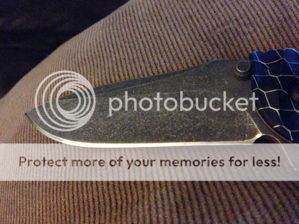

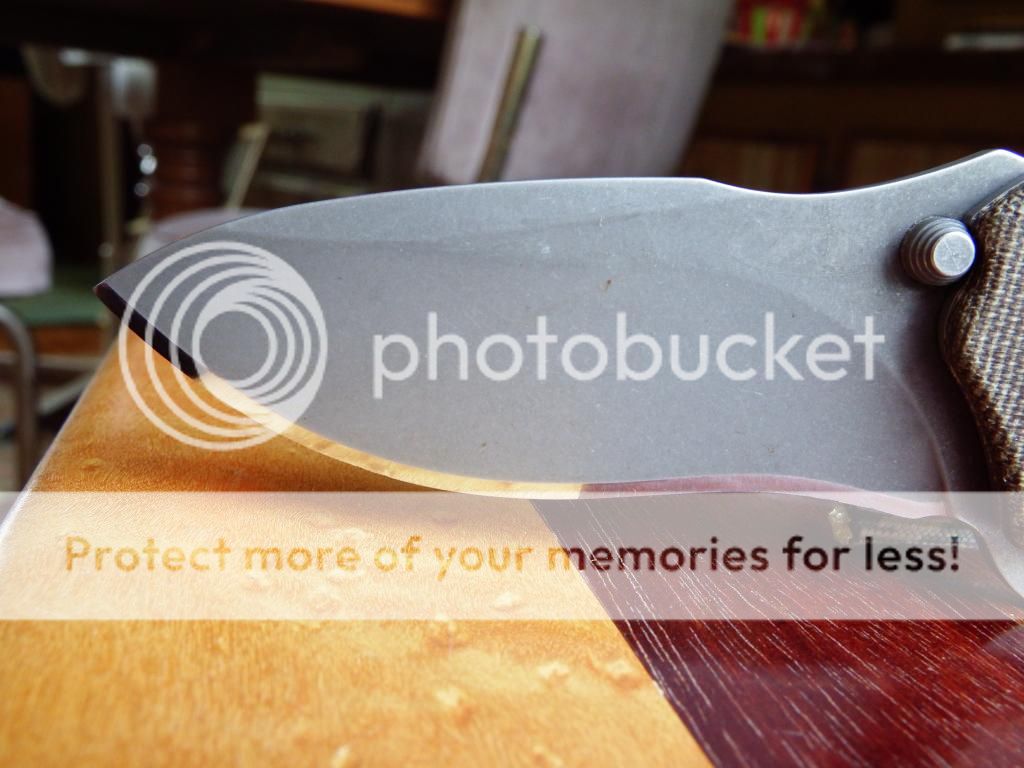

How would one achieve such a nice looking edge on my own ZT 0350
brplatz. That edge is from a good'ol Lanskey system, with a mix of standard and diamond stones, at 17 deg. per side.
Stropped on an old belt, with "White Rouge" rubbed on it.
I have stuck with the Lanskey , even with the many newer systems, as I am familiar with it, after 20+ years using it.
