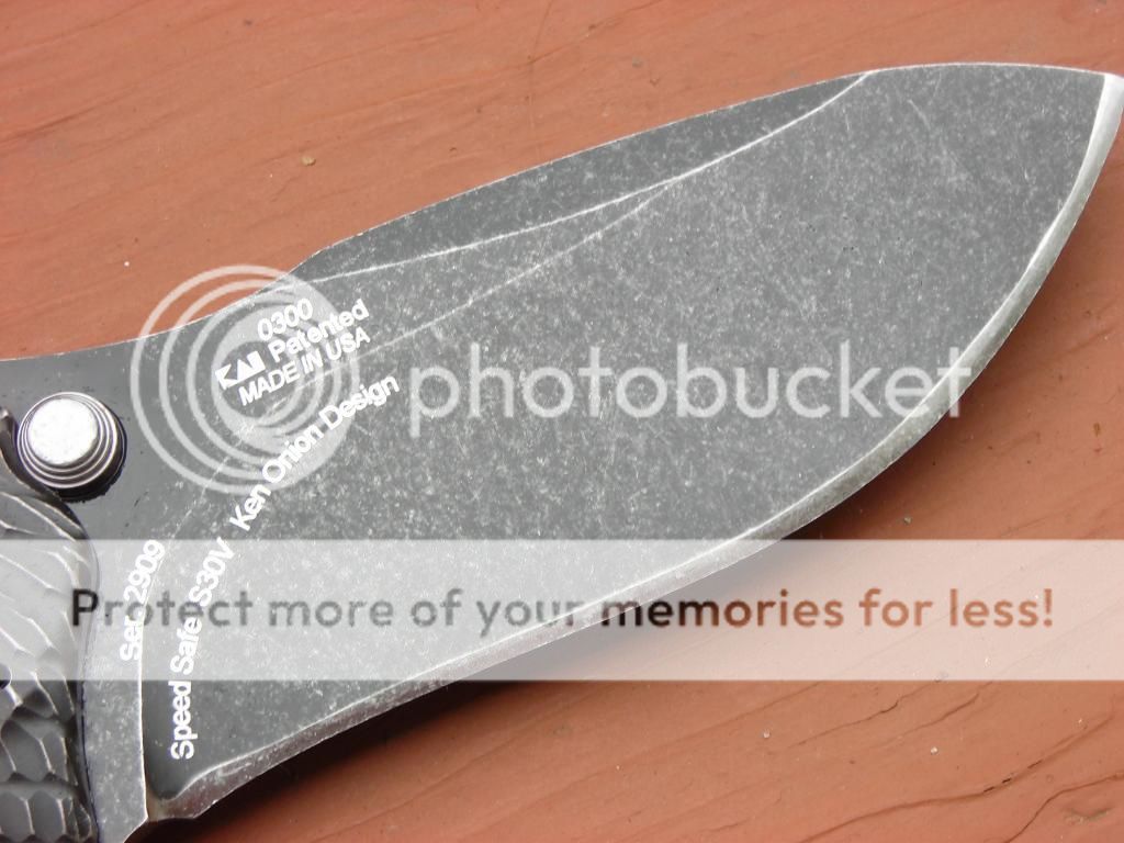

If you want to try it buy yourself a cheap tumbler. You can experiment with different shaped media to find which actualy gets the pattern you prefer. You can even do a similar effect to the black washing on non coated blades by doing an acid wash. Go to radioshack and get PCB etching solution. Mix some of it 50/50 with water and soak a non coated blade in the stuff. I prefer to heat the mixture so that it is almost steaming as it cuts a lot faster. This will give you a really dark finish on the blade and afterwards you can follow up with the tumbling. Acid washing wont take as long in the tumbler though. The only thing I would recommend doing is painting the area of the blade tang that the washers ride on with some nail polish before doing the acid etching. That way the acid wont eat into that area and your action will remain smooth. The stonewashing after the acid treatment wont effect the smoothness that much but a deep etch could. You can also use the nail polish on other parts of the blade as to be able to etch a pattern if you want.

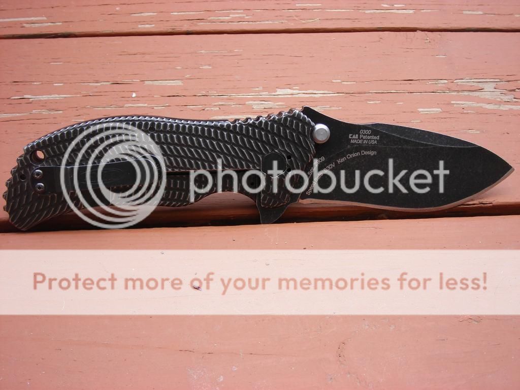

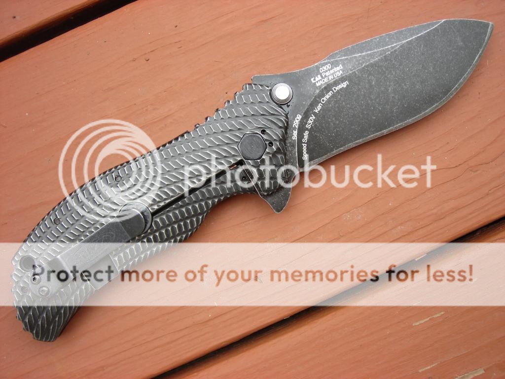

If someone finds a good way to reproduce the BW look be sure and post directions.
My 0300 would love look to like this.:)
My 0300 would love look like this.:)
All you need is a tumbler with ceramic media. You can buy a cheap machine and the media for around $75 from harbor freight tools and can do as many knives as you like. There are a few guys that ive seen that have a tumbler and charge anywhere between $25-50 to do a blade depending on if you do the tear down and reassembly.
Just looking at the Ti lock side I would say that good size flat stones were used. Any small or pointy media would have made that side look different. In the one video from Blade Jen said "we use synthetic stones" and "it took quite a bit of testing with different media to get the look we wanted". Or something along those lines. I'm about ready to try it with an old peanut butter jar and river rock in the drier with a bunch of towels.
Old peanut butter jar + river rock + drier. I didn't even wash the jar out just added a little water then the Ti and rock. 25 mins in the drier. Next I did the blade with a few smaller limestone rocks added to the other mix.
