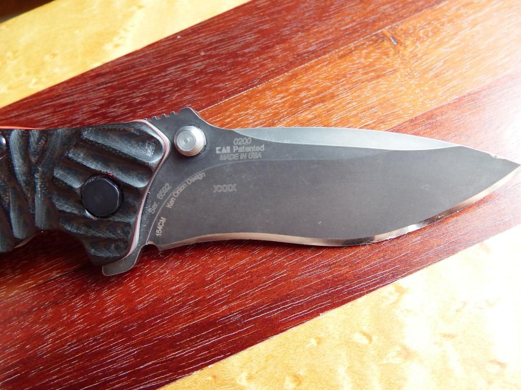

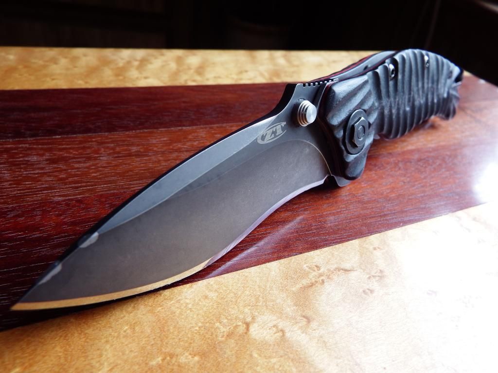

Here is a pic of my DLC 0200 blem, that I put the blade in my Lymon Turbo brass tumbler (vibrating as mentioned above).
I used crushed limestone gravel from my driveway, and water.
Left it in for 48 hrs!
Bigger stones should do the trick. Limestone is very soft, most likely softer than the DLC. Granite or quartz are going to be what you need. I put a few small pieces of limestone in with the 0300 and just turned into powder from the harder stones. Shards of hard tile should also work well.
According to Jen in Gavko's video interview from Blade, the blades of the knives are first DLC coated and then tumbled with synthetic rocks. she said it took awhile to get it right.
