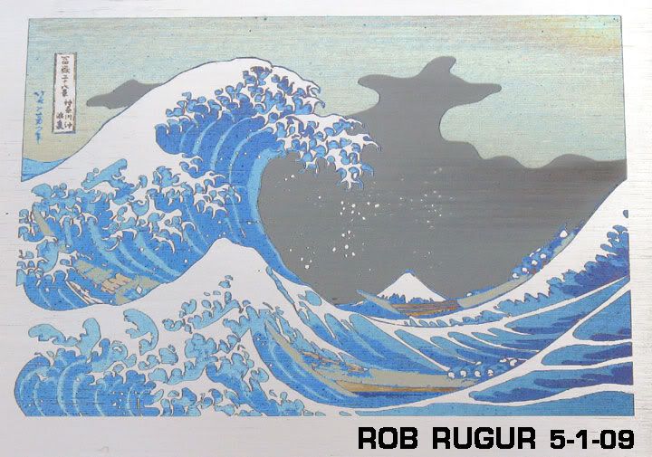

By the way, check out what a properly programmed laser can do to titanium.
I have never seen such intricacy on titanium.
Reproduction of "The Great Wave off Kanagawa" by Katsushika Hokusai c. 1829–32, Laser-anodized onto 6/4 titanium by Rob Rugur 5-1-09
Actual Size - 3.5" Wide
