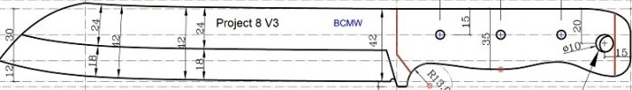

When I was chasing ht protocols that produce max hardness - for 1095 (steel src: aldo, aks) consistently yielded 68-68.5rc AQ and a few times 69rrc AQ. it did involved BCMW HT with grain refinement + super quench + cryo.
No, it gets higher AQ, its dependant on your thermal cycling and austenitizing along with cryogenics
1095 toughness: I found KnifeSteelNerds's toughness chart for carbon steels useful for conventional HT protocol but 1095 & O1 are need further study. O1 @ 58.5rc got 10 ft/lbs and 15ft/lbs, that is a 50% differences - hence more samples/data are needed... Of course, experiments aren't cheap, thereby thanks.
My conjecture (maybe based on common-sense or naive) - with metallurgically sound/consistent ht 1095 should has similar toughness as 52100. I got a request to make this knife in 8670 or 80CrV2 62-63rc edge differential to spine hardness.
Well, I chose to build with 1095 with expectation to has toughness similar or better than 52100, and edge retention better than 8670 & 80CrV2 at same hardness. Though, I will aim for 63-65rc hardness but will lower it need higher impact load. I also will make a longer 1095 chopper to test my yet-new protocol as well.
