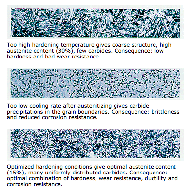

All good comments. I agree the contribution of powdered metallurgy and the refinement of grain size has really pushed the ability of higher alloy steels to be tougher, my only concern with regards to the increase in carbide volume is that it could create stress concentration for crack growth or fracture toughness. Crack growth starts with non-metallic inclusions, individual carbides and carbide clusters or (if they are present) at voids.
I mean the carbide clustering can be seen in CPM-154:
Compared to AEB-L
index.php
This is why I tend to question what is mentioned in "data sheets". Crack growth etc IMO is important for steels that would be used in fixed blades etc at thin geometry but we do not see values for fracture toughness. It could be because of the shear amount of different tests for fracture toughness measuring different aspects.
One of the main comments that started me in questioning "data sheets" was from Ed Schempp.
Ed Schempp said:
There is a tendency for CPM M4 to work harden in the very thin geometry of a knife blade. Blade sports competitors push the limits and some of these very thin blades work harden and fracture or crack after a year or two on competition, and are replaced. Personally I used 52100 clad with 15N 20 for several years, and the knife is still undamaged. For large blades I prefer high Carbon to stainless or high speed steel. I like to think that my blades will outlive me.
There are many special purpose steels that will give exceptional life with light cutting tasks. Many of these steels will be used and do well in folding knives, it depends on what you like in your knife.
The more I read the more I realise the less I know. :foot:
One thing i would put to you is that the crack initiation can start at a very small inclusion and what it needs to propagate is grain-boundaries (weak joints) to follow. In those images, CPM154 has larger carbides with grain-boundaries around each one - a less-linear path for a crack to follow; and there is much greater distance between carbides making it much harder for a crack to jump across (actually proceed through) the tougher tempered-martensite/austenite to the next weak-joint around the next carbide. For the AEB-L, the path from carbide to carbide may be more linear with less matrix between. Using these slightly larger carbides in the midst of larger distances between may actually give the slightly higher-carbide volume CPM steel slightly greater fracture toughness than the lower carbide AEB-L though the difference might not be noticeable in actual use where threshold stresses are likely to be unreached or exceeded for both. But for ingot high-carbide steel, the larger carbide aggregates provide a path yet more linear with less matrix between than the lower-carbide AEB-L (or 420HC) hence the increased toughness over steels like 154CM and 440C. Using PM you get very high-carbide (high-wear) steels with toughness levels comparable to low-carbide (low-wear) ingot.
Here is a chart relating to fracture toughness in cemented carbide (<30% matrix WC-Co) that helps illustrate fracture toughness with regard to matrix volume and carbide size, specifically looking at the differences in toughness at 85% carbide between "submicron" vs "medium" and "coarse" carbide material. There are some excellent papers on the toughness of cemented carbide detailing how fracture-toughness relates to the ease with which a crack can follow a path through the material.
Again, Crucible suggests in its data sheets that the difference in longitudinal impact toughness between 440C (22J @58Rc) and S35VN (38J @58Rc?) may not be all that noticeable (or the values have a large range of deviation) so they push transverse impact toughness instead, and Sandvik won't even release notched impact toughness values for what they peddle. Based on the data from cemented carbides, I am suspicious that fracture-toughness values would be even closer, i.e. harder to differentiate steels that are between 4% and 24% carbide rather than only 4% to 24% matrix as is the case for cemented carbide - there is just so much more matrix in knife steel to absorb fracture energy, it is likely not a very good way differentiate between them for this purpose. *shrug*
