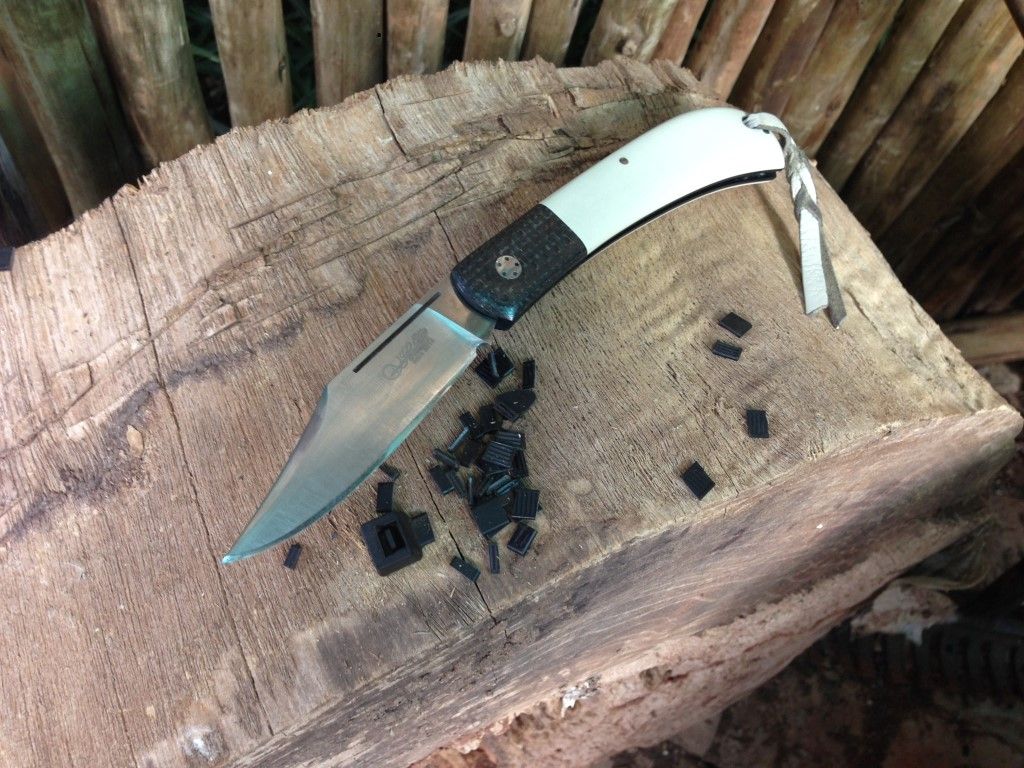

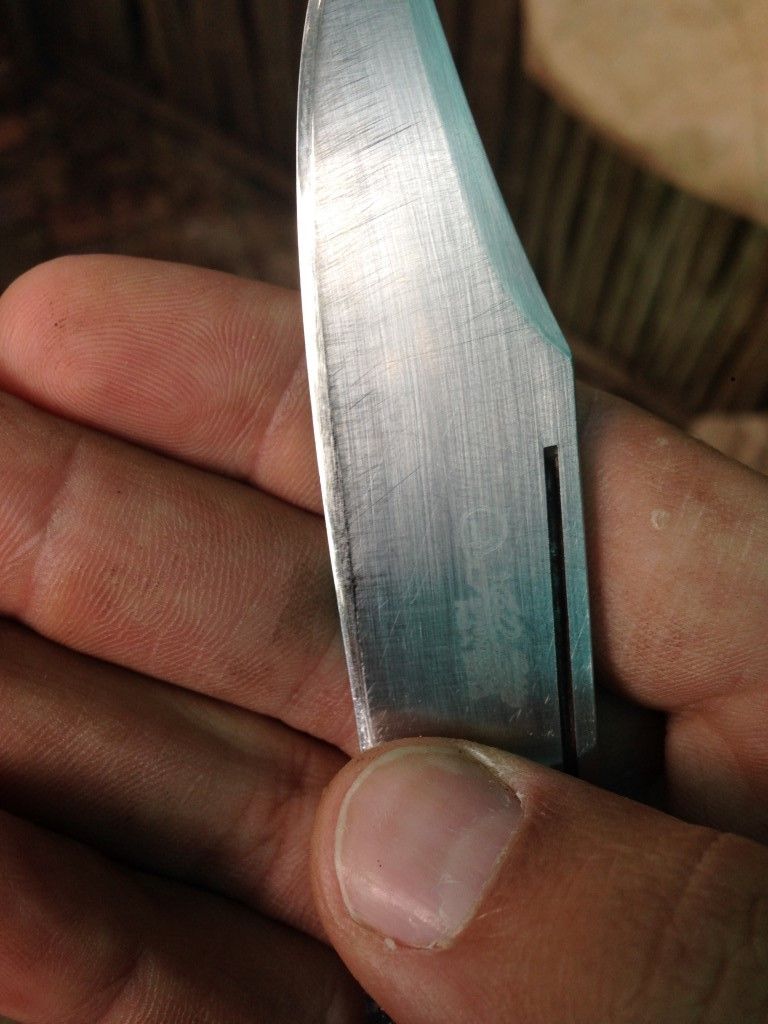

For those who might be interested I have something for them to try, not for the faint at heart though.
They will need some leather gloves, good heavy ones are best.
1) Good down to the local hardware store and pick up some 175# heavy duty zip ties, they are cheap, pack of 10 18" ones for around $7 or so, the flat ones.
2) Get you a nice piece of wood to cut on, you will need it.
3) Put the zip tie on the wood flat and take that knife (whatever knife) and try and cut through the zip tie, your going to have to push cut through it. This is were the gloves come in because you will need to put your palm on the spine of the blade to make the cut and it's going to take a lot of pressure to do it.
Started off with a video but ran out of memory.
Knife is a custom JD Ellis Lannys Clip out of 14C28N.
[video=youtube;zZABrO0KPMY]https://www.youtube.com/watch?v=zZABrO0KPMY&feature=youtu.be[/video]
Here is a picture of the knife and edge afterwards. Still able to cut phone book paper with no hang ups.
Now what?
