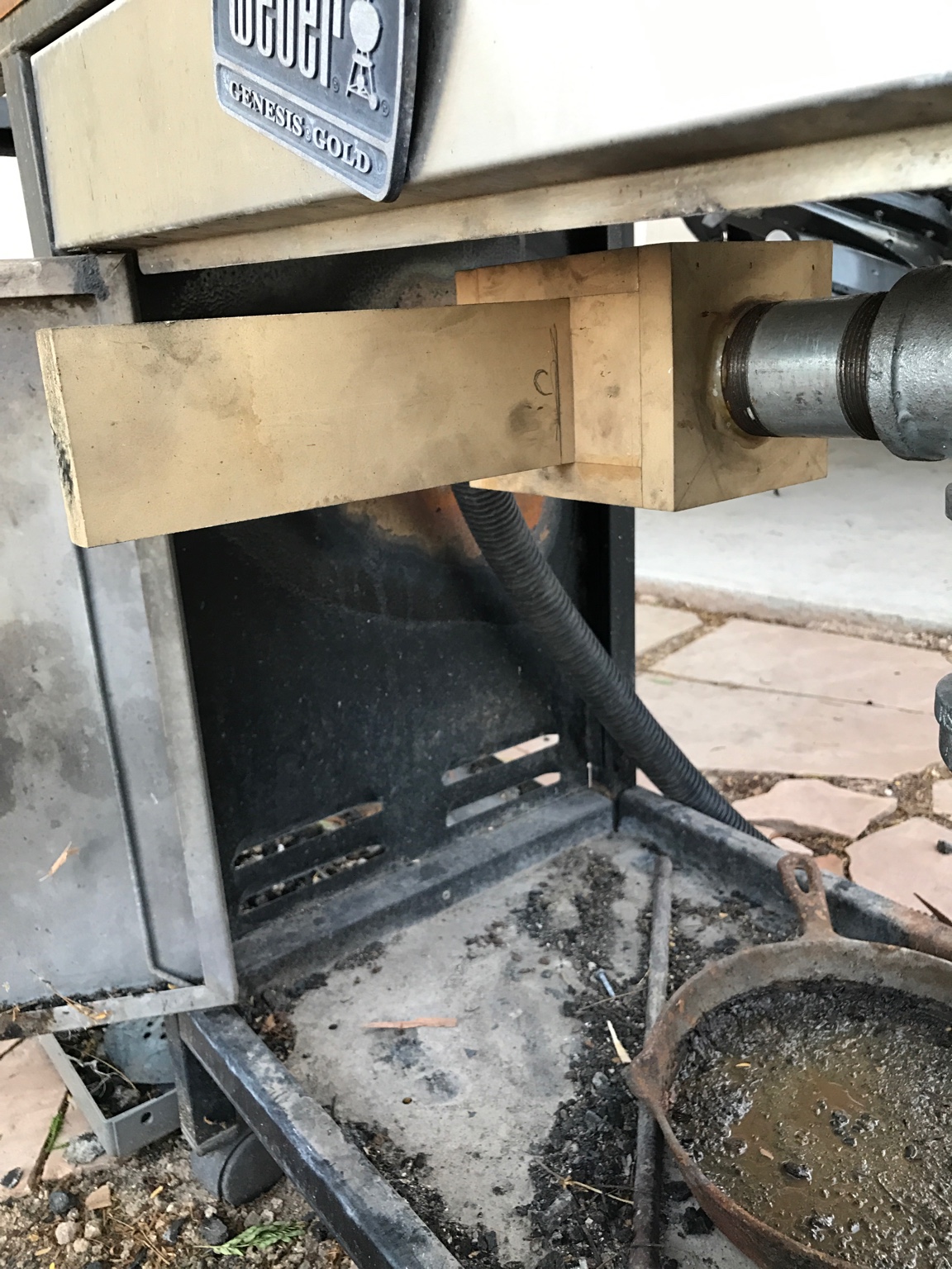

I just started forging and built a brake drum forge that's powered with a shop vac. Needed a damper for the air flow so I came up with this for free!
3/4" MDF box built with a piece of MDF that slides in and out to slow the air once the coals are where I want them!
