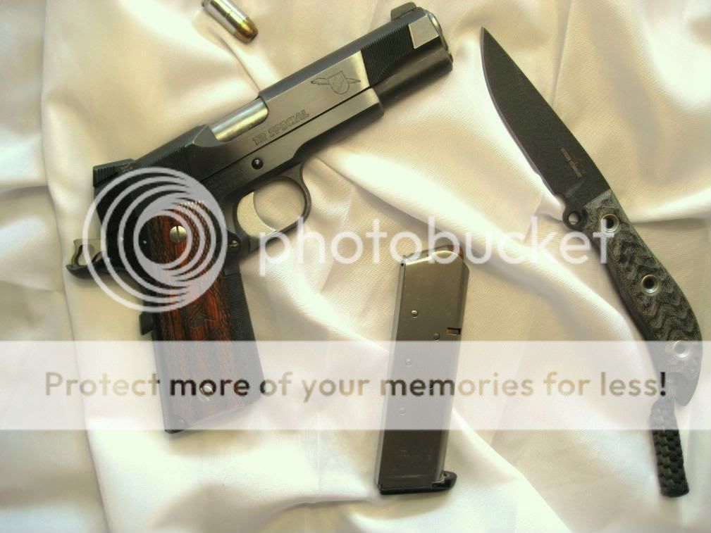

Here's my well-used Baer. TRS with Brown BT and grip reduction, thin Alumagrips, King's Ambi., 3.25# trigger, Parked. Replaced the front night site with Novak white outline N.S.
Fits my hand like a glove.
